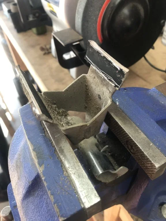

The left hand tang on this one was breaking away at the bottom , so a bit of gorilla glue sorted it and if held when the metal clip was clipped back on.
and the broken lug also got gorilla’d.
As you can see one of the other fixing lugs was also mullered:eek:
So found some black plastic , a dob of the old ‘ Monkey Jizz’ and it will just need a new hole drilled now=))
