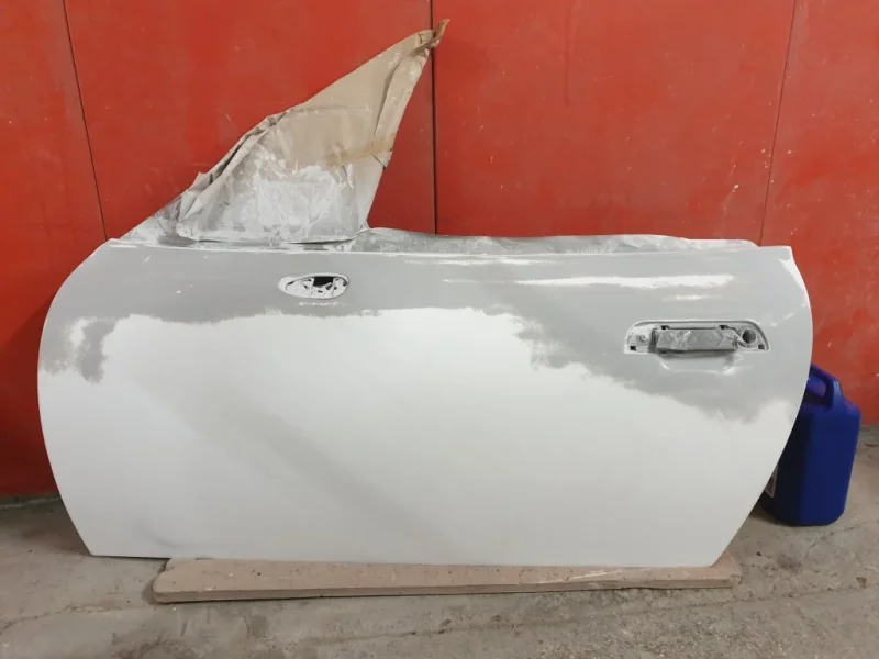

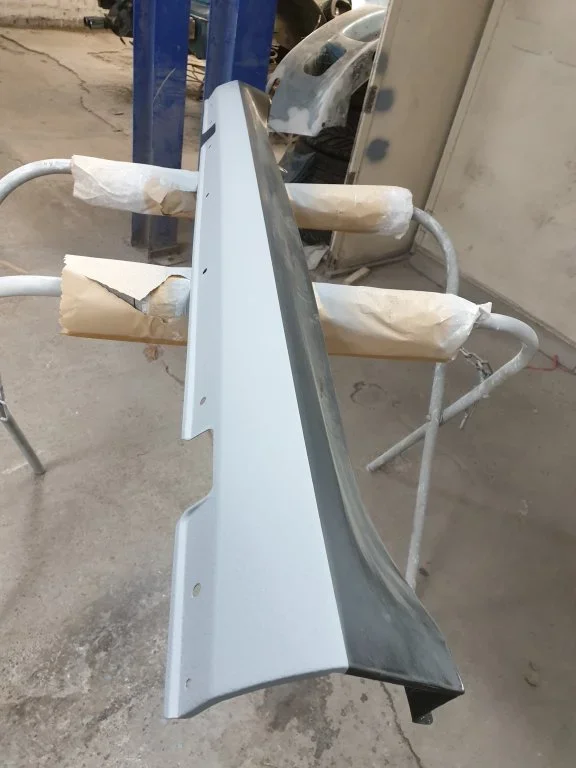

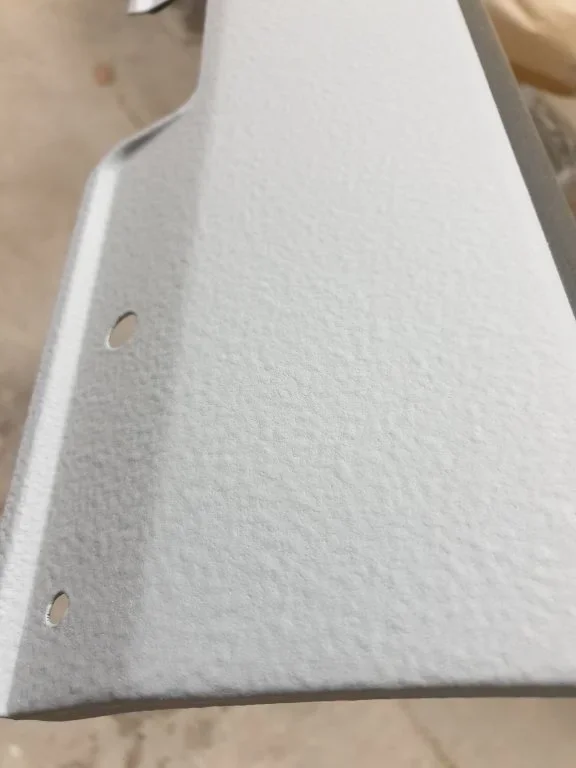

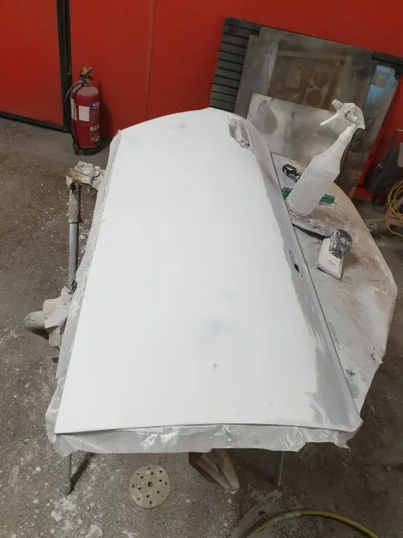

Got both doors flatted and almost ready to paint, also got the stone guard on the new sill,
