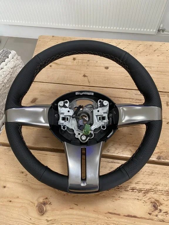

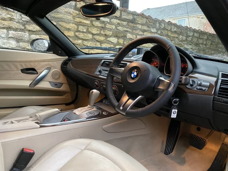

Fitted the Mewant steering wheel cover- fairly happy with it...

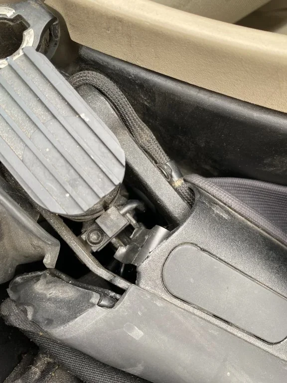

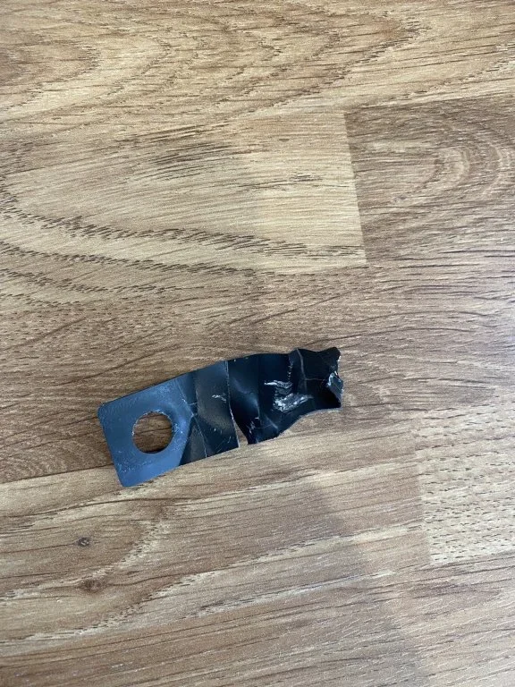

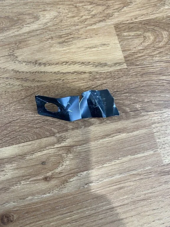

Also I noticed this earlier and it doesn't look right, someone has had the cover off and I am not sure what that bent piece of metal is?
Which side of the car is that Stuart? I’ll go have a look.
Is that a position sensor, there isn't one on the driver's side .
Probably- I think from memory there are two or three in that area
just can’t see what the metal is
ive taken it off will take a pic
Can't see any "extra" bits on my car mate. Does removing that long oval plug show any more?
Here is the metal
it was under the plastic blanking plate with two t40 bolts under
That has certainly been through the ringer by the looks of it mate. No idea what it is or does, maybe RealOEM might show it?

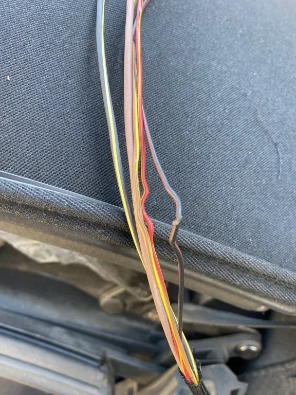

Had a half hour tinker
Got the inner roof lining off and had a good look at the loom up to the claw motors, look and feel OK with no kinks

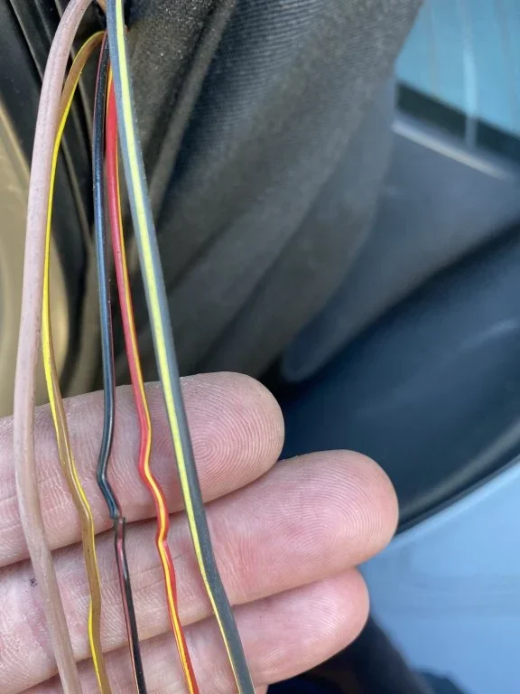

Where the loom heads down to the base of the roof on the passenger side, I wasn't happy with the kink in the cabling shown here: had a play and nothing immediate raised its head
However, I got the roof to cycle up and down a few times. When it did stop 75% of the way up, if I pushed back on it, it restarted the motor. I'm thinking there is a break in the wiring between where I can see either side of where I have checked...
More faffing this afternoon- there is deffo a wire nip/break somewhere in that area
Will plan to strip it back at the weekend from the claw tops to that passenger door shut, see what we can find

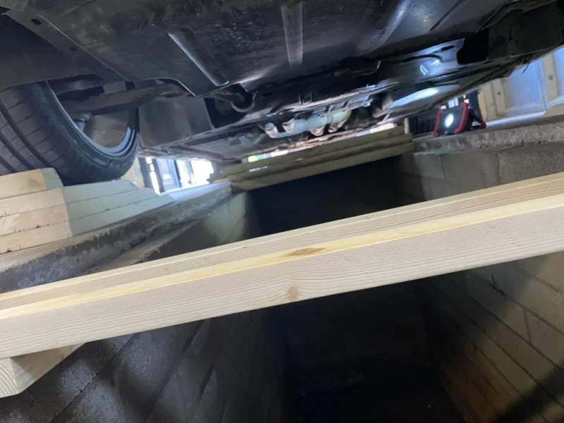

Used Tonys pit and changed the auto gearbox fluid and filter- which has made a big difference to shift speed and responsiveness. The old fluid came out thin as water and in a bad state- interesting to see the metal paste on the magnets in the pan!

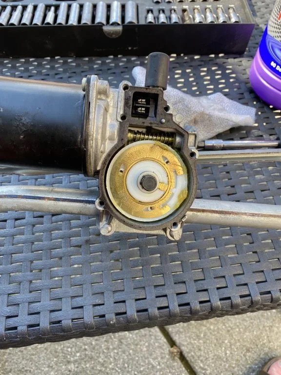

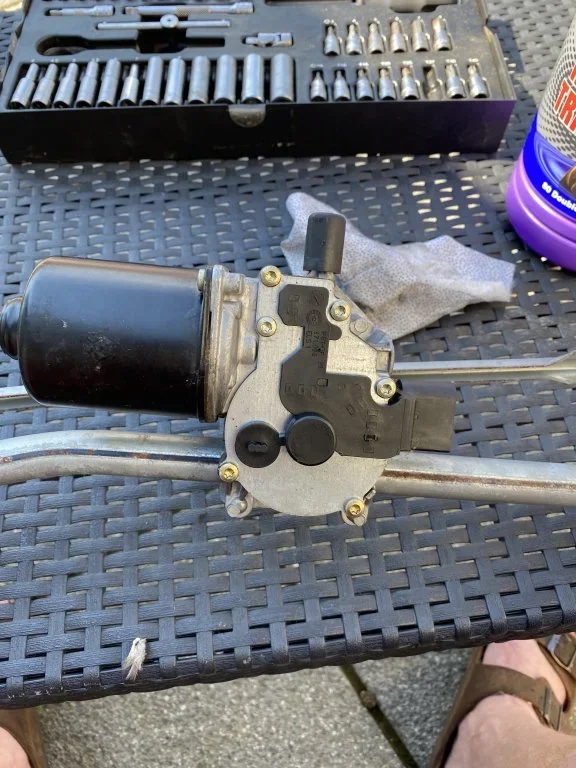

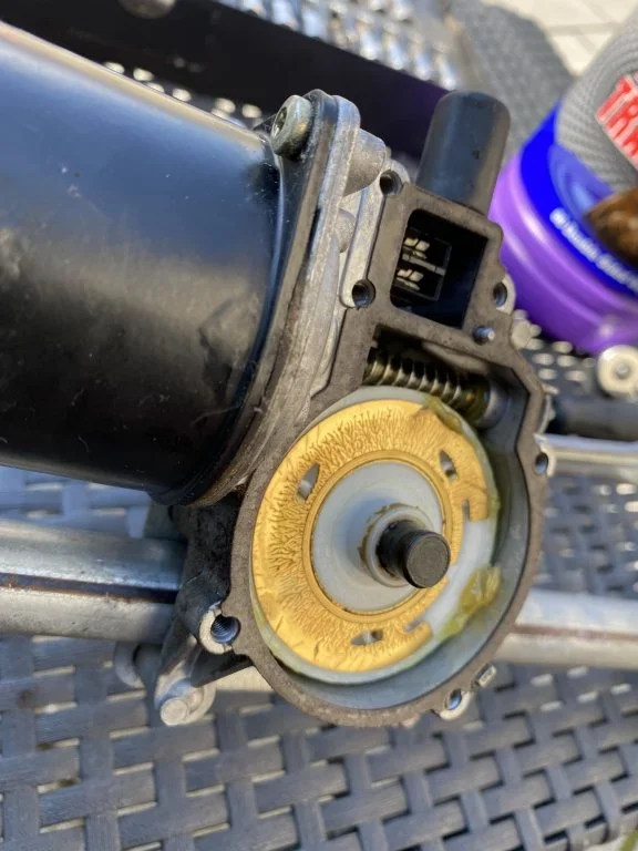

Used Tonys puller to pop the windscreen wipers off which came off with a crack- once home I stripped the wiper motor to stop the non-parking issue and clean the crud out of the scuttle!

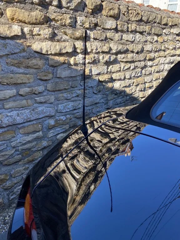

Today was for the purists
fitted the 3.0i badges (not sure if it came debadged or someone had taken off in the past) and refitted the whippy
Sorry not sorry- wasn’t feeling the stubby

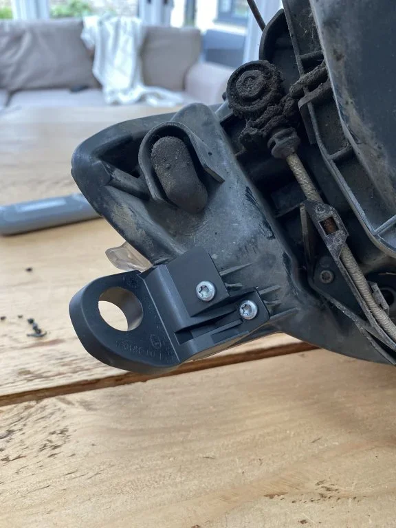

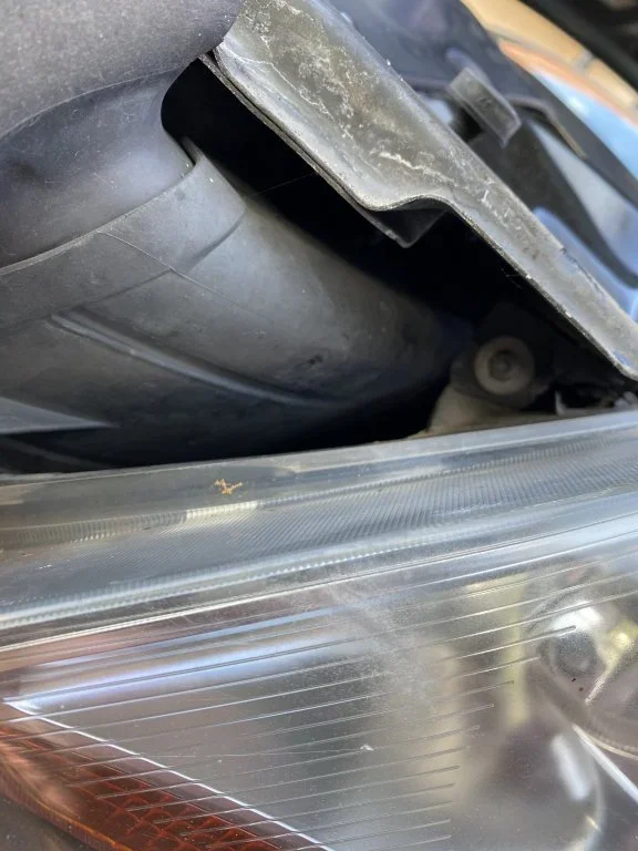

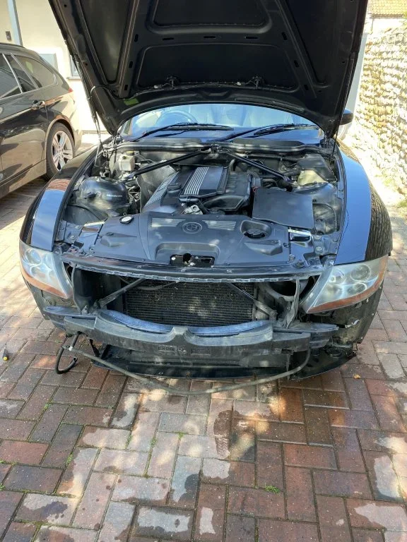

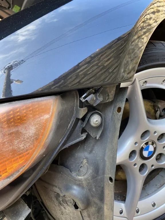

started by taking the front bumper off to see the reason for the wobbly near side lamp unit. Two broken clips: not a problem… pop the repair kit out only to find I have the WRONG side needed.
Not to be defeated I popped both headlights out and gave both another polish and lacquer coat- put to one side ready for Sopers to open tomorrow!
sorted the lacquer peel around the headlamp washer jets
while it had emptied itself and inspired by Mark Plant I took off and cleaned my water bottle which stank to high heaven, plus the filters looked like they’d been in a pond.
with a good wind behind me I decided to find the wire fault in the roof that was causing the intermittent issue. Tracked and traced it after dropping the headlining and found a small part wire break. Fixed by splicing, soldering, heat shrinking and re armouring cable. Once all back together I fitted my gaptech!
Job done!!

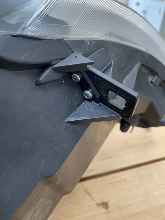

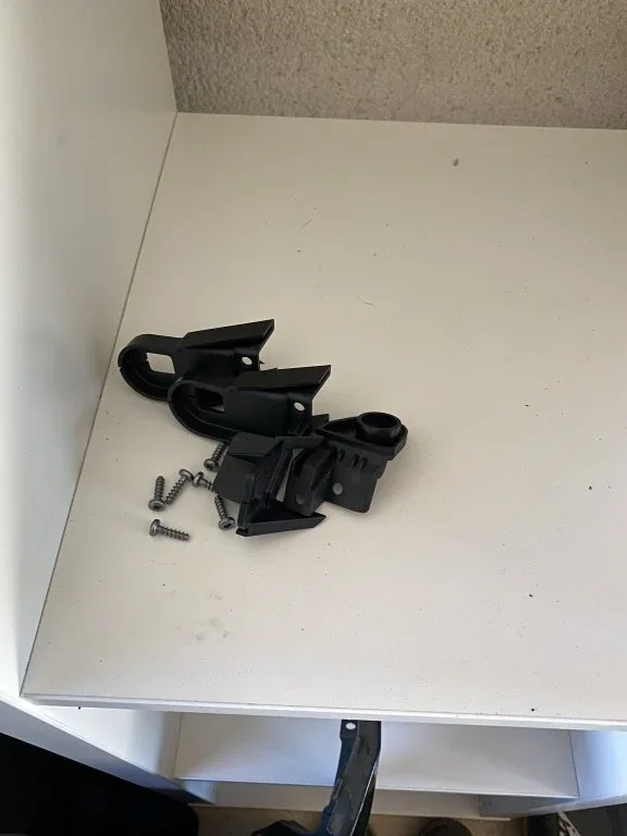

the correct side headlight repair kit came
two broken lugs repaired
front of car put back together!
only thing I need is a new o-ring on the headlight washers but that’s a wrap!
