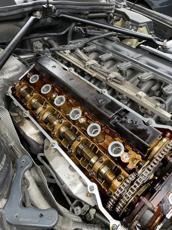

started to remove the vanos
got as far as getting the top cover off- deffo found the source of the oil leak dripping onto the exhaust, the gasket broke up in my fingers
a good evenings work

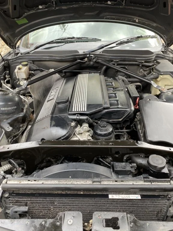

Get out!

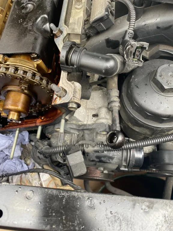

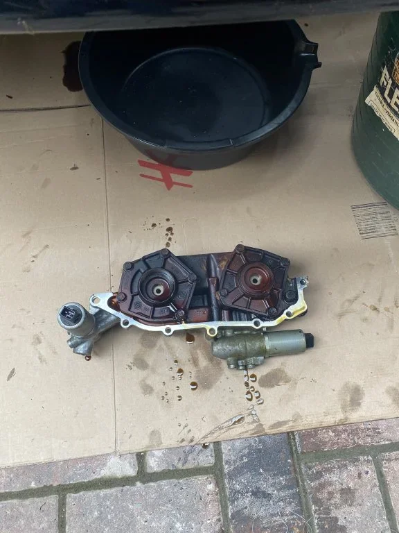

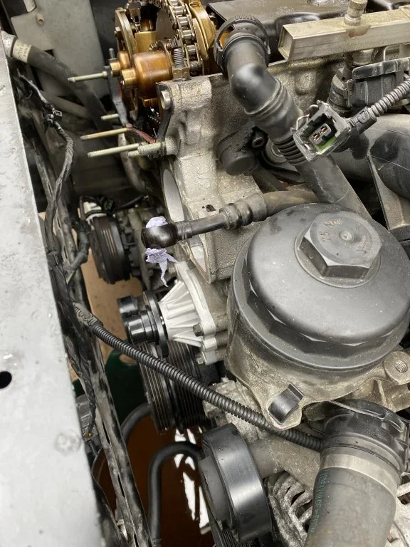

Vanos off
Water pump off
Thermostat off

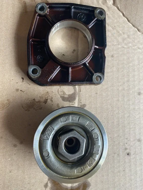

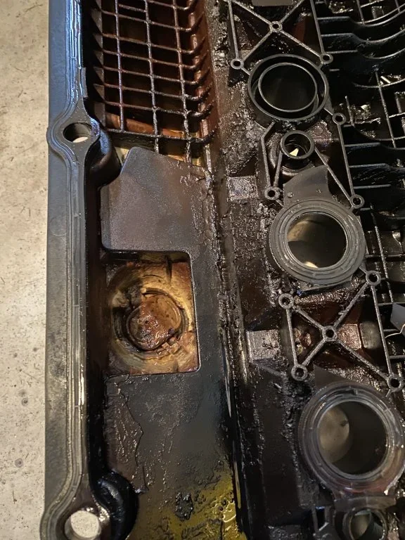

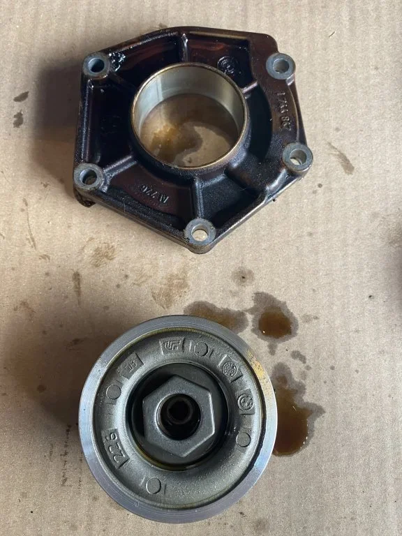

Vanos opened up and wow- anyone in doubt of whether this job is worth it or not…
The crud around the vanos pistons was unreal- the gaskets around the valve cover were like glass and the seating of the pistons was so sloppy
that’s the second vanos I’ve done that needed minimal persuasion to come out of situ- tilt and remove!
Off to get the bearings undone now- off to T-Tony’s!!!!

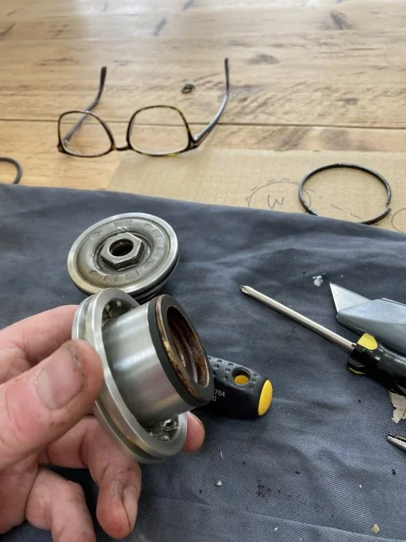

This afternoon:
Opened the vanos up
Seals were pooped!

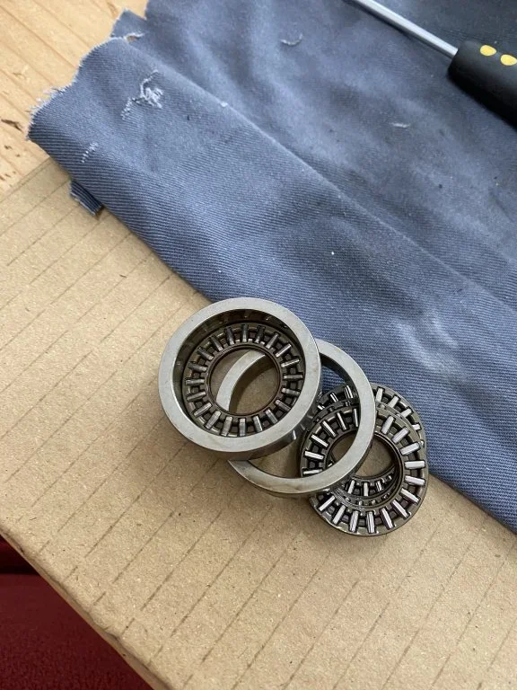

I popped over to T-Tony @t-tony who let me use his vice and impact wrench (lovely to meet you buddy- thanks again!!!)
That allowed me to replace the needle bearings and change the rattle rings- I didn’t do this on the 2.2 but saw this as a preventative on the bigger engine- I also recall seeing it being more prevalent on the 3.0
Home- old cylinder seals off and new ones on- rebuilt the vanos

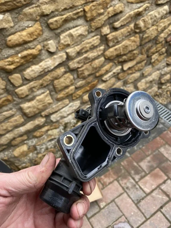

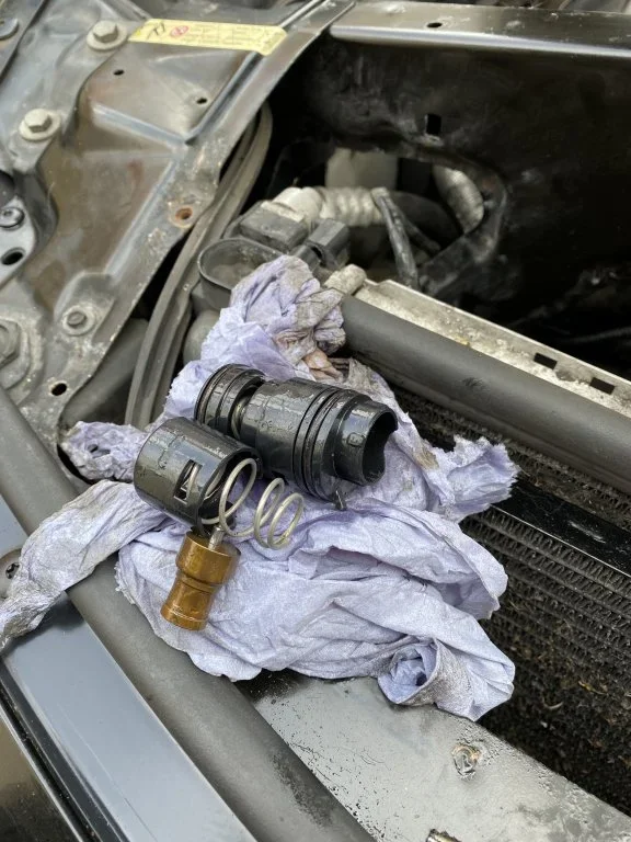

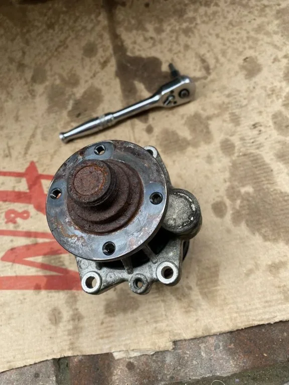

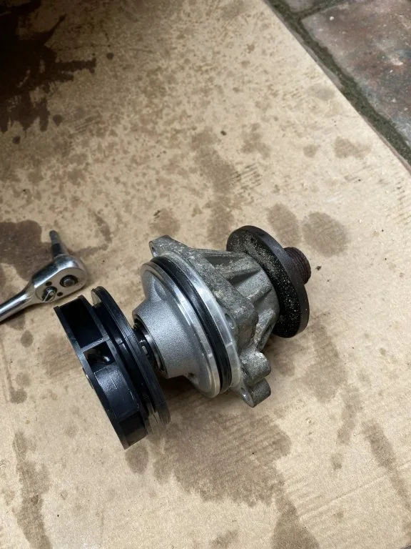

Then popped the ns engine bolt off, new pump and thermostat on. This surprised me- the pump was the original from 2003 (as the car had only done 66k that’s not unusual I suppose) as the impeller was plastic???
Replaced with a metal impeller pump
Vanos back on, those t30’s slowed me a bit due to that damn cross member

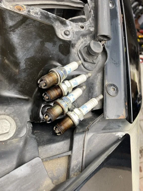

New gaskets all round, rocker cover back on after fitting new sparks- the old ones looked fairly good

Finish cooling system with expansion tank and bleed
Oil and filter change
I’ll let you know if it runs!!!

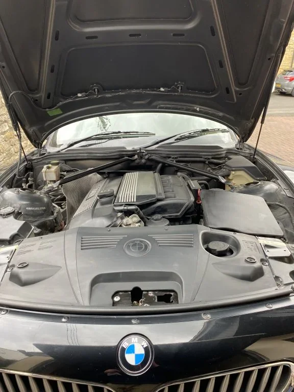

With most of the vanos work done yesterday, today was all about tidy up, check and a few small bits
Expansion tank- was looking tired, needed doing, I took advice from Enuff Zed who said when he did his, the oil thermostat under it pinged off- which mine predictably did the same! Cheers Martin.
All sorted.
Refilled coolant, checked everything again... put airbox etc back
and started it: ran a bit lumpy but settled quickly and- thats a wrap!
Gave it a blast once i was sure there were no leaks etc; much much better- runs smoothly instead of a grumpy idle before. No oil leaks etc.
Had a few mins left in the day to do the front and rear brake pad wear sensors I'd forgotten to do, checked all the fuses which I'd been meaning to do and reinstalled the boot strip light I ripped off when IN the boot doing the roof motor relocate
