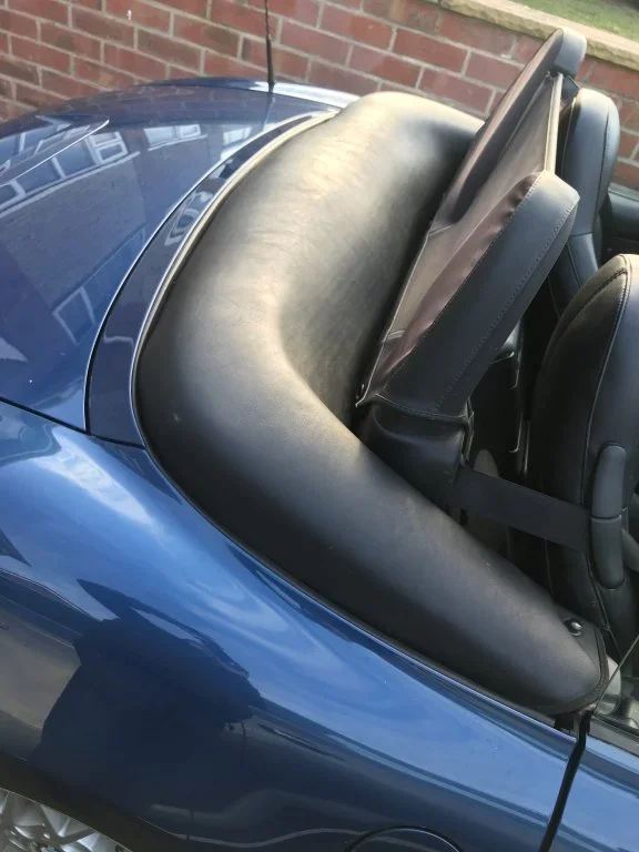

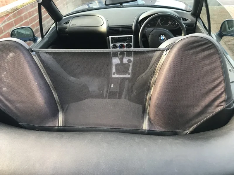

What I did get sorted is a tonneau cover for the hood and a fabric mesh wind deflector both genuine BMW items. the wind deflector has faded slightly so I have ordered some black spray on dye to freshen it up. Apparently these wind deflectors are like hens teeth.
This means that the Perspex wind deflector is surplus to requirements. Now Sold
Funny that. I have one of them in my car, but they don't seem to be particularly effective, and darken the rear view considerably. I was even thinking about ditching them.
Which leads me to this question: do people find wind deflectors useful? My Spit doesn't have one and I never felt like wind turbulence was an issue.
I rate the oem mesh screen. On chilly evenings with the top down it makes a big difference, but then when it’s warmer and you’re not worried about your hairdo, you can unzip it and let it hang, but it’s still blocking air on the hoops. If you have a manual roof, you can then close the roof without getting out, as long as you still have full range of movement in your neck and shoulders. Of course, if you’re protecting your rear screen with a piece of fleece, you still need to get out and retrieve that before it blows away.

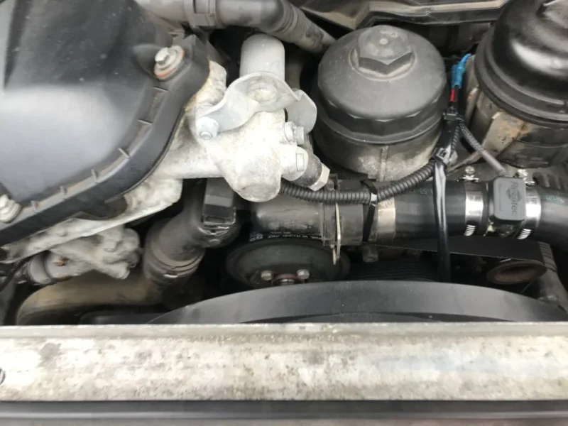

Looking good with the jobs you have done, use some plastic split conduit to put those wires in to make it look better.
Loads on ebay.

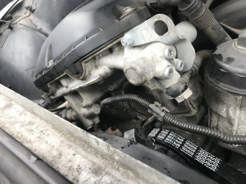

Yeah, I've still to fully tidy em up after I have wired the in line 10amp fuse, a job for today along with two drive belts, flushing and changing the coolant
Griff
That's the in line fuse for the electric fan fitted.

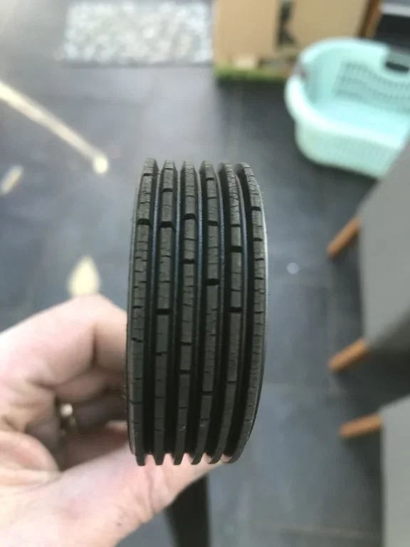

Changed over both serpentine poly v drive belts, access was somewhat awkward but I suspect easier now the belt driven fan is no longer in place. The smaller a/c belt was fine only one tiny split on the inside, had miles n miles left in it. The main drive belt however had thousands of tiny splits. As a matter of course I changed them both, the smaller one has to come off anyroadup to get the bigger one off

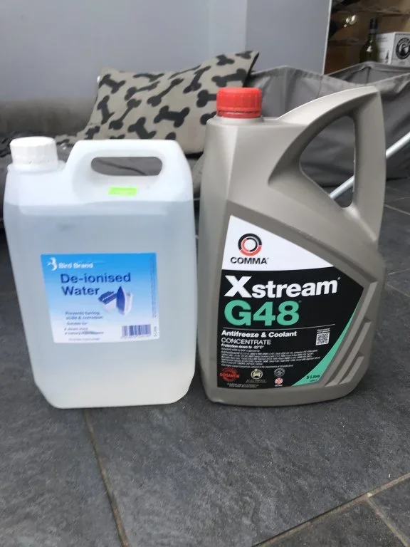

I couldn't flush the cooling system and replace the coolant because like a proper twerp I have forgotten to purchase some deionised water so that'll have to wait for another weekend. I did however have the forethought to purchase a new thermostat gasket. Now I'm thinking seeing as I intend removing the thermostat housing as part of the flushing process I might as well renew the thermostat as I have no idea how long the present one has been installed. Another trip to BMW dealers this week then.

Today I picked up 5 x Ltrs of deionised water for only £1:99 - Bargain

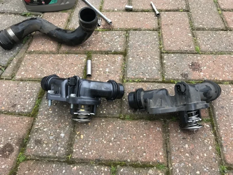

What was far from a bargain was the price of a new thermostat from the BMW dealership £98:00 + vat! WOW.
Or as we say up here in Gods Country - HOW MUCH? !!!!
I asked the sales guy were they made out of platinum? Apparently as it turns out BMW will not sell you a thermostat, nope, its the whole housing as well (Including gasket) That was a shocker. Anyroadup I've had to order it as I'm flushing out the system hopefully this weekend and will renew the thermostat as a matter of course along with new coolant
I asked him to price me a replacement block drain plug - He couldn't find it on the system which tells me there isn't one. At least I now know, which was my aim in asking for one
£98+Vat for the thermostat and housing - Can't get my breath
Griff

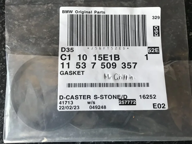

There are after market ones for a much more realistic price than that Griff. They all come as a complete housing with thermostat and temp. switch. I only really needed the rubber "O" ring gasket but had to buy the whole thing.
Hi Tony - I suspected half as much. I did look at various suppliers in Ebay, after about the twentieth 'This part will not fit your vehicle' notification I gave up. I collect the genuine part from the Bmw dealership this Thursday and will just bite the bullet
Griff
Collected the new carbon fibre thermostat housing with platinum thermostat earlier this week. ;)

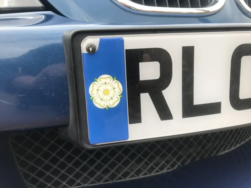

I did get the Gods Country Rose 3D gel self adhesive number plate badges put on. The front one looks worse than crap due to the fixing screw location. Now of course I need a new set of plates - self adhesive ones. It seems like everytime I get an upgrade / farkle sorted, there is another un to add to the list :rolleyes: I'll soon have gone over the £1k mark spent on that blooming list.
The Gods Country number plate badges. For those of you that reside in Yorkshire, hail from Yorkshire (Or wish you did :D ) then I have a few pairs available. I searched around online for an age trying to find some, failed so had to do a minimum order and get some made up. 'Er indoors stated I must not put any on her Q5 (She is a Jock-ess) I put a pair on months ago now, she still hasn't noticed them or is giving them a damn fine ignoring too

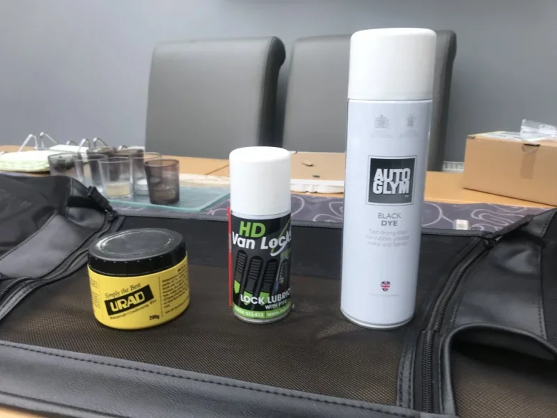

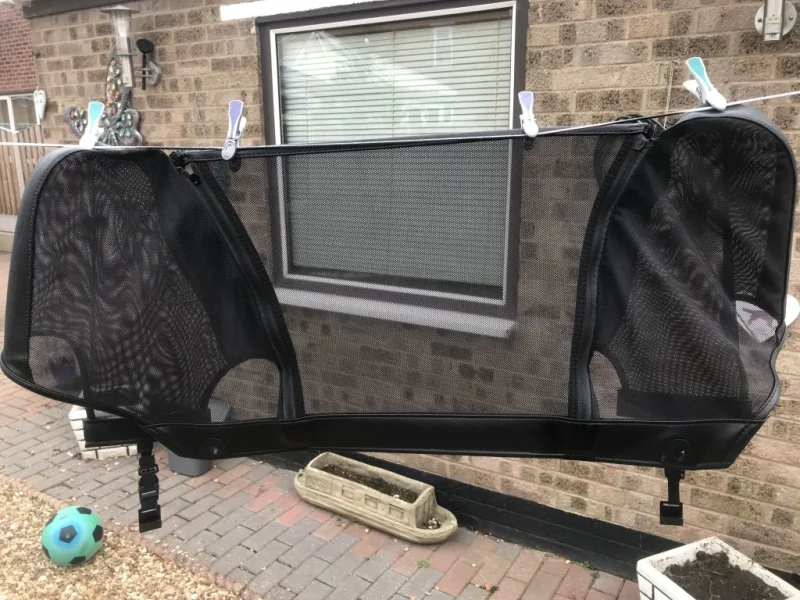

That fabric / leather wind deflector. Being aware of just how old this item may be I hand washed it gently which worked as the washing water greyed somewhat then hung it outside to dry naturally. Applied the spray black dye, left that to dry (Its fast drying) then applied some leather care, then finally lubricated the two zips, job done and looks a gudden. No longer does it look dark grey, we are back to black. well chuffed

The cooling system.
With the huge belt driven fan no longer resident and getting in the way of just about everything, this job was much easier. Removed top and bottom hoses from the rad, removed thermostat housing, remove three hoses from the expansion tank, expansion tank into the kitchen sink for a proper hot wash inside and outside. Hosepipe - Years ago I installed a hot outside tap next to the cold one for garden / outside use. With the temperature dropping by the hour a hot hosepipe pressure wash was called for, I flushed everything from both directions making sure the heater control was set to hot (Open) used gallons of hot water. I was pleasantly surprised that no gunk came out just the old coolant that was discolouring the water. The four bolts that secure the thermostat housing all seemed brand new apart from one. and that was only slightly discoloured, a wire brush sorted that out then applied coppa ease to all the bolts
Fitted the new thermostat/housing and all hoses, back in with the expansion tank. Then in with the new coolant, fired her up, bled the system. Took my MrsG out for Sunday dinner to a pub in Wadworth in Zebedee for a coolant systems test - All to the good.

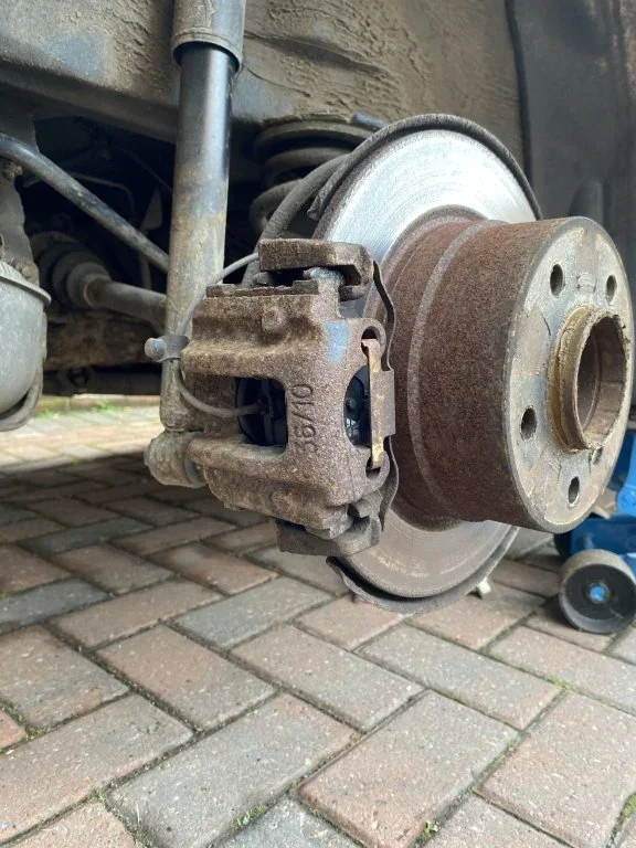

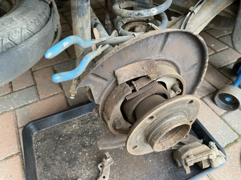

My aim was to strip down the back brakes ready for cleaning / painting, changing over the pistons, seals, and dust seals. Pair of axle stands to the fore and into it. Strip down successful, after remembering to back off the handbrake shoes at the handbrake lever (Fiddly) so I could get the disc-over-drums off for an inspection, just as well coz part of the friction material came away from the frame on the offside - Photo. This means a new set of shoes along with spring & retainers etc for both sides (Ordered - £38 via fleabay). It also means that I'm now gonna have to strip both sides down fully, clean / paint grease and replace. It makes sense to of course whilst everything is off.
Next stop, round to a mates to get the items cleaned up in his aluminium blasting cabinet
Griff

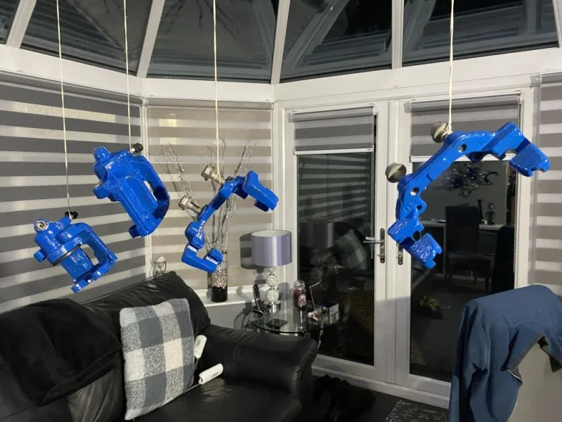

The blasting cleaning was a longer job than I expected but all done and to the good.
The inside of the drums had a tiny lip around each one - We machined that off and cleaned them up inside and out. The pistons were removed along with their seals and dust covers, new items installed along with new bleed nipples. I have new retaining springs ready when reassembly takes place. Degreased the lot with aerosol brake cleaner from the brake fluid used to assist seating the seals and rubbers into place.
Then high temperature paint, 1st coat applied in our conservatory (Warmer), Cincnavhome was ok with this with only a small comment - Probably coz I presented her with a Sunday evening meal. The second and final coat will be applied tomorrow evening. I had thought of painting the back plates with black hamerite, but it seems I ordered way too much brake paint, so I can use that instead, not that it'll ever be seen much. The brake pads are in fine fettle with plenty of meat available

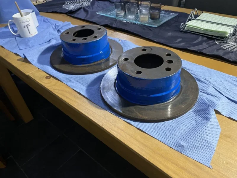

I had to finish work early today to attend a midday funeral, which meant I got home earlier than normal. This gave me the opportunity to strip off the handbrake shoes from the backplates, wire brush the lot, bathed and cleaned. Next job when / if I get an hour or so is to give a final degrease clean with some brake cleaner then apply first coat of paint. The handbrake assembly fell off and a small pin came out - both sides, I just kinda know this is gonna be a fiddly job building the lot back up again
Applied final coat to the gear in our conservatory too - Bonus

When you rebuild the shoe spreader on the end of the cable stick the pin in place with some copper grease Griff.
