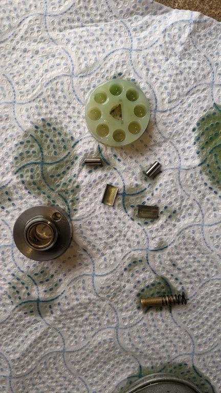

Hello all....today i started the grand job of relocating the seized roof motor. On my 2005 Z4.ive come stuck with fitting the pump to the motor...when i finally got the top part off these parts fell out...i worked out the spring coil, the 2 pins but i dont have a 3rd pin and where do the 2 curved metal pieces go...?
The motor works but it is not engaging the roof mechanism as just its not connecting to the rod in the pump ?
Any ideas will be gratefully accepted thanks in advance. Mark

Usually the whole bucket pulls out in one piece, then you split it when it's out.

I had to split the case to get the motor out as instructed. The lower section is held in somewhere, I was wondering if there is a bolt or screw? Maybe just a trick that I can't figure out?
As far as I'm aware it's held by cable ties. I had a day at my place a few years ago when a guy relocated some 10 or so motors in my garage and I don't recall any that didn't come out in 1 piece.
Thanks for the help! It seems my top has lost its virginity long ago! Why only use 1 tie when you can get 3 on there! Especially where they can't be reached.
I unbolted the top at the pistons to get a look and was able to get the cup out! I have to thank the previous mechanic for all the sleep loss! lol
