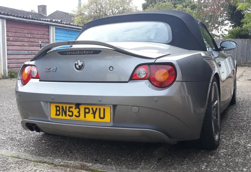

Yep it defo does it for me, be interested to know just how much ground clearance on the front. All it needs now is a nice aero rear bumper, like this one below. Lol
If this one fits on your e86 you could always make me an offer. Would even consider a straight swap one good car for another. lmfao.:whistle:
Bumpers a different shape, cheers for the offer. Skyer also do a rear carbon valence. I actually like the stock look.
