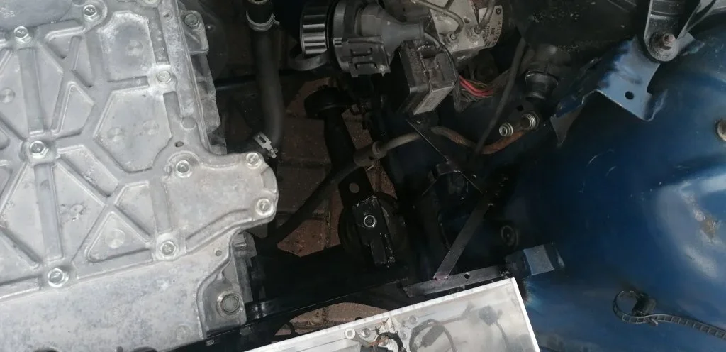

I haven't got much more done this week lots of staring at stuff and finalising decisions around the exact battery layout and mountings for the front battery box I've also finished drilling and tapping the base for the battery box.
To allow me to make the battery box mounts I've made a temporary mounting to hold it in place
Which is doing a fantastic job spot on
Hopefully I'll have a more productive day tomorrow

Started the fabrication of the front battery box mountings this weekend my choice of steel was the same thing I used for the engine mounts
40mm x 20mm 2.5mm thick steel box section mainly because I've still got about 5m of it as with the engine mounts I've reinforced it where the mounting bolts go this time with steel tube welded in to stop it crushing when the bolts are tightened up
and here it is tacked in place

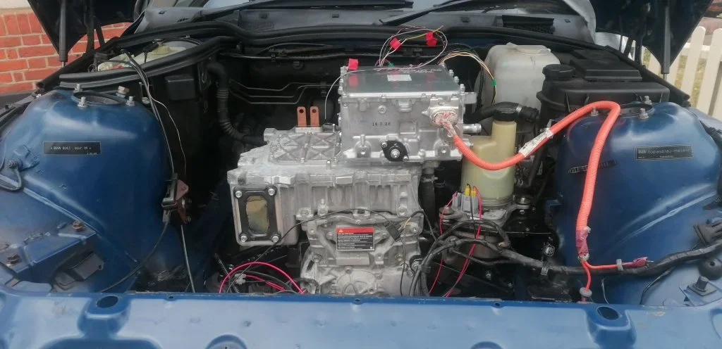

The ac part of the Mitsubishi charger is all tested and working, all of the front battery box mounts are finished,
The electric power steering pump brackets and mounting plate are done they just need cleaning up and painting and I even managed to use the existing pipework
also managed to make brackets for and fit the new ally radiator for cooling the motor, inverter and charger
It's getting there just slowly

Tested the power steering Saturday and guess what the pump's knackered :mad: trying not to be angry can't send it back I bought it months ago new one is on it's way on a positive note I did get to flush out the pipework and rack also got around to flushing all of the braking system through, refilling it and bleeding it and looking at what came out it needed doing it was very cloudy also got the location finalised for the charger
