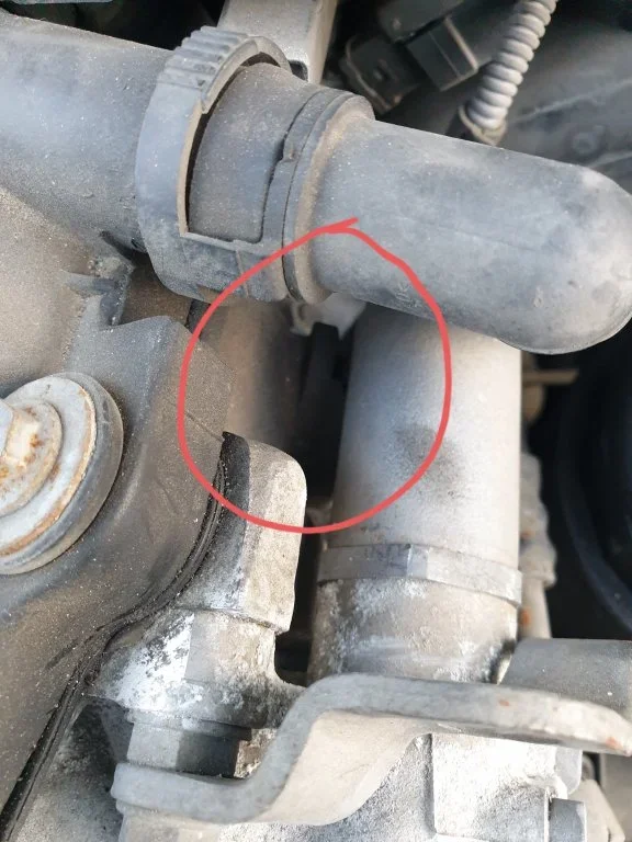

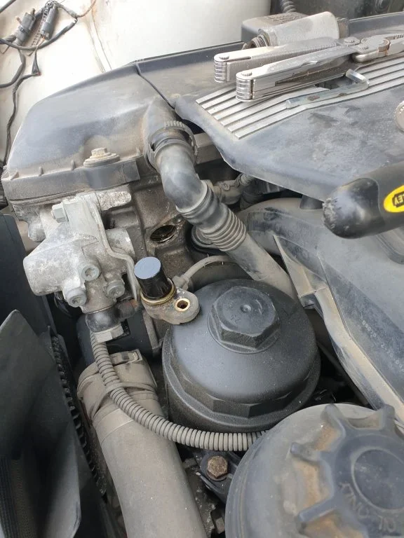

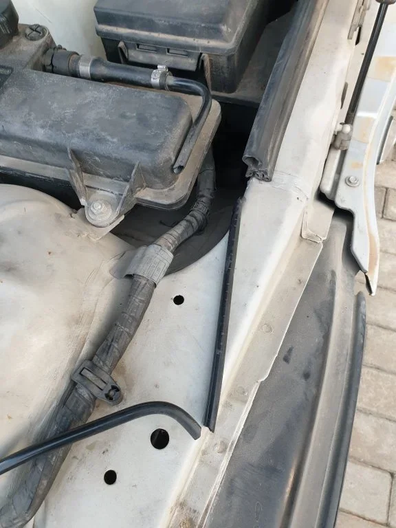

I got a bit of time to spend swapping out the Inlet Cam Position Sensor this evening... so here goes:
Got the airbox out (eventually)... unfortunately managed to shater the very brittle plastic radiator pipe. Question 1: does this carry fluid under pressure? If not I can probably make a replacement with some small guage irrigation pipe I have.
Referred to a previous post on here and the photos show what I believe to be the Vanos solenoid missing.. with it in place, there is no way I can change the sensor as the allen bolt is directly behind the solenoid with no space for an allen key. Any ideas as to how I remove the end of the solenoid? Special tool maybe? Anyway, photos 2 and 3 show where this is.
So all in all a very unsuccessful attempt to swap the sensor. On top of that, the mosquitoes ravaged me and I dropped my glasses and scratched them 🤬🤬🤣🤣🤣

Removing the Vanos solenoid I is easy enough. I used some water pump pliers (about 8”) to loosen it, they’re not silly tight. I used a 1/4” drive socket set to remove the sensor screw. Try searching for “How to replace Inlet Cam Sensor” in the search box at top of page.
ps. I broke the pipe on my Z3 too and replaced it with copper.
Thanks Tony, I've been following this guide by Aceman which I found with a search:
This is the article that showed the solenoid off but given that I'd just snapped the plastic pipe, didn't really want to do more expensive damage trying to get the solenoid off first without checking on here 👍👍👍
Just tried the water pump pliers... it's on solid. Looks like it needs a good WD40 soak for a day or two 🙄🙄

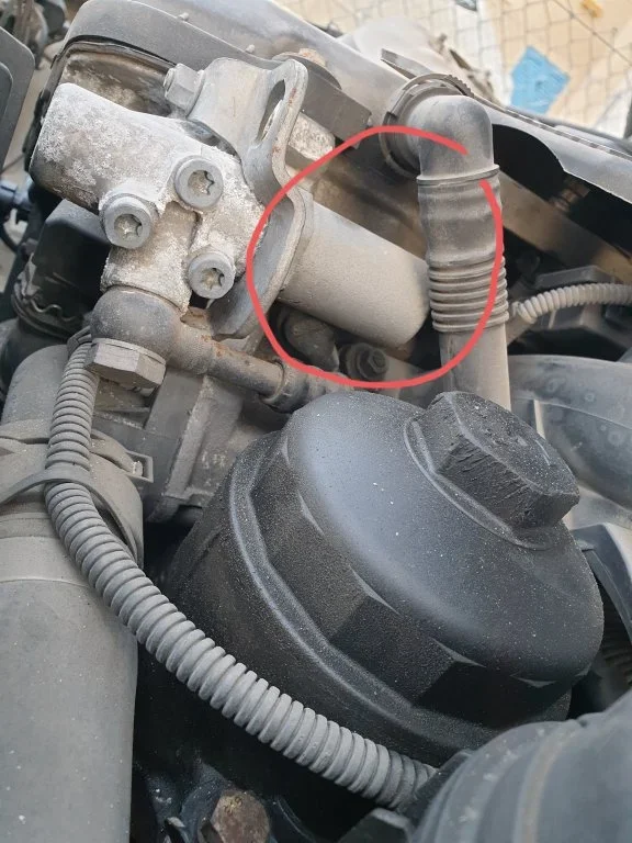

A pair of Mole grips and a gentle tap of a hammer has freed the Vanos solenoid. Swapped the intake position sensor over, put everything back together but still not firing. The battery is getting a bit low so it's on charge... will try and turn it over when the battery is charged up (of note, it's a brand new battery so I know that isn't causing the issue).
