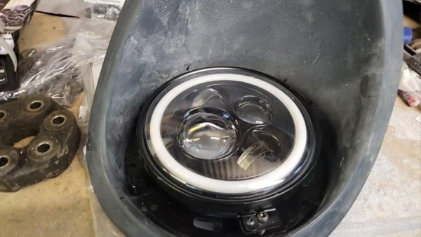

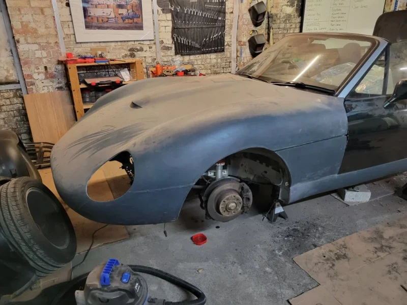

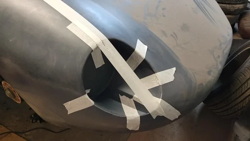

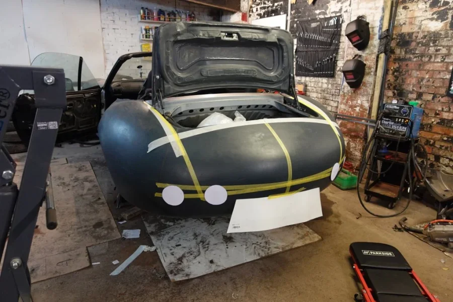

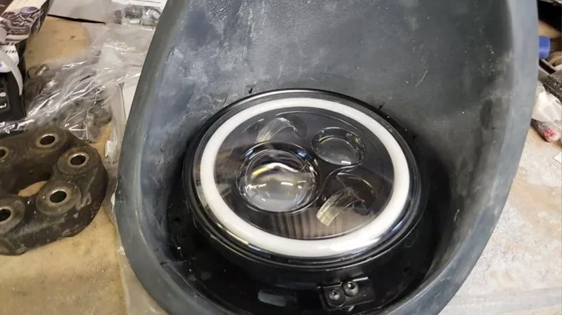

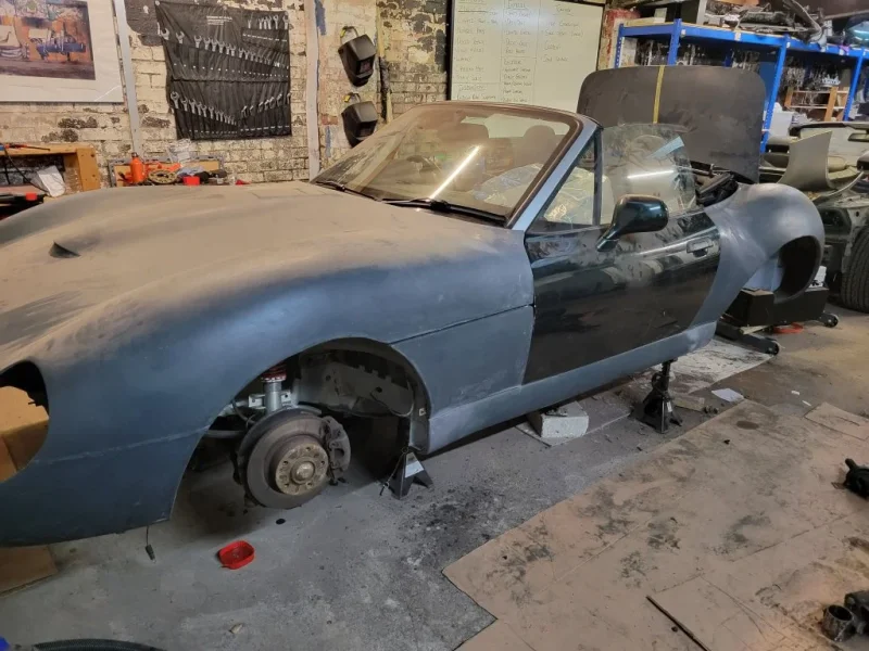

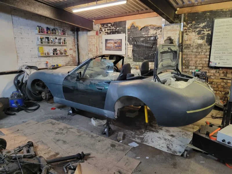

Making proper progress on the body swap now. Headlights half way to being mounted, working out the boot catch, and laying out the rear end lights/number plate.
