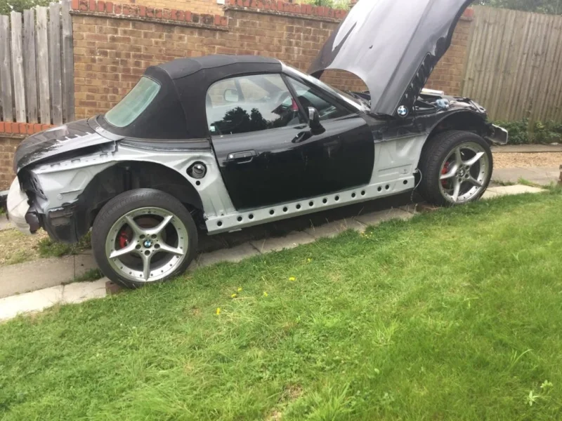

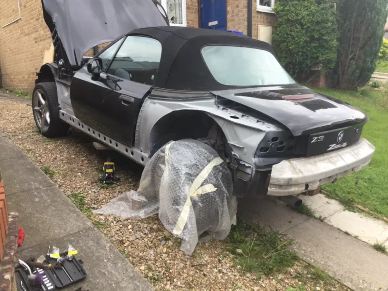

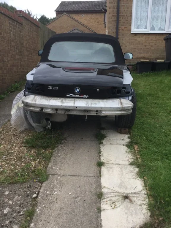

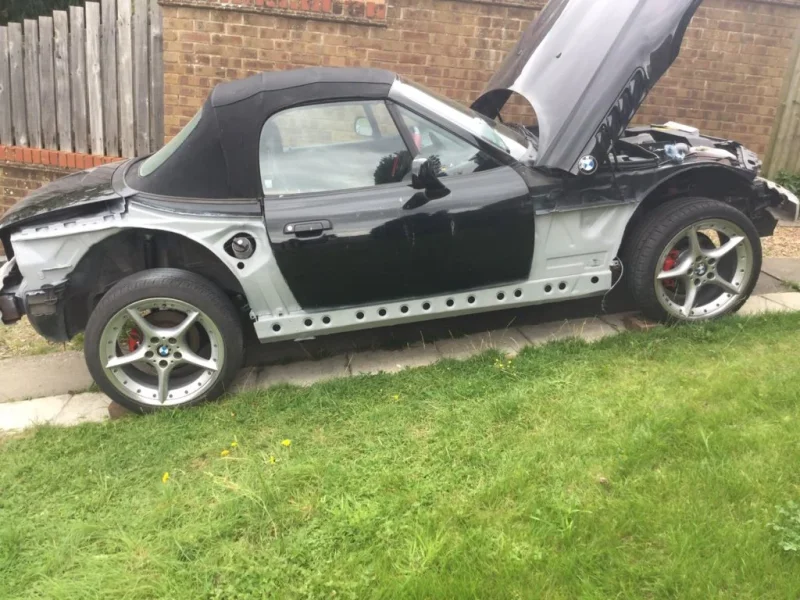

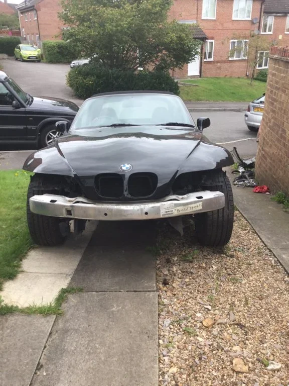

UP DATE TIME.
I have finished underneath the car now and all seems ok. Today I have been busy stripping off all the old body panels and checking that all the chassis is sound which it seems to be. The only place that I need some plates welded into is right on the end of chassis rails both sides at front where the muck had collected behind the broken iner wing liners, so I've cut out the rusty bits and made up and shaped some new end plates to be welded in other than that she is sound and nearly ready to go of to paint shop.
