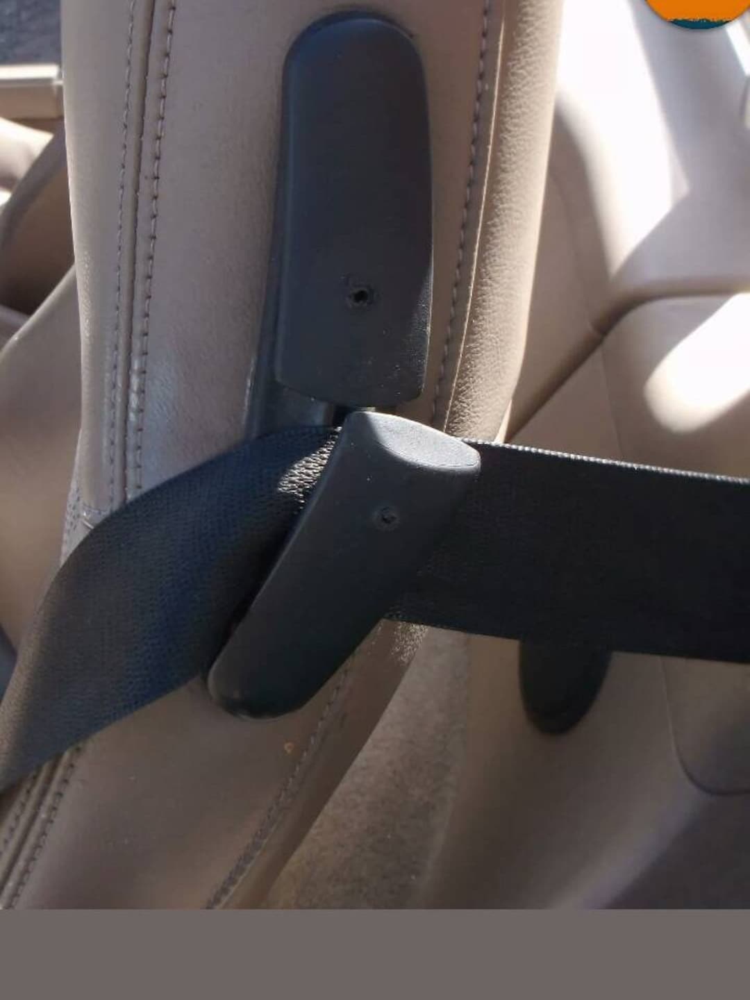

Could you give me a bit more information, like where to buy?
Bought on Etsy...vid below of some guy in the US fitting them.
Its a fix not a repair. You can of course buy new guides but the plastic is sewn into the leather...and there is nothing stopping it happening again
