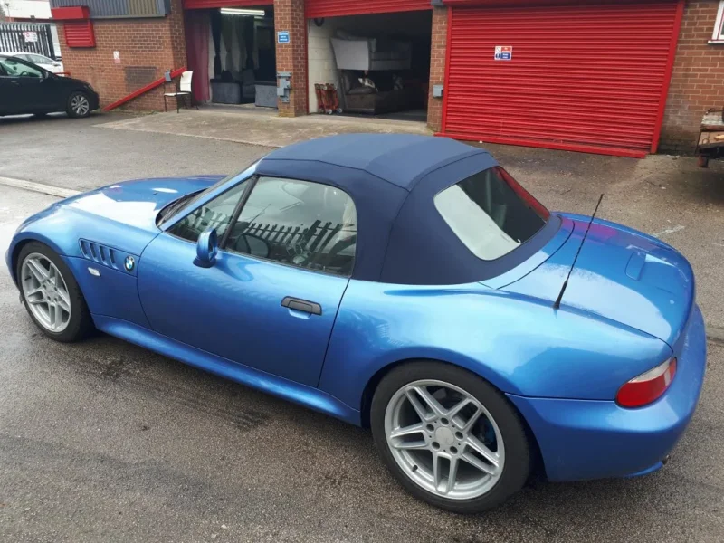

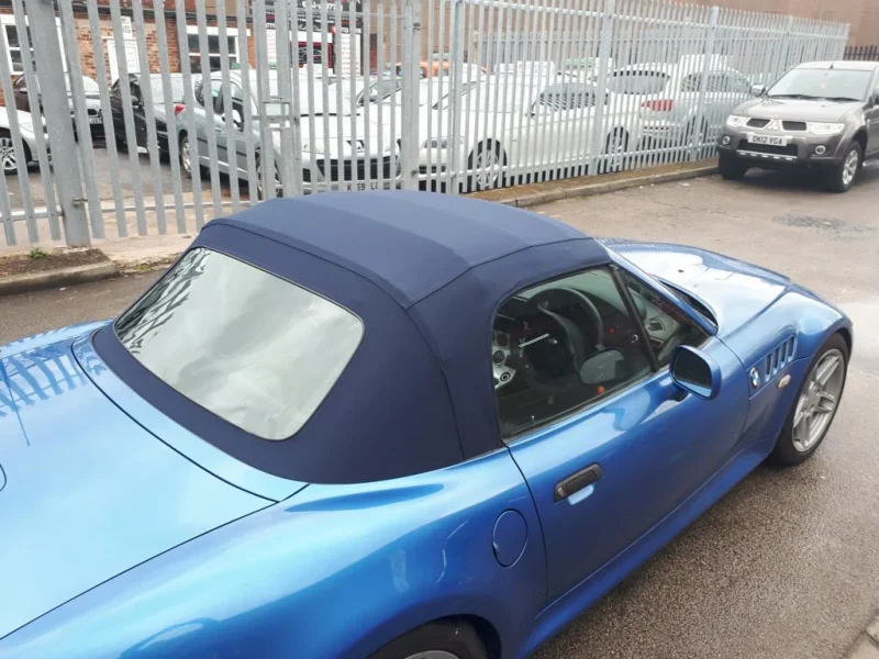

It's all coming together nicely. Today was roof replacement day with a trip up to The Soft Top Shop in Stockport. S*** drive but really worth it as the roof looks really good. It's slightly different from the original that came with the car as apparently it was a special colour that's not available anymore.
Looks great David:thumbsup::thumbsup:
Blue in blue looks good :thumbsup:
