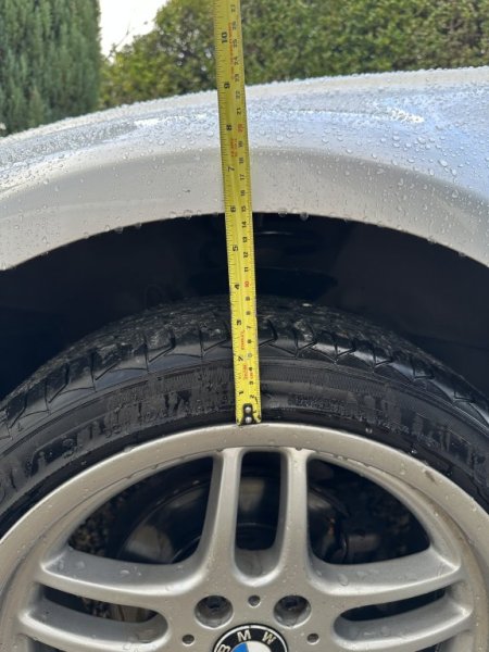

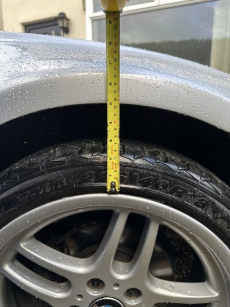

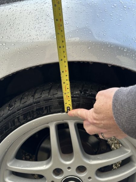

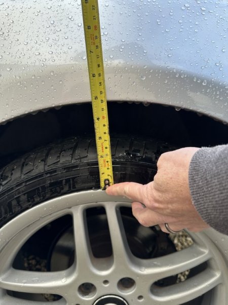

Okay. All measured. Photos attached but noted dimensions below also. Pics not in list order.
OSF 125mm
NSF 150mm
OSR 118mm
NSR 121mm
Garage are having it back on Monday. They don’t know what the issue is?!

OSF 125mm
OSN 150mm
OSR 118mm
OSR 121mm
I think (think!) you mean nearside front 150mm, offside front 125mm, offside rear 121mm and nearside rear 118mm.???
I would have expected the nearside rear to be much lower, given that the opposite front is sitting so high.
Yes, I’ve edited now. Thanks and apologies.
The OSR is 118, NSR is 121
OSF is 125, NSF is 150.
No idea what’s causing it and garage no clue as they already replaced front struts and springs.
