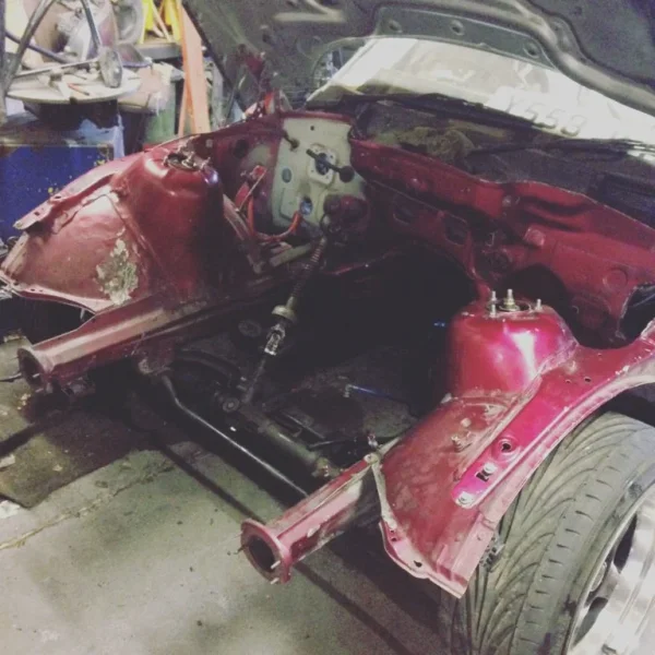

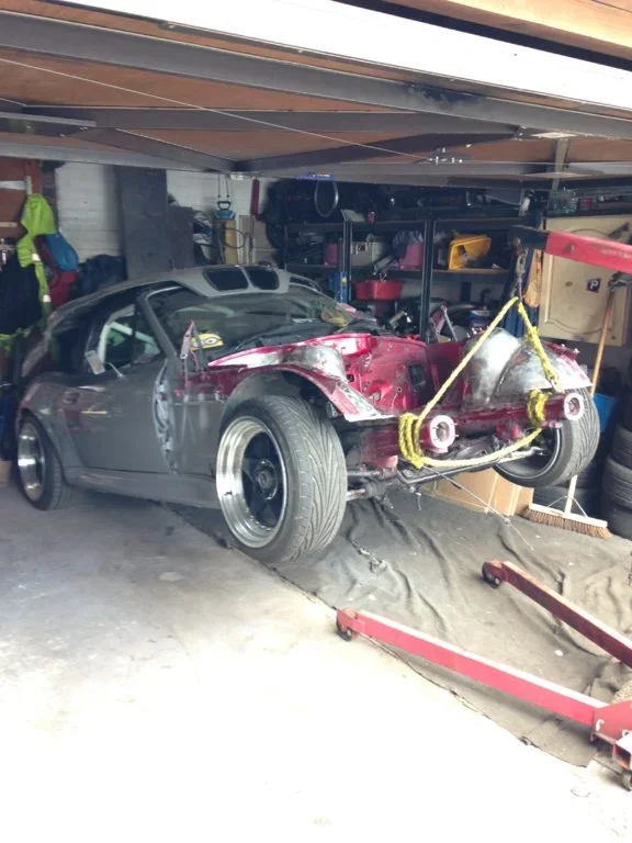

Next we started stripping the front ready to get the m50 out
I did a little time lapse video of me stripping the engine out

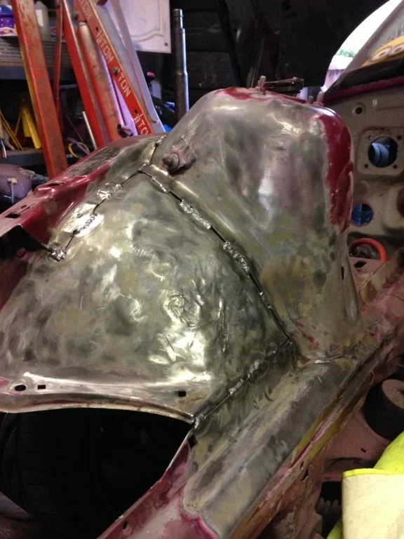

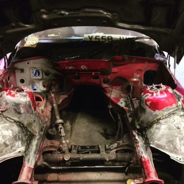

Stitch welded around the shock turrets for extra stiffness

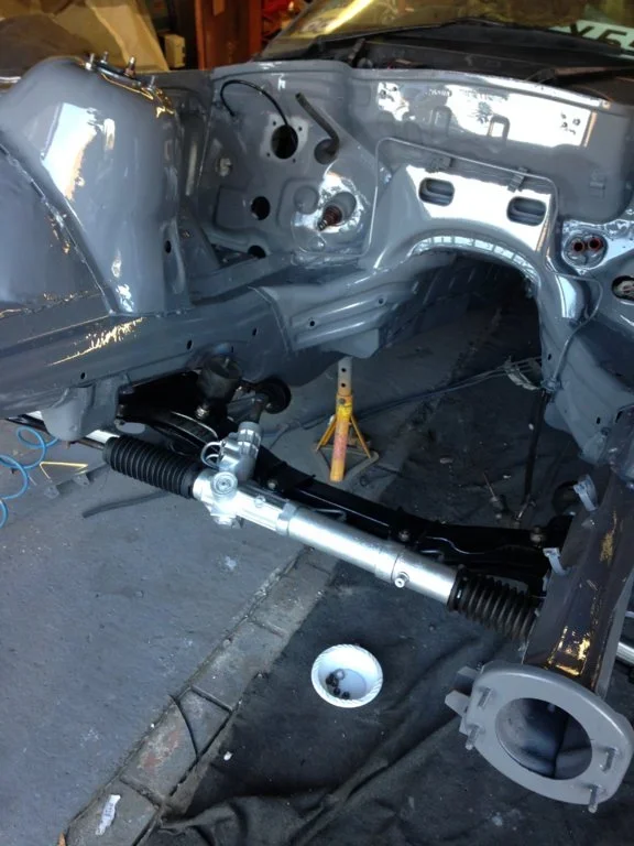

Primer time
Decided to do all underneath aswell
Didn't think to take a pic before I started building it up , as you can see I freshend up the subframe and rack aswell
And that's where we at so far
