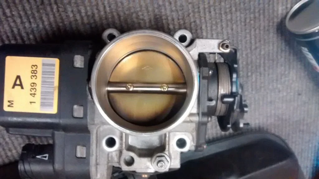

not necessarily, some are a hybrid and have both an electronic throttle, and a cable, where the motor only does cruise control and asc, the cable is used as a normal accelerator
This is mine with both:
The throttle reset is by using the 'adaptations' in INPA where the software calibrates itself to the driving style, Resetting it gets it back to normal defaults
