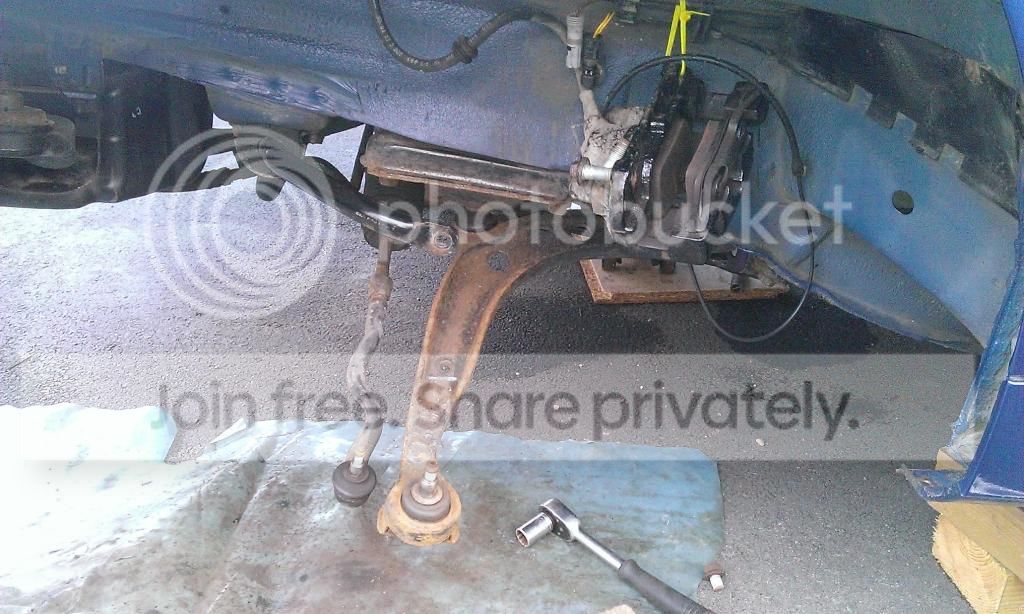

Well not a lot going on last Sunday so decided to strip the front suspension as last time I had the wheel off to mend the broken brake wear sensor it all looked a bit scabby.
I had refurbed the calipers in the summer so they were ok.
Caliper off, disc off and decided I couldn't get at the hub and control arm easily so out with more spanners and hammer and hey presto there it was all apart.

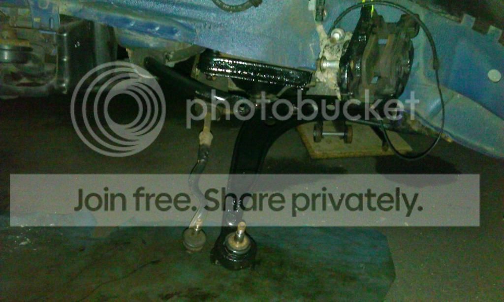

Painted the first side today and will have to strip the other side during the week.
Stripped down

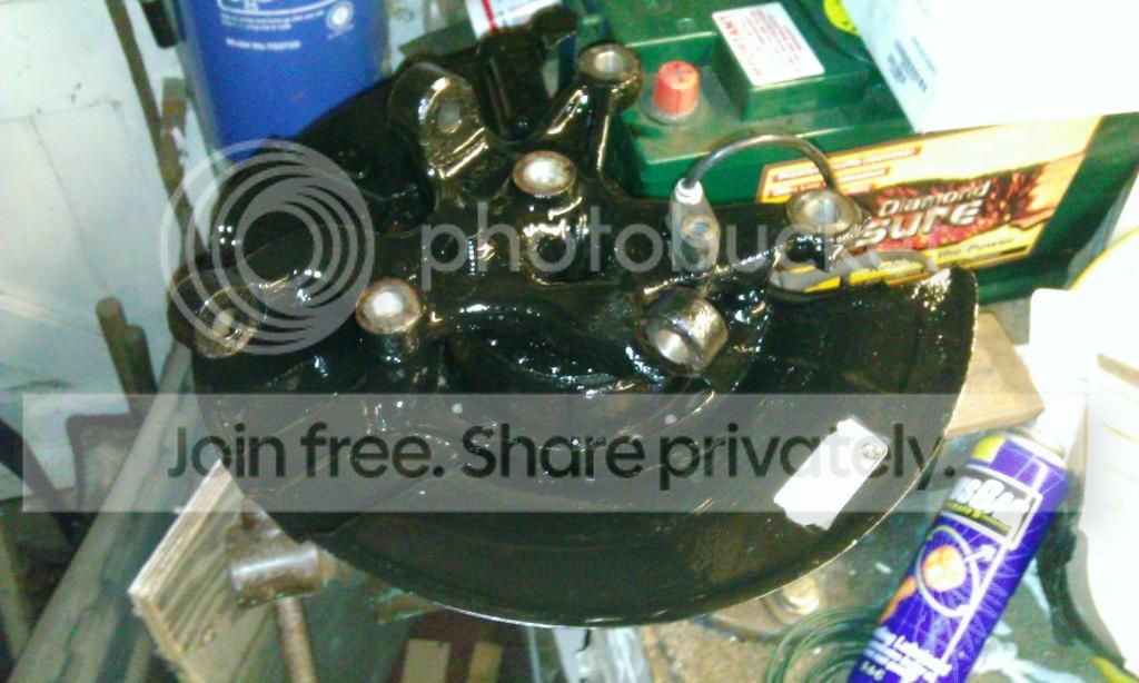

Painted.
And the hub carrier. (It's the caravan battery in the background.)

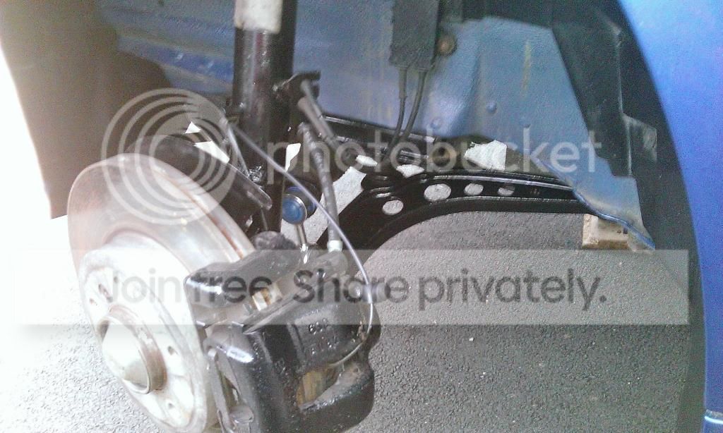

Well the 2nd set of drop links finally arrived the other week and manager to get it all back together on the 12 th and pleased with the results. Frightened myself because when I first started it up a battery was flatish and both ABS and DSC lights were on so immediately thought I had damaged one or both sensors. Anyway plugged the INPA laptop in and showed both front sensors faulty rest them and lights are off. It must have logged the faults when I turned the ignition on to turn off the steering lock and the sensors were disconnected.

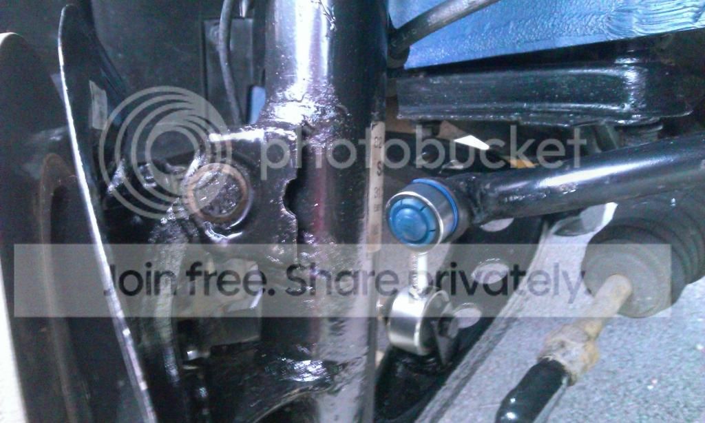

And the new drop links made by Meyle and have 4 year warranty. Much better quality than the previous ECP supplied ones.
……………...Meyle and have 4 year warranty. Much better quality than the previous ECP supplied ones.
