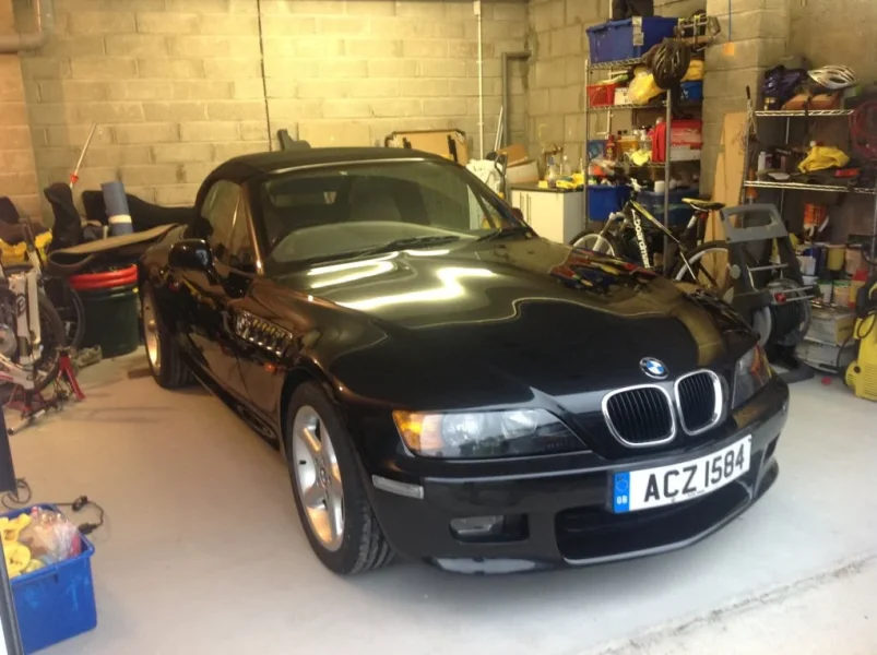

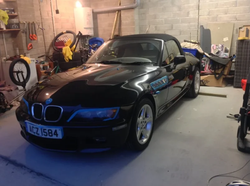

Owned my Zed for 2 weeks today, so a little update -
Named her Ace
Full service, brake fluid, diff fluid, 4 new springs and diff bush last week.
