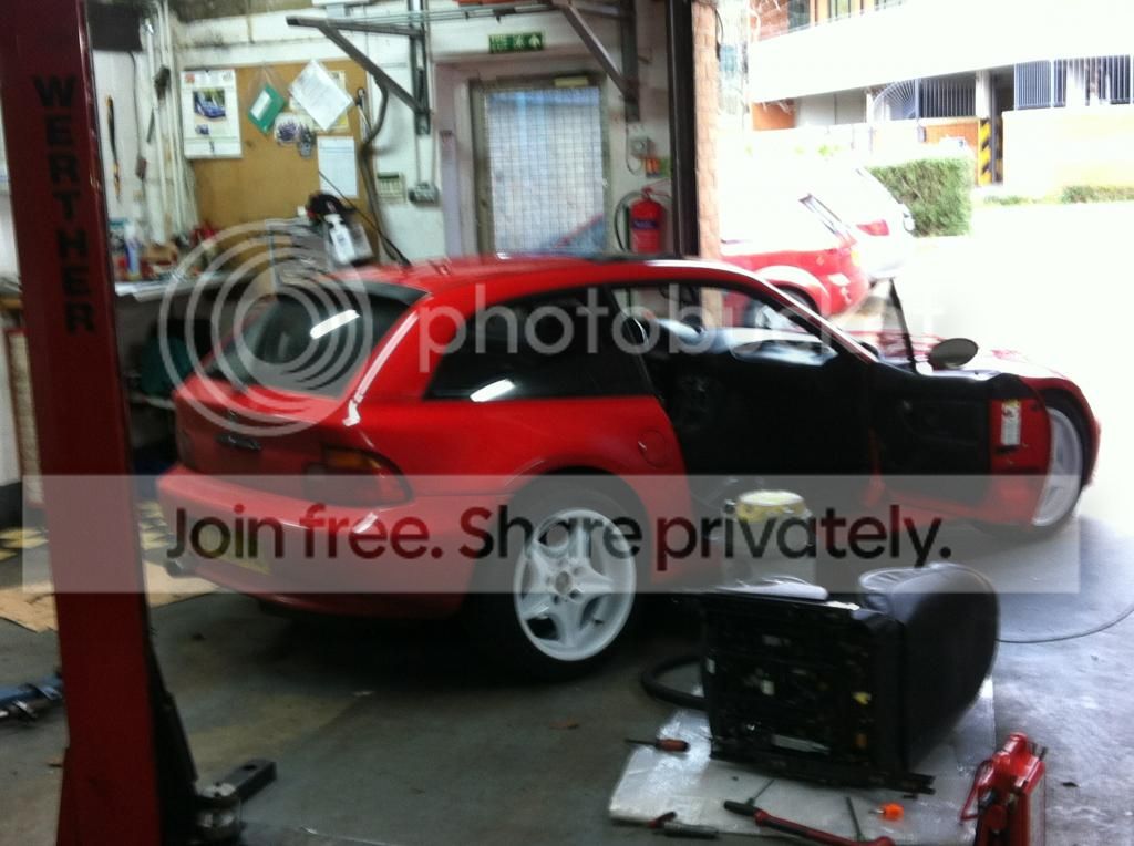

Was very busy this morning!

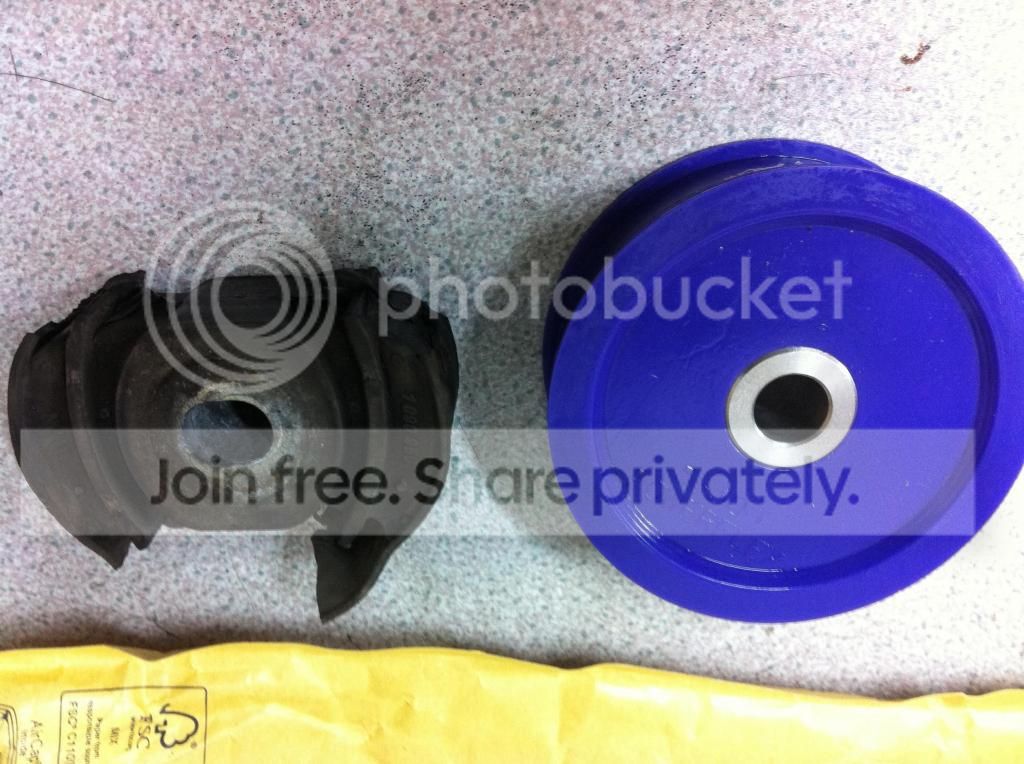

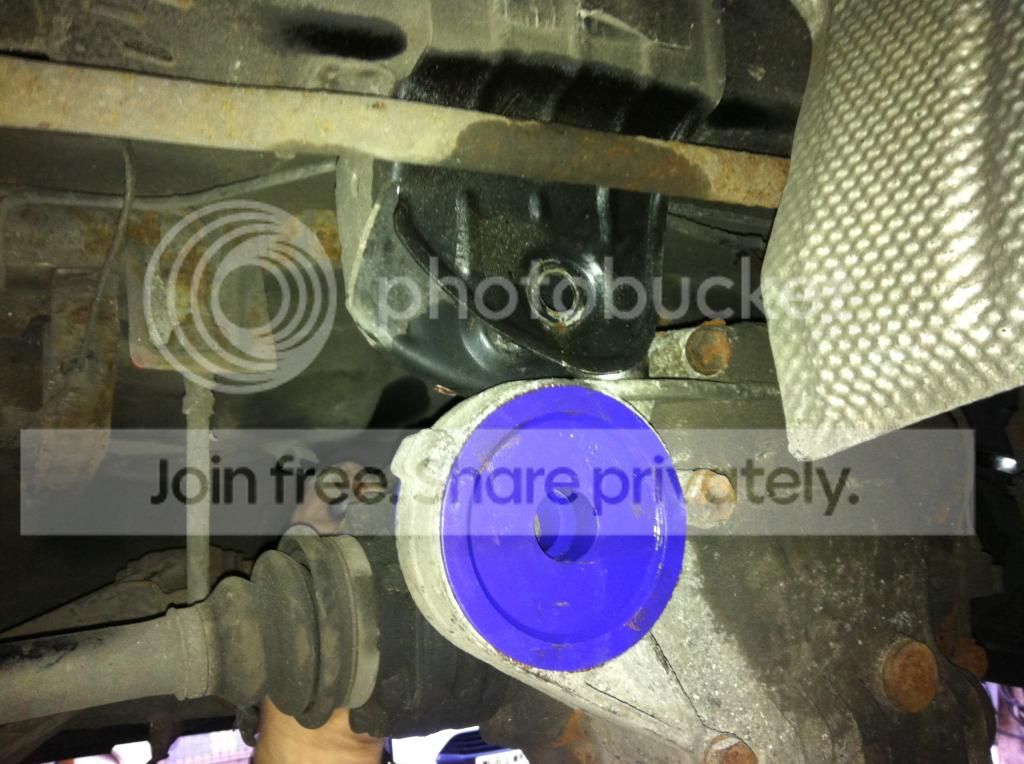

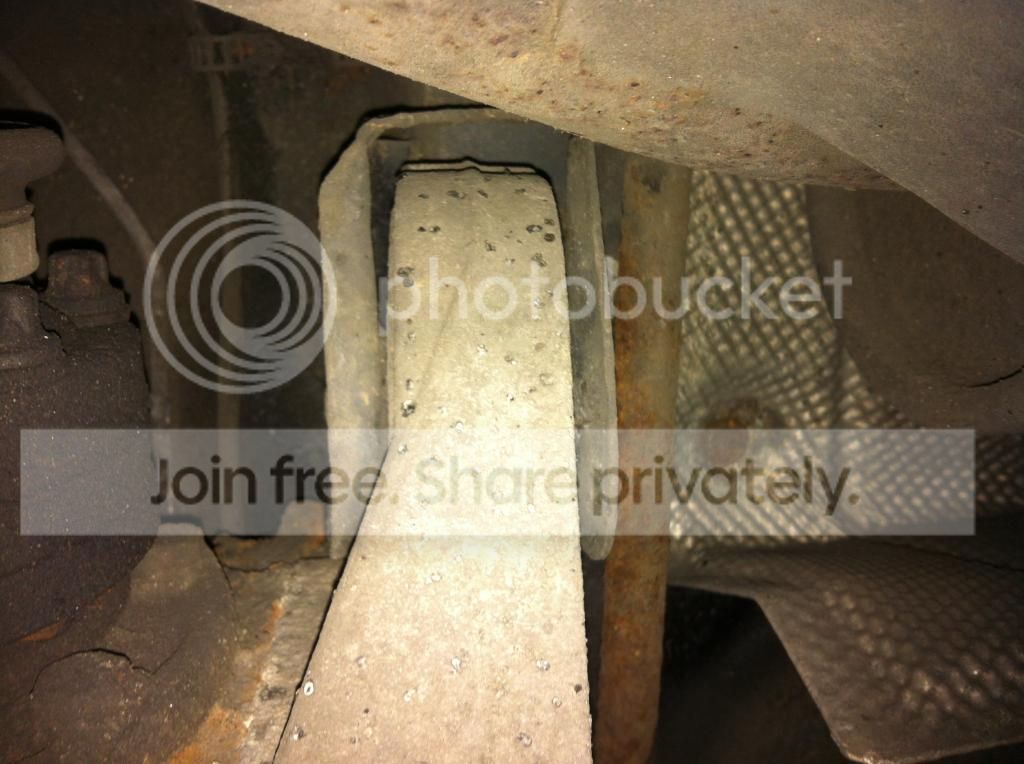

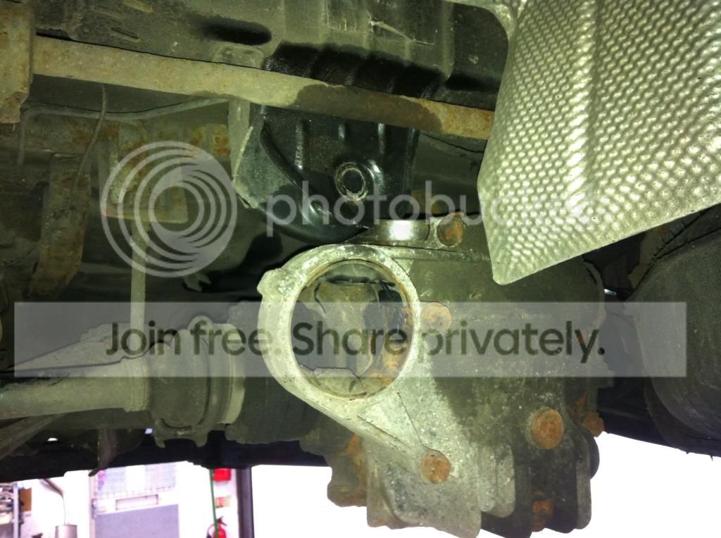

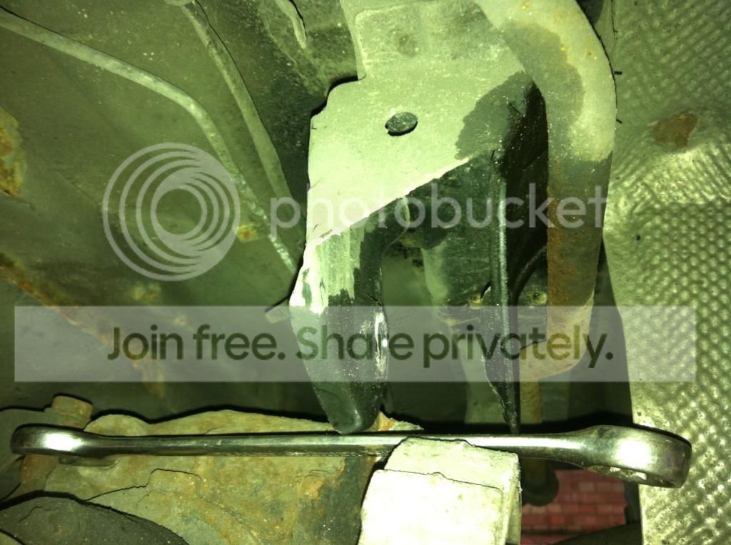

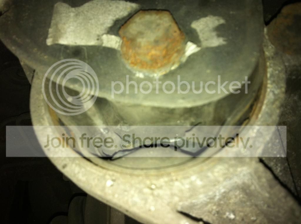

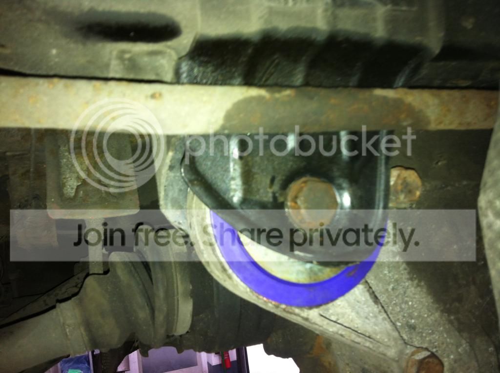

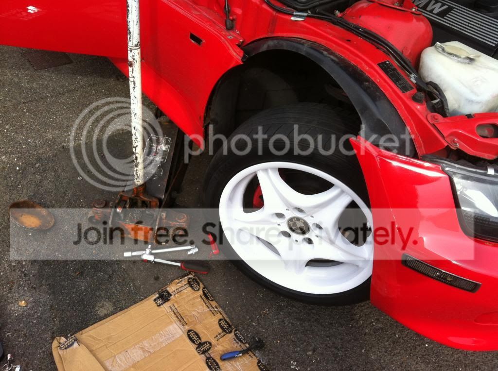

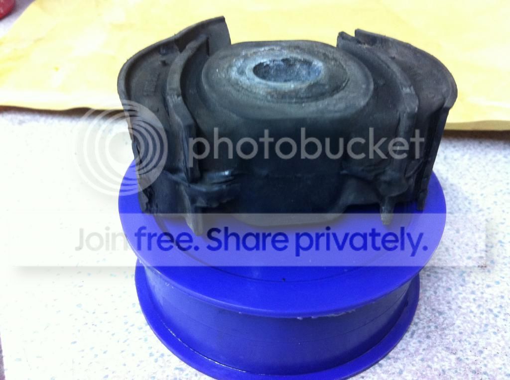

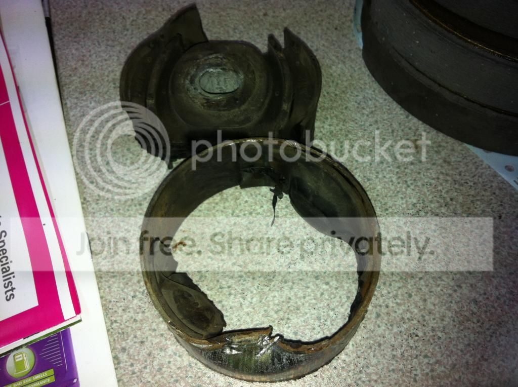

Finally replaced the rear differential bush, for a powerflex version, slightly harder than discussed on here recently as I upgraded my rear hanger to a double ear OEM upgrade so we lowered the rear subframe to get the old one out and new one in.
Then changed the faulty brake wear sensor
Also gave her an oil and air filter service

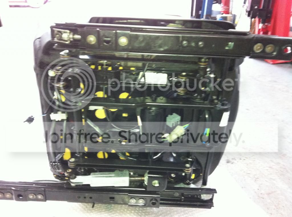

Followed by changing the seat bushes on both seats. @Aceman
On the plus side I found over £11 under the driver's seat!
You original diff bush looked about the same state as mine did - can you feel any difference with the Powerflex one in place?
That £11 should help recover the cost of the new bush![]()
