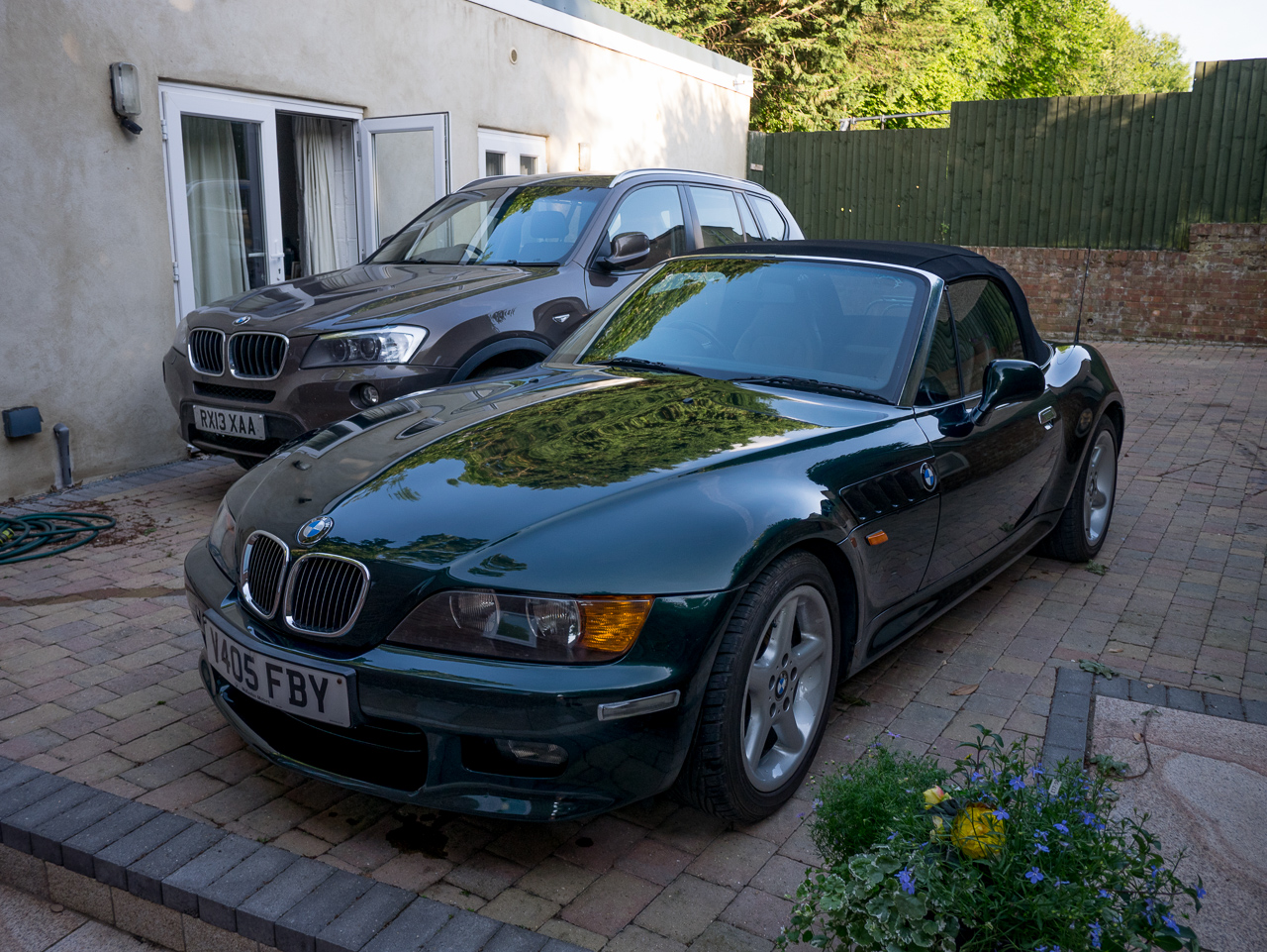

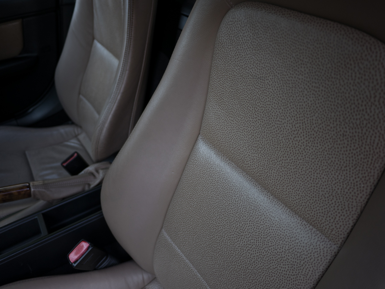

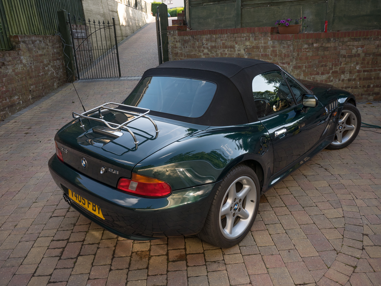

Here's my Z, as I've got it. 2.8 facelift, 60k miles. It has 'unusual' leather it seems, all the normal goodies from the 2.8, the radio/cd was replaced by an Alpine bluetooth thing.
