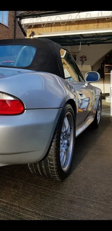

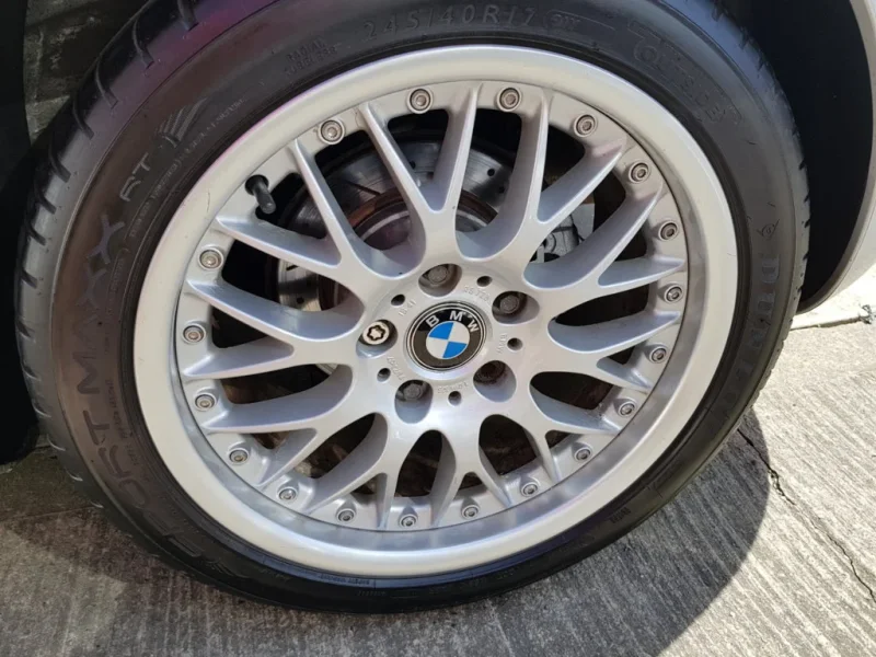

Back tyres are 245 40 17 Dunlop Sport Maxx RT as per pic. BTW I've also got 20mm spacers on the backwhat do you have on the rear 255's ? it looks great.
In all honesty I'm not the best to answer this but I think its due to original BMW wheels being staggered where the front are narrower than the back. To my knowledge I'm running standard sizes as what it left the factory???Im running 225 45 17's all around. If I can go wider on an 8" wheel, why does everyone go down in highth when they go wider?
like you running 245 40 17 on the rear instead of 245 45 17.
To maintain the same rolling radius, if you keep the profile the same then the rolling radius will increase and the speedo will be innacurate.Im running 225 45 17's all around. If I can go wider on an 8" wheel, why does everyone go down in highth when they go wider?
Yes, thats normal for a staggard set up from the factorySo somewhere in my cars history before the wheels were changed, it had staggered wheels from the factory with lower profile tires on the rear than the front?
If its not staggered are they the same highth then. Im asking all this because my rims are 8" all around but Im checking to see if I can put a wider tire then 225 on my rear wheels. And if so you guys are saying I should drop to a 40 from 45 in highthYes, thats normal for a staggard set up from the factory
