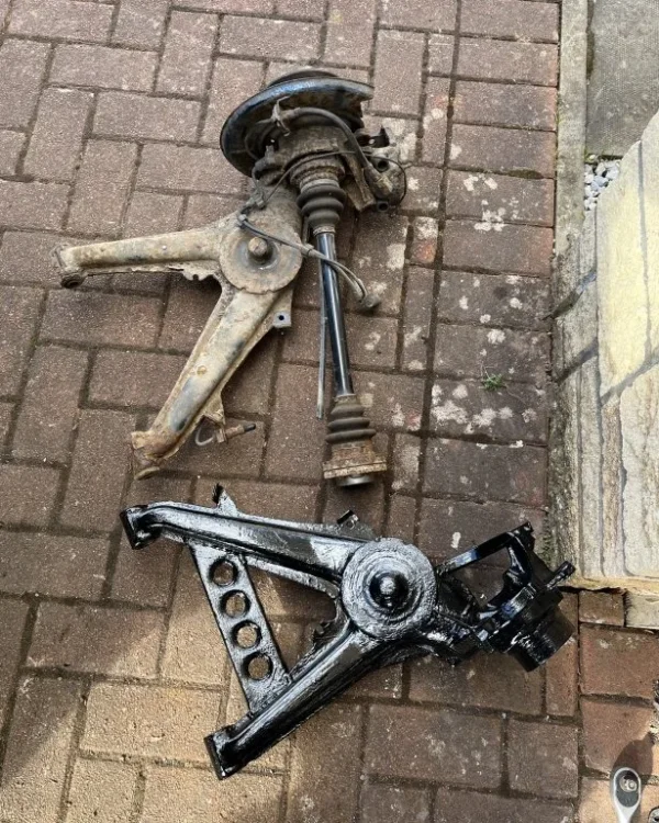

A while ago I asked a question about trailing arms on Wide Body. What is the difference is between narrow body arms and wide body? ie wider arms?
Thanks
IainP
Feb 20, 2019
119
1.9
The dimensions of the actual pressed arms are the same. The casting welded to that is longer, I didn’t bother measuring, I’ve seen 24/25/28mm longer quoted.
It’s often quoted the beams are different, they’re not.
THE ONLY DIFFERENCE IS THE CASTINGS.
For clarity, the shafts obviously are longer. Bearings different, or another way, what is related to the castings.
Whatever the actual length of the casting is, it makes the arm ‘wider’ by that amount, so putting extra torsional load through the pressed arms. The ‘wider’ arms have a reinforcing bar welded between them. Narrow arms don’t.

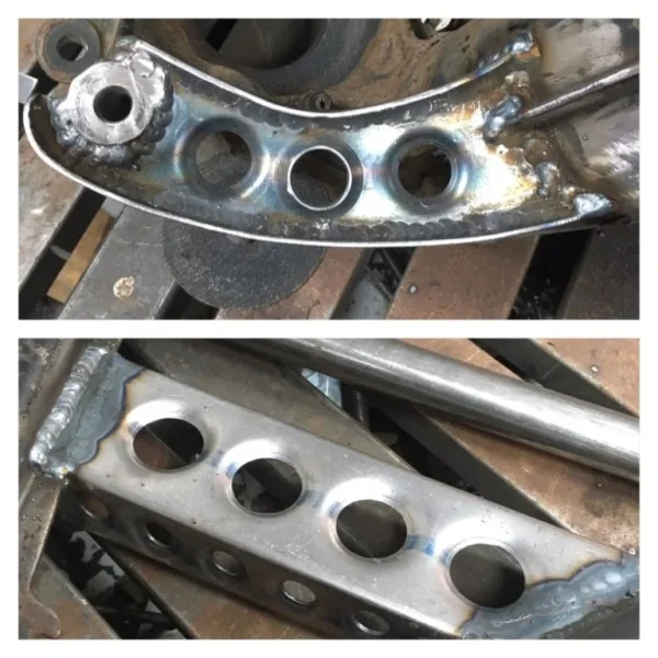

The e30 and Compact racers use reinforcements they weld in between the arms. They also insert two pieces to support the casting to the rear of the arm. Fairly easy to make if you want to do it yourself, but you need to be confident in your welding skills.
Those are both narrow arms.
I also added these.
Essentialy a dimpled H beam connecting the rear damper mount to the main body of the arm. For no other reason than giggles really.
