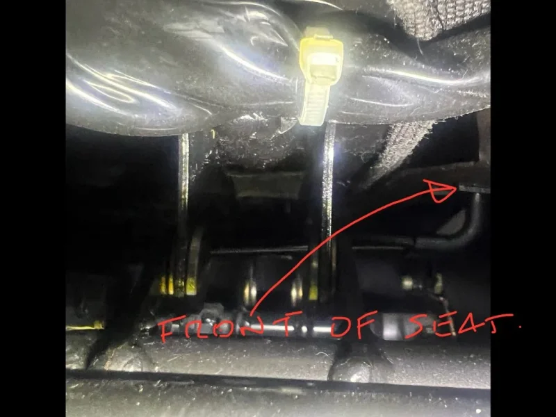

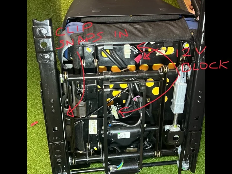

Mine had this issue with the manual recline lever , I removed the seat to find the bracket had popped out from the frame.
This just clips snaps back into the frame without actually removing the seat,:rolleyes: if that is the problem .
Mine was the passenger side UK (Driver if state side usa )
If removing seat just disconnect the battery to save airbag faults .

Interesting. Thank you. I will try to take a look (if I can contort myself into being able to see from the floor)
Just for information....the seats with bases attached are VERY heavy. Don't do yourself an injury when trying to lift it.
Oh crap. So how do people get them out? There's so little room in the car I've been looking at it and I have no idea how to get it out or how to tip it or something to reach the bottom.
