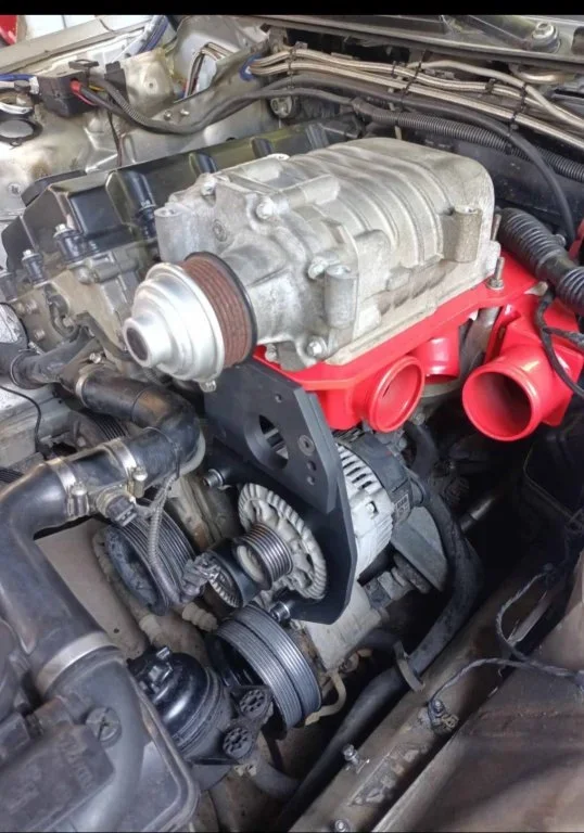

It should all fit under the bonnet, I think it'll actually end up a little lower and further over once mounted with the kit, I've added a photo in the thumbnails of one installed. It will have additional pipe work for an intercooler. I'll probably go for an electic fan to help with the pipework spacing. A power bulge would be great though
Quoting the kit makers website, they're supposed to make 250 to 300 bhp with proper fuelling and a pulley but we will see, I'd be delighted with 250, Standard the SC only does 7 ish psi, it'll do 12 psi with the pulley, so not daft pressures. It pumps about 0.7L per revolution. The pulley is on the list.

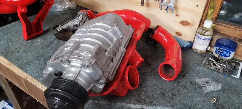

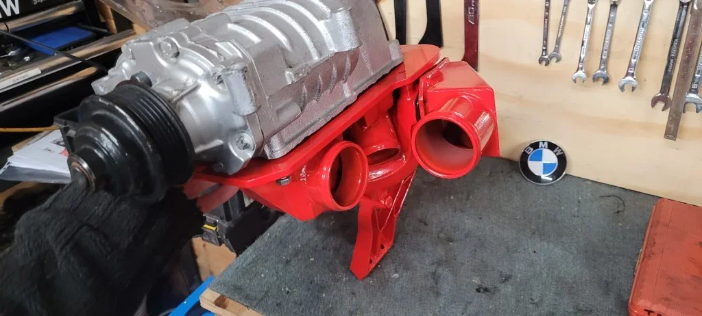

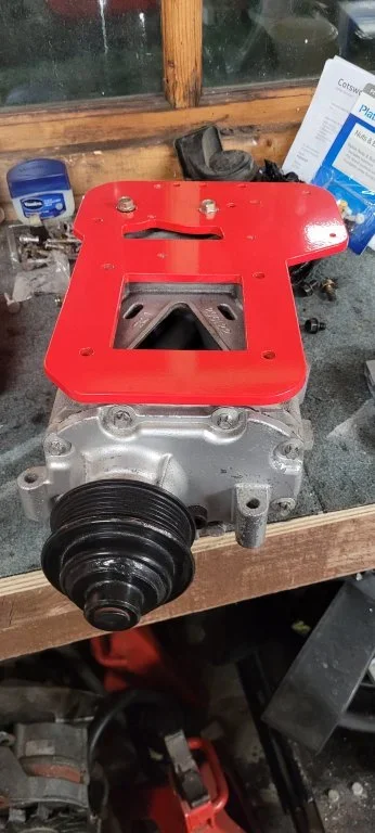

The pipework makes sense now (I think), the part I couldn't see before was how it tied into the inlet but the plate the charger sits on covers the original route and the kit utilises the hole left by the disa valve. I'll need to trim back a little of the casting on the original inlet and the edge of the throttle body.

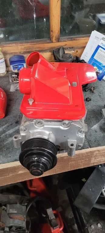

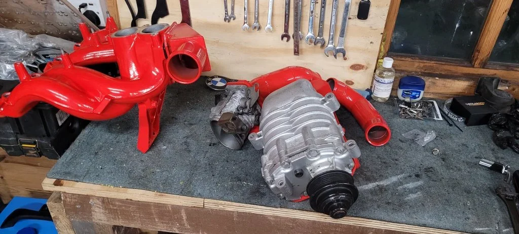

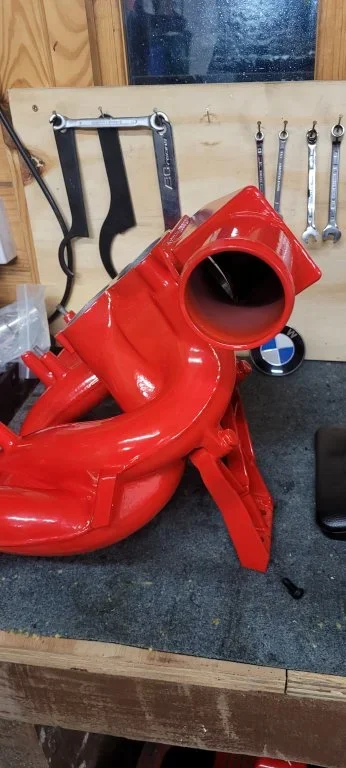

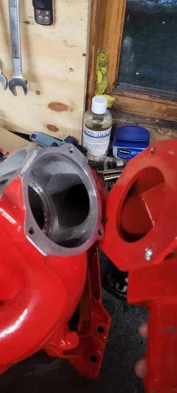

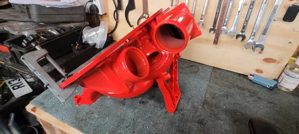

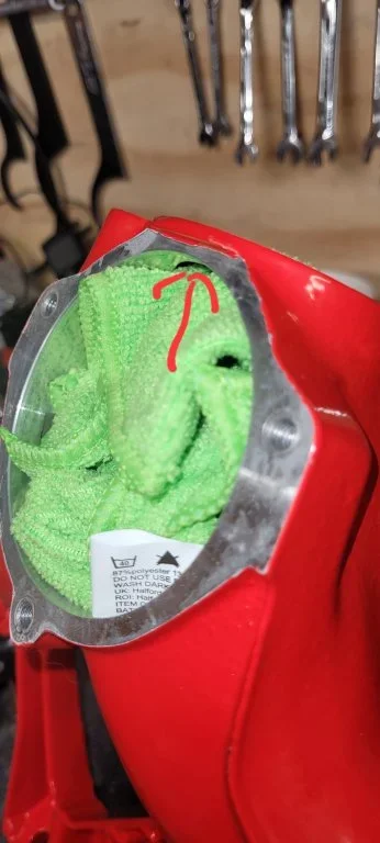

A little bit if progress, I started chasing out the threads as they came full of powdercoat. There was also a lip on the cast of the inlet that would clash with the inlet elbow, which needed ground back.

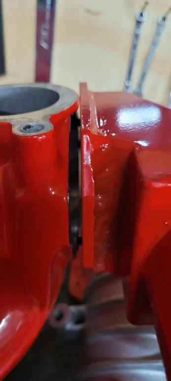

I then noticed that the "ports" between the two parts didn't really match. I am hoping with wasn't a mistake but I've opened it up as much as I dare to be a close match to the inlet.
I've been using RTV gasket sealer for the mating surfaces, hopefully that does the trick against the boost. In the mean time I've started taking bits to work as I have access to a sand blaster and decent parts washer.

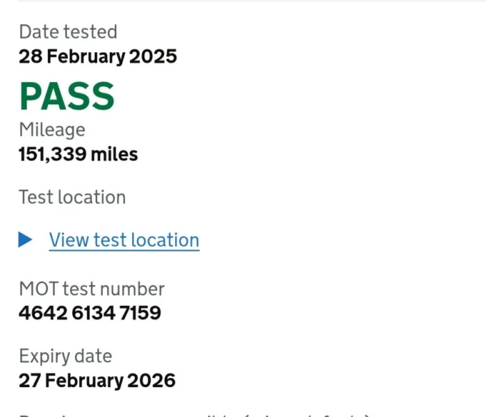

Tried it in a test today. All the old fail points are sorted but this time emissions got it. They suggested a cat cleaner but they also do a 200 cell cat, so I've opted for that. It's back on the 25th for the cat and an alignment. Almost there =))

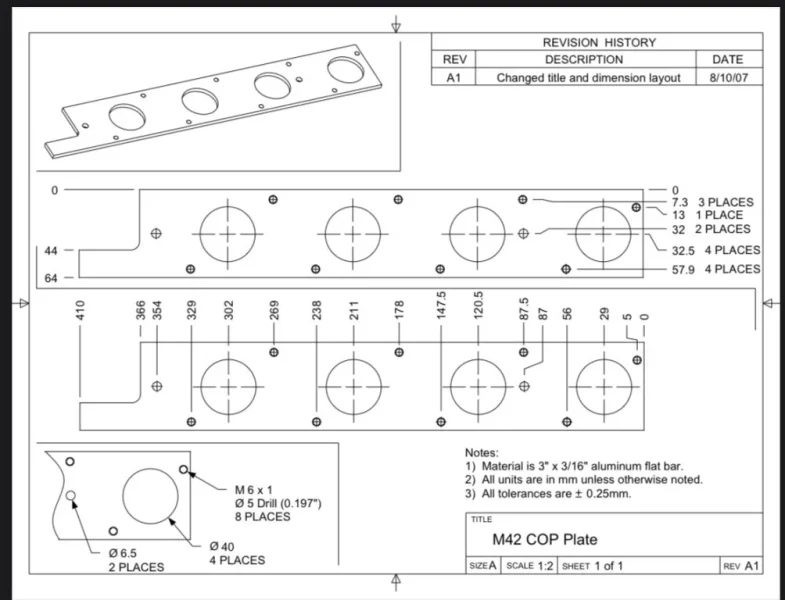

My rocker cover was ready to collect, so not all bad news today. I did say it was going to be red overload. I need to work out the dimensions for the COP conversion bracket.
