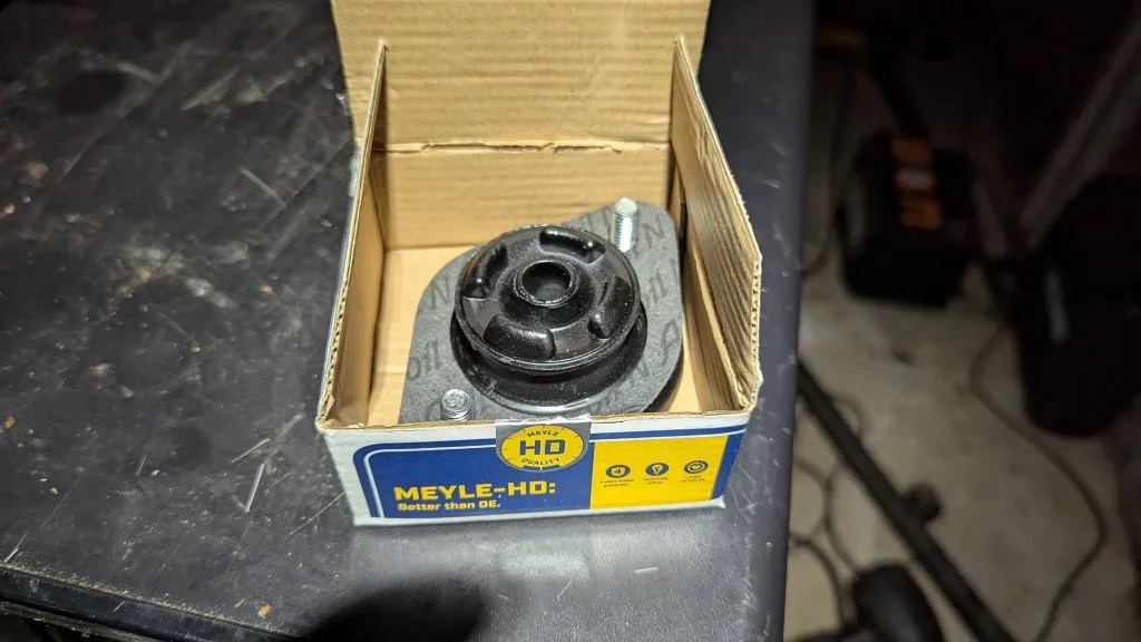

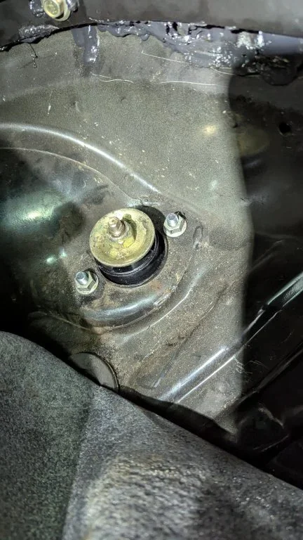

- Rear shock top mounts. Hopefully arrive today or tomorrow as they are making a very annoying squeaking noise and I want to drive to the Forest of Dean on saturday

Bushes done for the rear shocks. The old ones were knackered so fairly confident I'll feel and hear the difference. £16 for the pair as well which isn't going to break the bank!
