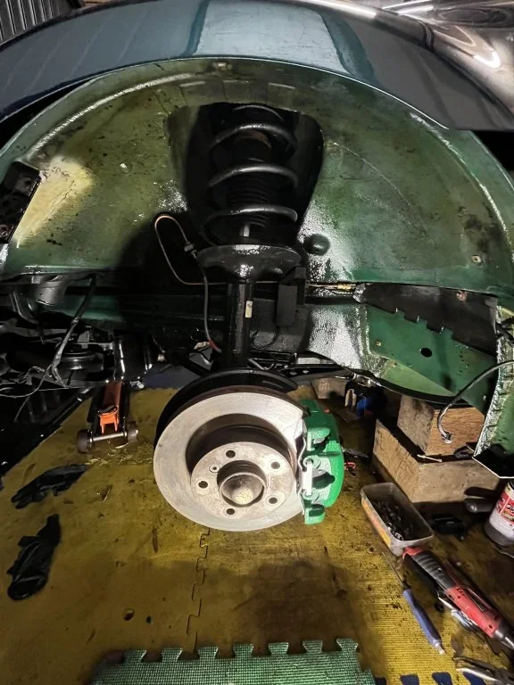

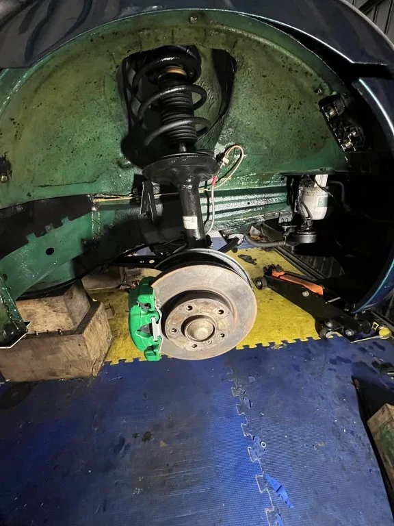

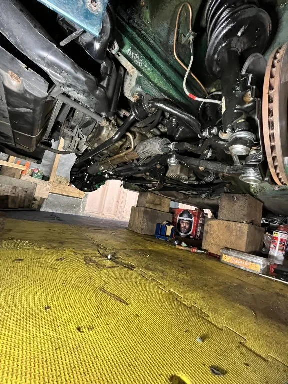

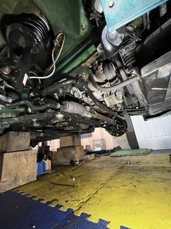

Work has now started on the front end more pictures to follow
