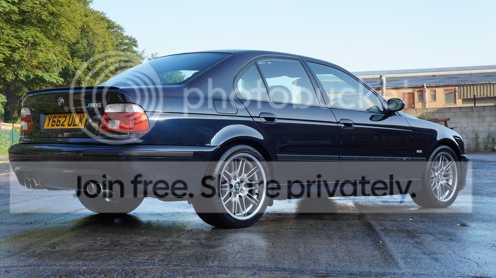

sorry ive no before pics but this was a while ago using the meguiars 105/205 combo on a DA, it was heavily swirled and carbon black shows up all defects.
nice car too, my mates e39 m5 before he sold it
