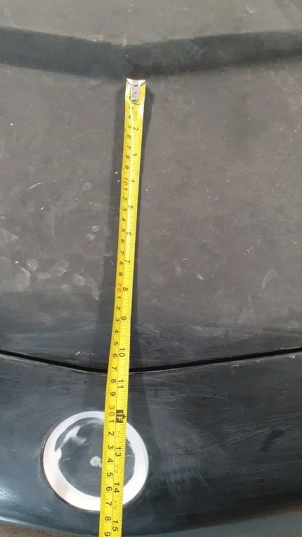

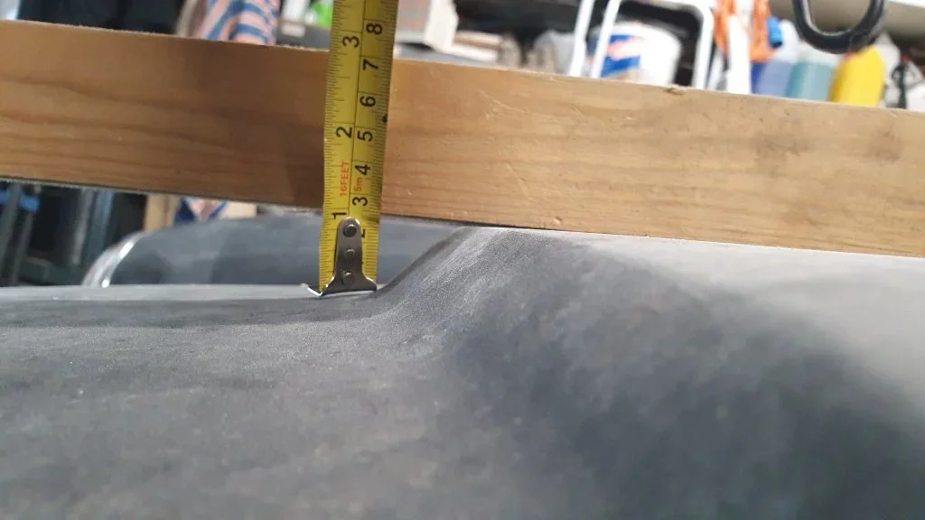

After much thinking I've decided that bulge is way too high but the position is OK. I think I'm going to leave the bulge where it is but chop a big wedge out of the front and sides and lower it so it's just around 1cm or so high. Height will depend on what thin metal/chrome trim I find to put across the front of the bulge.
Mine is 25mm high at the front. I think any less might look odd. It's now set back 270mm

I've decided to cut around the front and sides of the bulge and push the whole thing down so it's just around 14mm high at the front. Maybe even a bit lower depending on the width of the trim I decide to use across the front of the bulge.
The herald trim. I'll look at one of those same as your's then another two. One either side across the front of the bulge. Would the length of that herald trim be enough so two of them would go across the front of the bulge?
I think you would need two bits.
Only the rear quarter has the pointed section and probably not long enough for everthing you want to do
