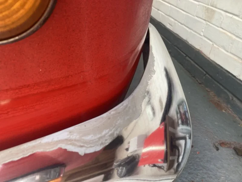

Chrome paint done properly is excellent if done well. Mine wasn’t and water got under the top coat so it peeled off.
second attempt by a different person is Ok, and heavily coated with clear paint.
finding a person who can supply quality work is nigh on impossible

Same guy....2 different results. Mine is awful 😖

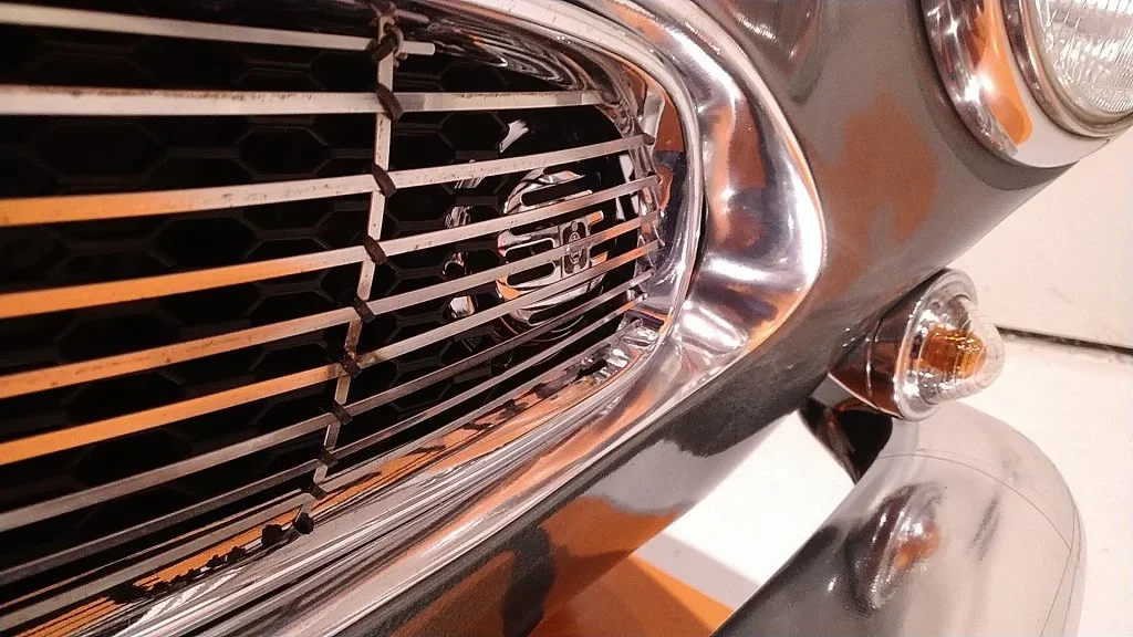

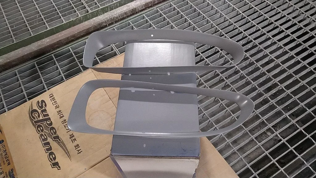

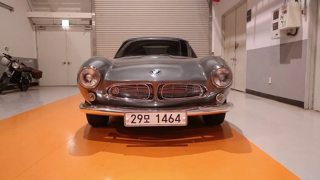

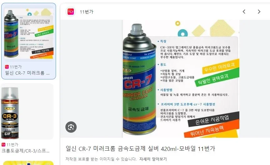

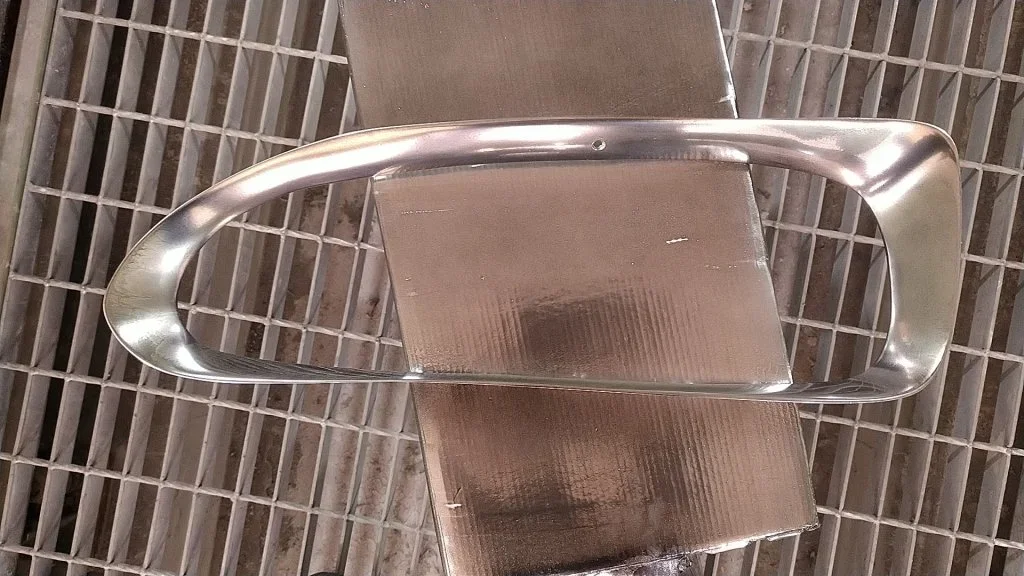

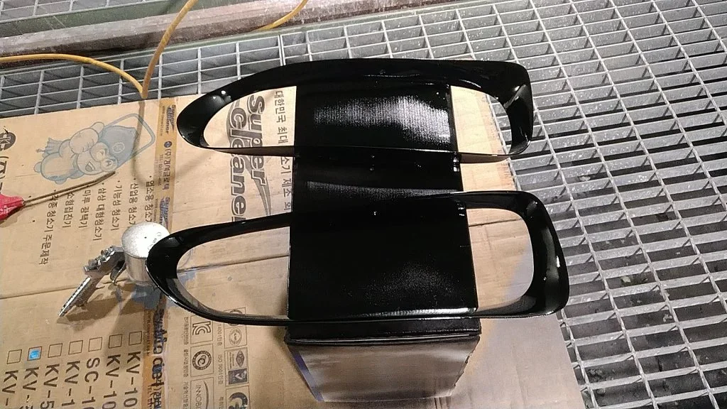

I also went through a lot of trial and error. The bumper is a wrap and the grill is a $30 canned spray (420ml). Before using the canned spray, I made sure to completely dry the 3-component black urethane and then used the canned spray. This gave me much better results.

Your bumper. there's joins. How many pieces is your wrap? I tried doing it in one piece but it really didn't want to stretch that much. I'm reluctant to do it in multiple pieces. I'm thinking now that I might do the top in one piece and another on the bottom and then put a rubber strip around the middle to cover the join. But I also found that using the soft felt covered spreading tool on the vinyl left marks and light scratches that don't polish out. So I'm beginning to think that wrap might not be a longer term solution.

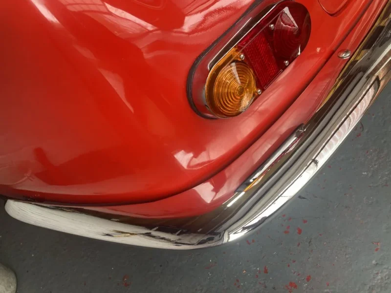

This is Simoniz chrome spray paint. Compare the bumper to the boot lid handle.
When it goes on it looks a bit more like chrome but when it's dry it actually looks quite grey. I think the 'Wheel Silver' paint from the same company looks better.
