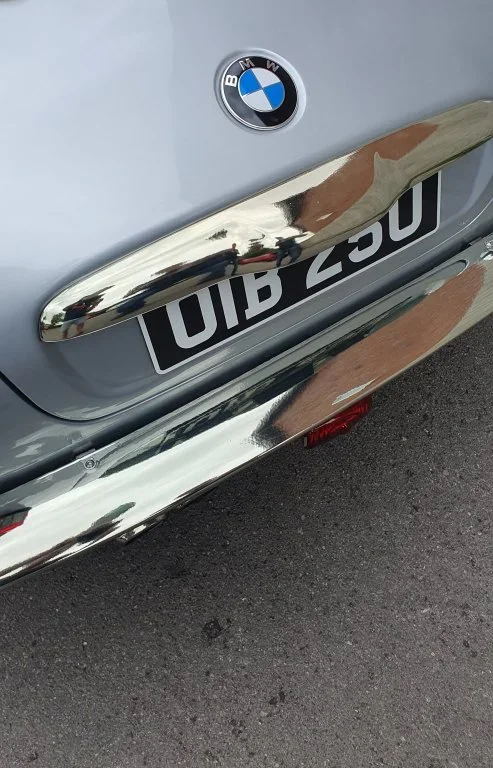

Nice to see your bumpers are still looking relatively chrome like. Mine appear to be getting worse with every exposure to the sun. Mine now look rose gold in all weathers 😣
Still need to find a solution
10stb
Jun 7, 2019
53
The only job I outsourced 😖 I filled in the 500 on the boot handle and got him to do it at the same time as the bumpers. Maybe I should have left the boot handle as the fiat factory chrome effect.

Yep....he's my better looking younger twin 😂
I looked high and wide. Saw a few 507 plates that were out of the budget I'd set. I could have used my own 10 STB reg number that I have on my van but fancied something different on the zed.
Liked the OIB of Dan's as it looked nice on the plate....loads of numbers to chose from but really liked the 250......I know it's a ferrari number.
So bottom line is Dan was the shepherd and I was the sheep.
I've got my legal plates in the boot of the car. Had them in the boot for the mot and the tester all was fine 🙂
