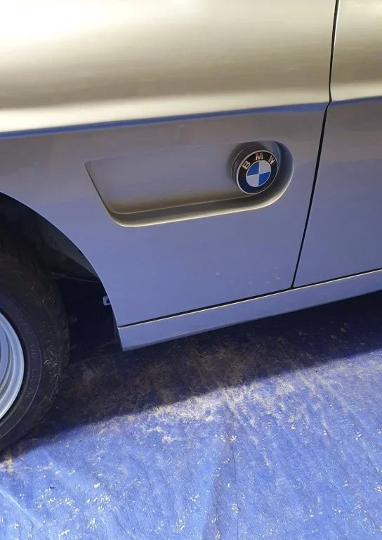

I chopped a bit of alu out of the old front bumper.
See this
https://zroadster.org/threads/oh-no-its-not-another-507-rebody-oh-yes-it-is.66257/post-869687
I haven't done the side bits yet. I'll do those in alu too.
BTW. My bulge is about 13mm high and 25cm back from the bonnet shut line.
How did you do your side gills?
My side grills are a work in progress at the moment.
I've created pockets in the wheel arch similar in style to the originals.
I'm using clear bmw z4 side indicators with orange bulbs. I keep to-ing and fro-ing with the bright work for the side grill. I tried plate stainless steel but struggled to get the look I was hoping for so have gone back to the drawing board.
Really enjoyed reading your thread.
Great work 👏
Great work 👏

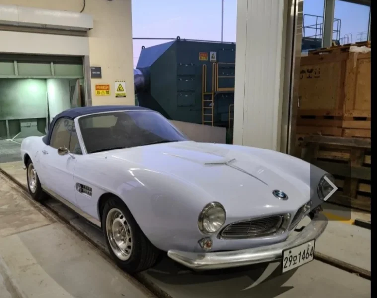

Is this a tribute kit.....or something else Park Jong Hiuk. Dimensions look really good.
He'a doing a grand job. It's a bit different to our tribute kits because the z3 bonnet and boot are still under there. The shape is all chiseled out of foam to make the grp moulds in situ.
See his very interesting build thread here.
Thanks Ian, I'll take a look.
Really like your bonnet mould concept. Going to have a look at my old front bumper at the weekend.
I'd be really interested to see how you're planning to do the bumpers if you're not planning to go down the Vietnamese bumper route.
All the mods that you've done so far are really nice touches that I wish I'd thought of 😂
