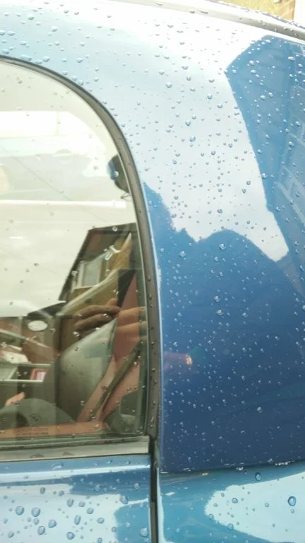

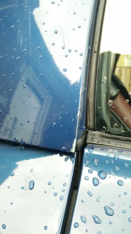

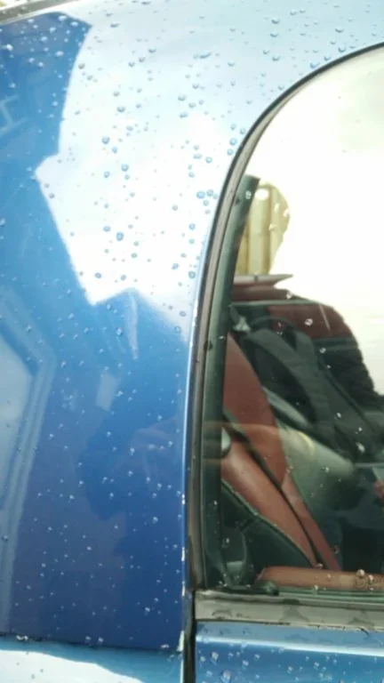

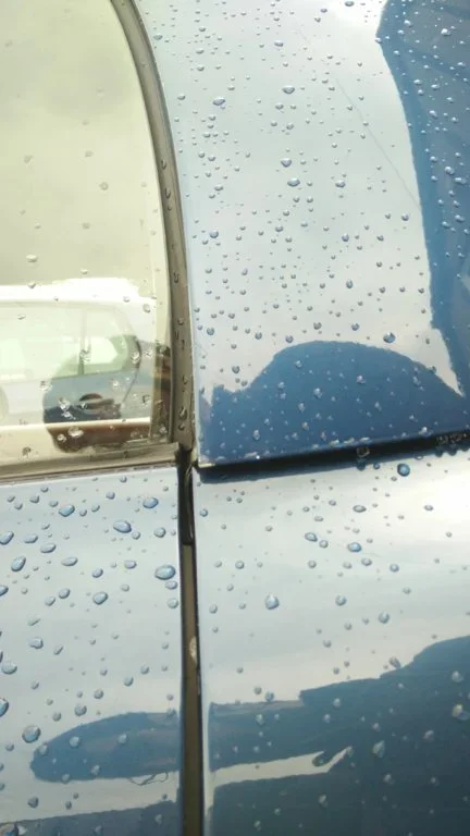

Hi Brian, here are the b pillar pics, I've shot from both sides, however it's only the passenger side that's leaking under heavy rain.
if its not alignment then the more i think of it, it seems the rubber bung @hard top was referring to is becoming saturated and letting in the drips (but that's just a guess before the rain stops and i can work on it!

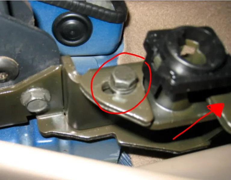

Thanks for the pics, not as bad as I thought at the B pillars, there is adjustment in the bracket at the front of the HT, this may help.

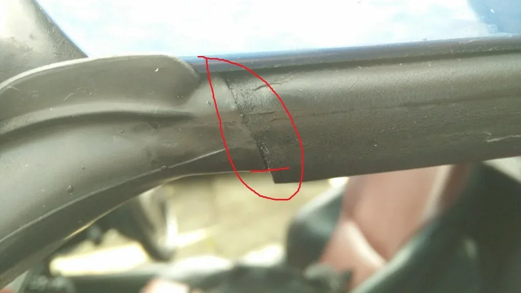

I spent hours and days over the adjusting procedure after fitting the hardtop on my z3 and you do have plenty of information on this thread to go through and see if you can make it better.
Although I can't be the only person that seen the non aligned seal? Am I?
See the attached picture and you can see on your car that they alignments don't match. They need to match bottom with bottom.
Hope that helps. If it makes you feel better I have leaks with the hardtop that I didn't have with the soft top ahaha.

Thanks guys, I found a lot of adjustment in the bracket so have tried that first
And you will have loads of adjustment on the male pin on the Hardtop as well.
