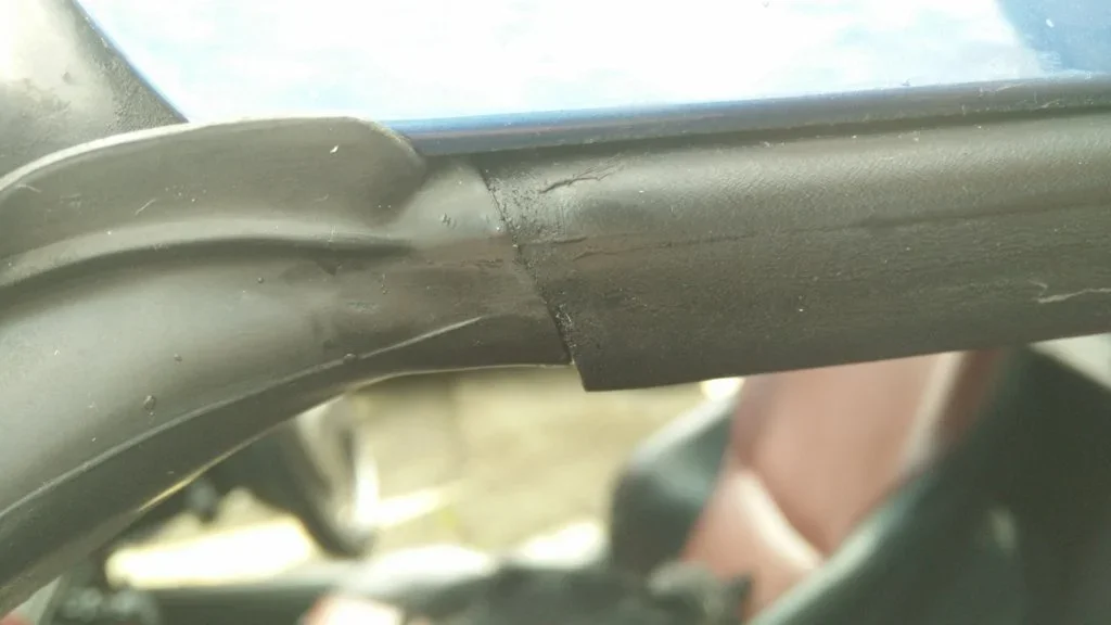

I have a quick question, I've recently added a hardtop to the Z, driver side seals well all-around but under heavy rain the point where the passenger side rubber and the a pillar rubber meet had a slow drip dropping onto the seat! The floor is dry and the seals look like they're joint well, the only thing I noticed was that a little water was sitting at that point on top of the window (driver side doesn't show any of that).
Soft top has been water tight for 10+ years but the hardtop isn't behaving.
Any suggestions or ideal products would be gratefully received, before I start silicone coating/ glueing things... o_O

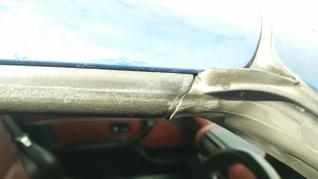

And one of the drivers side good seal.
What would you suggest? I've treated the seals last week with a sonax rubber care stick but not the flat part of the joint / seal

That's looks quite a good seal so before attaching some rubber tube or silicone to that A pillar area.
I would try more spray on runner care (gunna pledge) especially at the point it looks 'porous'.
You can also move the seal slightly forward - it slides on a runner.
If that fails then a piece of neatly cut tube stuck with black silicone adhesive should do it. Mine had more a gap hence I did added the seals.

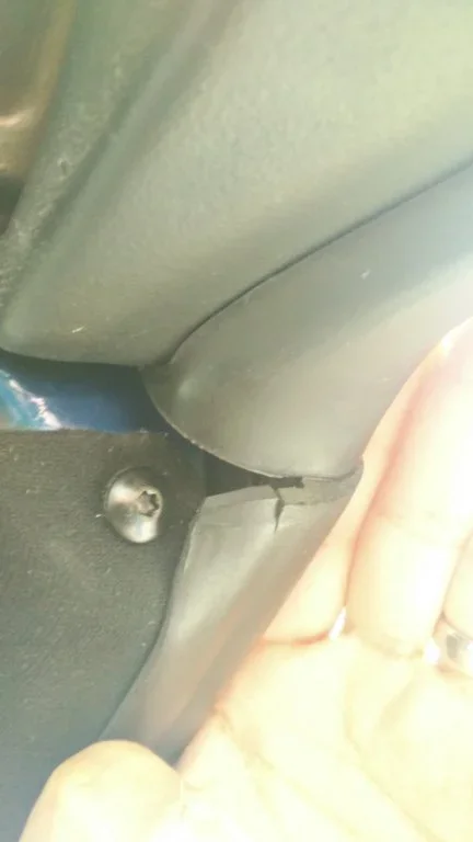

Thanks dino, I did find a split under it but its on the interior and separate from the seal. Is this a concern?
Is the seal that moves on the a pillar or the hardtop (guessing the top) :whistle:

Sorry when I said the seal slides I meant on the soft top rail, can'r remember on the hardtop but I think it's all on piece and bonded to to the top so no adjustments.
In that cars I'd try some rubber tube on the car side of the A pillar to make a tighter seal.
You can also try aligning the hardtop which is the correct way to go about it but you need an extra pair of hands and bit of patience to keep adjusting each side ( the rear mountings) until it's sits right.
You could also sit in the car and have someone hose it down and see exactly where it's coming in as sometimes it drips in a different place from where it actually comes in.

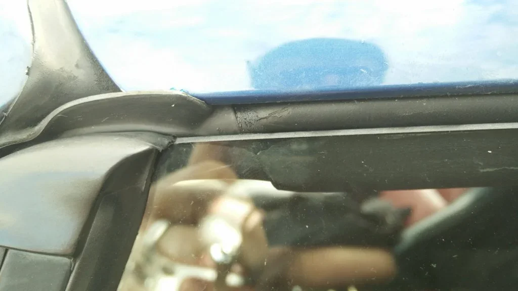

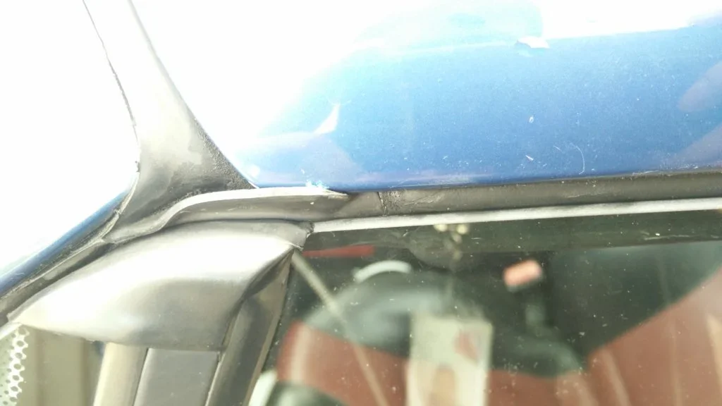

Hi @Ianmc, yeah i looked into that but the rear mounts are going on easily (with a little expected pressure) and the top is sitting flush with the interior.
What i can see is the hardtop seal ends lower than the a pillar on the passenger side but flush with the driver side (passenger side is the issue,
Front bolts are tight and hood looks flush on both sides.

Looks to me as if the roof needs a little fettling in to position, can you take a picture of the hardtop where it sits on the body of the car (where a normal B pillar would be?) I get the impression that the hart top is slightly askew.
