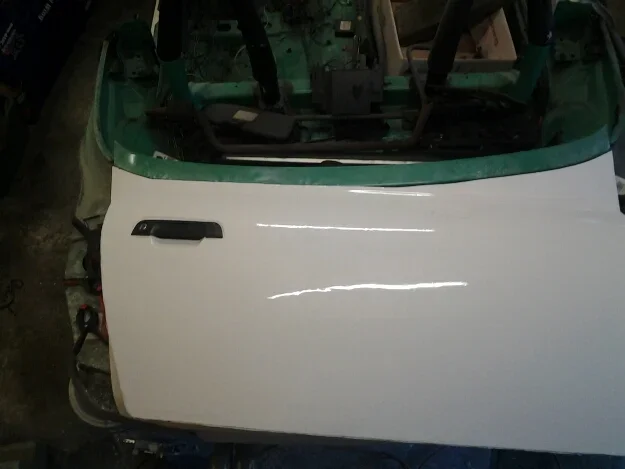

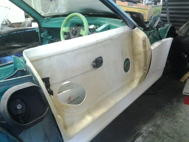

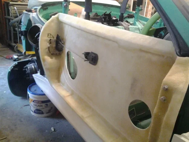

Had a couple of hours todat, so fitted the inside of the drivers door. And fitted the lock to the outside.
Not as easy as i thought it would be...
And some pictures...because without pictures it didn't happen
