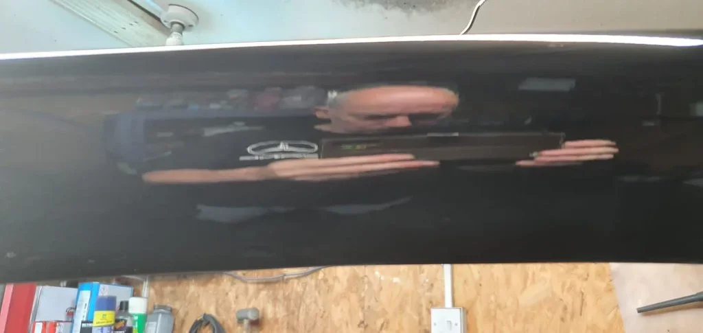

The bumpers and grilles are being painted as we speak
Hope this helps
Dan
This is a reflection in the bumper paint. I’m sure it will be better in the sunshine

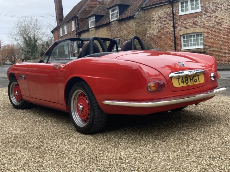

@Dxbolton When I get the tribute 507 back end on is it going to look weird with the arches quite a bit wider than the wheels?
I don't really fancy spacers. Might go for deep dish wheels but would wide body trailing arms be a an idea? Or would anything else need changing too? (As well as wide body inner splash guard things.)
@Duncodin i used bmw winter steels that are slightly deeper dish than standard.
The fitment looks perfect to me without spacers
I don’t think the suspension is any different between narrow and wide body, @t-tony can probably confirm this
The part numbers of the trailing arms on a 1999 1.9 narrow body isn't the same as a 1999 2.8 (widebody?) So I assumed the narrow body trailing arms placed the hub a little further in on the narrow body compared to the later (wide body)
IIRC the narrow body rear beam is narrower but all others are the same except ///M models. Andy @spurs fan in a coupe may have better info.
