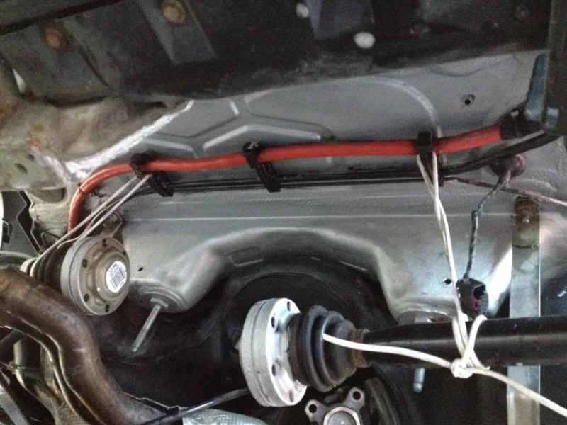

So i started taking out the diff. And what was supposed to be a weekends work took 6 weeks!!!
Diff and axle carrier out
Diff separated and new LSD unit
So you use all the original gears and just bolt it back in. You have to check backlash with a DTI nad gear mesh with engineers blue. Mine bolted back in and was perfect first time. There are no shims and as far as i can tell no way of adjusting it. But it needs to be checked. Mine was better and well withing BMW limits. The second time...... I was sent the wrong diff first of all and it just did not work. As you can see there is something wrong. The hight of the flange the gear sits on is too high by about 12mm
But they sent me a new one and all was well.
Then i was looking at the underside of my car and all the bits that cam off and i could not install it all back the way it was.
So out came the paint and i ordered all new bushes for the rear end.

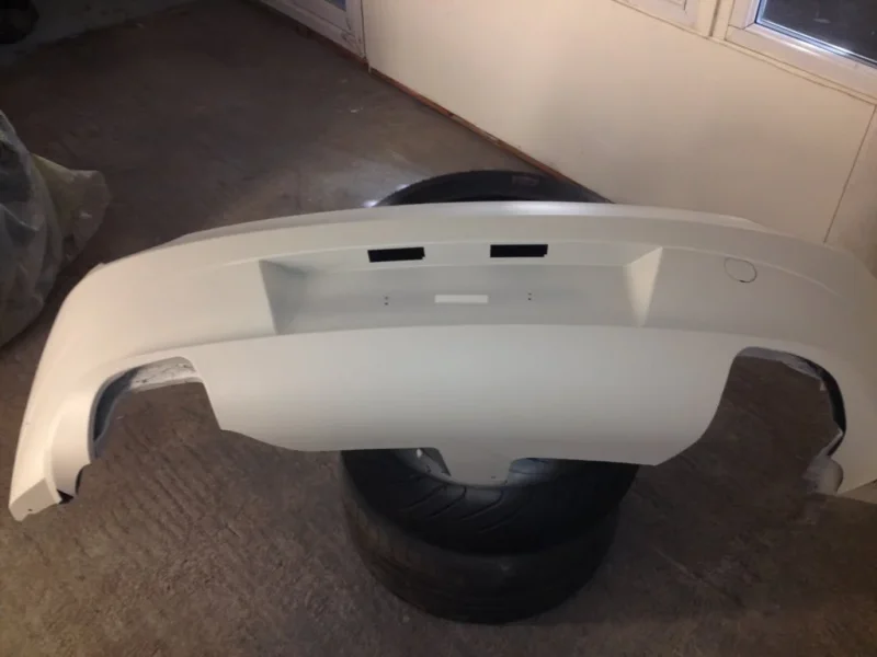

So the car looked great apart from the bumper and all the flat surfaces like the bonnet and bumper. My car was becoming famous for having bad paint!! And i didn't really like that :( So having a chat with Chris we decided we would paint my car. Why not everything else has been a DIY effort. But i knew i wouldn't be happy with flys and dust stuck in the paint. Chris had done a bit of painting. And we had a good compresor. And we had a decent spray gun. I did some work for a guy on the other z forum. And he had some surplus air filtration equipment. So we had all we needed apart from a spray booth. Spray booths are expensive so I needed a plan...................Much thinking well not that much actually! I had an idea????????
We had a big workshop. I had a friend who works in the plastic business supplying polythene and such like. All i needed was some timber and a conservatory. After bidding up to the dizzy heights of £60 owing my mate a favor and buying £150 worth of timber and screws i had the makings of a spray booth
By now it was Christmas and to cold to spray. So i decorated the house light a fire and put my dog in a Christmas jumper and drank and ate too much.
So i had an idea that spraying my car would take a while...... So i was in no hurry to start. That and the fact i had a few track days booked in spring early summer. So i didn't start until June 2015 It was going to be a quick rub down and re spray silver. But............. it had been painted before in places really badly and had a fair bit of filler (that was not needed as i rubbed most of it out and got smooth panels??) At witch point i was thinking I didn't want a silver car anymore. But what colour I have always loved Imola on the z4m. But my wife has a red car and she said I couldn't have a red one!! :(
I was at BMW finally replacing the broken bumper clip. Well i couldn't hold it on with gaffer tape after it had been sprayed could i. I was stood in the parts department and went and looked at the bikes. And a few of them had this bright amazing blue on the frames. And i knew that was going to be the coulor of my car. So i got the code and then went to get as close as i could but not metallic. Why not metallic i hear you all shout???? I do a few track days and want to do more drifting. It will get scraped damaged at times and non metallic paint is easier for an novice like me to match. And all the body parts on the old z4 bolt on and off. Se that clever :thumbsup:Plus shined up it still looks great.
So strip down and sanding. Sanding a car is not for the faint hearted. Hard work mixed with the feeling of what the hell have i done to my car!!
Finally in the booth after weeks of sanding.
Lots of masking up
Base coats should have got some extraction sorted.....
Bumpers and other bits. I did forget to do the mirrors :mad:
Nearly there so i thought.
After that we left the paint to cure and then set about wet sanding........... I was scared and emotional at this point.
Now there was a little twist in the story. I had help that didn't go as planed and this is actually after its 2nd respray. I wont go in to too many details as its a rubbish story. I was given advice and help that didn't work out. So Chris and i re did it. But it turned out ok. Until i tried using a DA and i have to say it no ones fault but mine. But if you did see my car at zed fest. You may have noticed all the little white lines and bits on creases. Well taht was me polishing through my paint :(:(:(:(:( So it dose need some more work. But from 10 feet away it look's bloody great :);)
