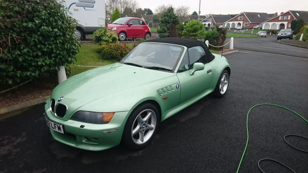

As promised, here's a walkaround vid of the car after a quick wash the day after we collected...

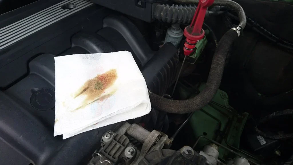

Before getting going, I wanted to check the oil and coolant levels. I knew the car was so good when I viewed it that I think i skipped some of the basic checks. I just wanted to get it away from the previous owner before he trebled the price!
Anyway, i needn't have had any concern.
Coolant was a touch low, but check out the oil I removed from the dipstick!!

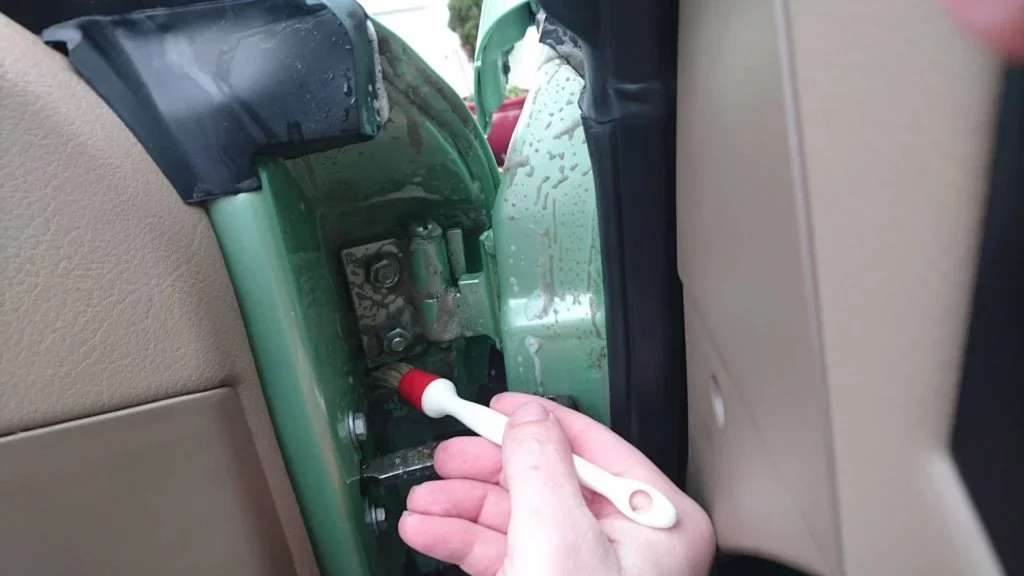

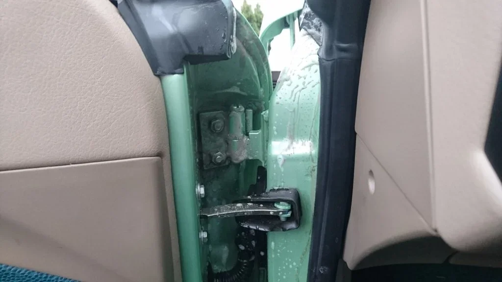

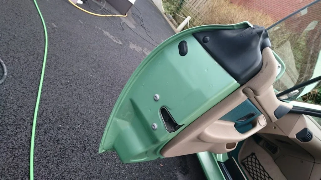

We mainly focused on the door and boot shuts and removing any tar from around the wheel arches and sills.

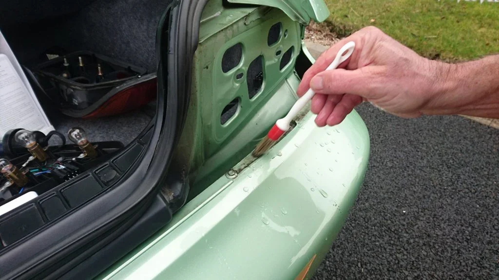

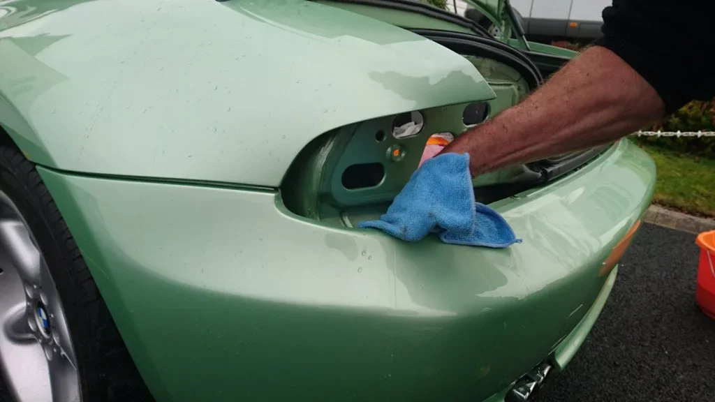

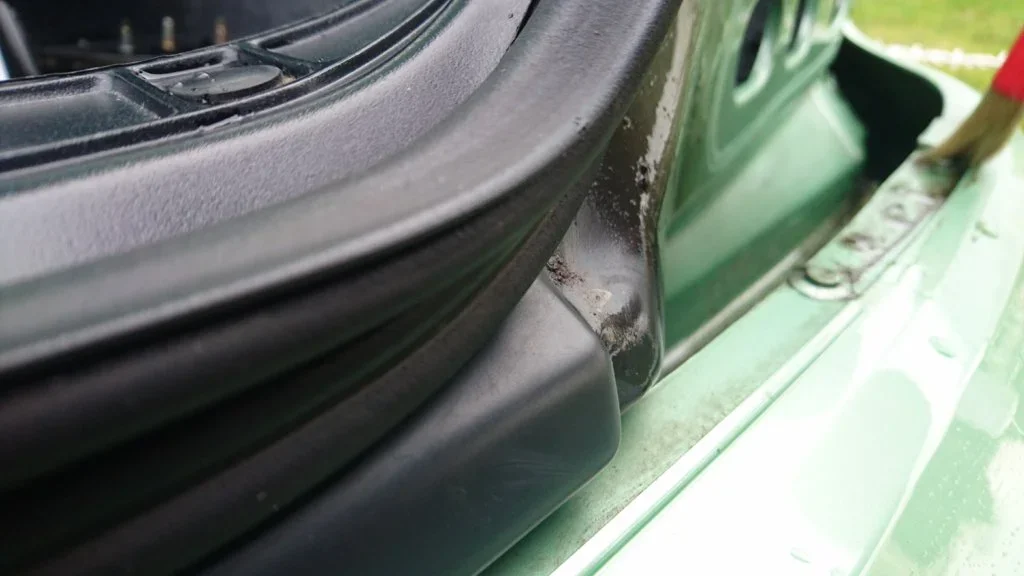

Then, much to my dads surprise, i told him to pop the rear lights out...
Well you cant have dirt behind your lights, can you?

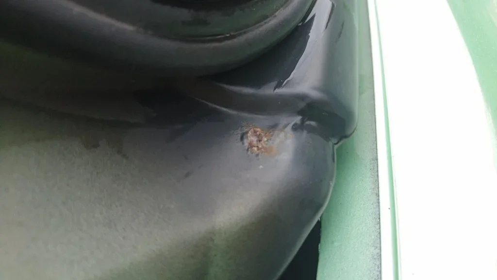

We even found some corrosion under them!
Nothing too bad so we've hit it with some rust converter and a layer of wax to stop it dead and weatherproof it until we've time for a proper fix.
Up front, I degreased the doors hinges and some bits around the engine bay.

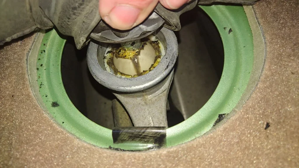

Also took the chance to have a look at the shifter bush. I have a sticky 5th gear and whilst I know the proper fix is in the gearbox, a damaged bush could make it worse. Fortunately (Unfortunately ??) the bush was fine!
View attachment 48543 View attachment 48545

Looking good, nothing dramatic going on there :thumbsup:
That was like an inspection vid - a very good walk around view of the car - nothing too problematic to put right - probably the small stone chips and paint marks would be the most challenging and most expensive depending on your - your Dad's intentions with respect to spend - good luck with the project!
Looks like it has nothing worse than the usual stuff you'd expect on Zed of it's age! Will be looking forward to seeing it progress back to top condition again...
Looking pretty clean, was that a bit or corrosion on the bottom of the right rear of the outer sill? Didn't look too bad if it is. You did well with the purchase for sure! Onward to fixing all those small items, JIM

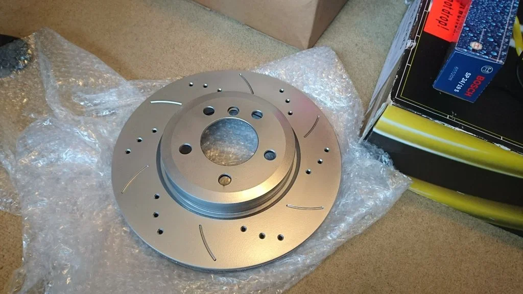

You need e46 330 M Sport (petrol or diesel) calipers, carriers, disks and pads and should bolt on with out any issue.
Need 17 inch wheels and even some of those may have issues if they're a funny shape or have wheel weights in the way of the caliper rotating, but i'm told BMW OEM 17" rims are fine. Will find out soon!
Anyway, I got the carriers out of a scrap yard, then bought reconditioned calipers from Brakes International for £65/side. Could have got a used pair recon'd for £15 cheaper, but used calipers would have cost more than £15 as i'd got the carriers already! Rears will be getting blasted with fresh seals too. Maybe a piston if they need it.
Then fresh slotted/drilled disks and pads from Mtec.
All in, i've brand new brakes 325mm front / standard size rear all round for under £350...
Prob should fit some braided hoses too, but that's another £120 from HEL...
I ordered some HELs today from Dag Hose Supplies, not to dear either.
