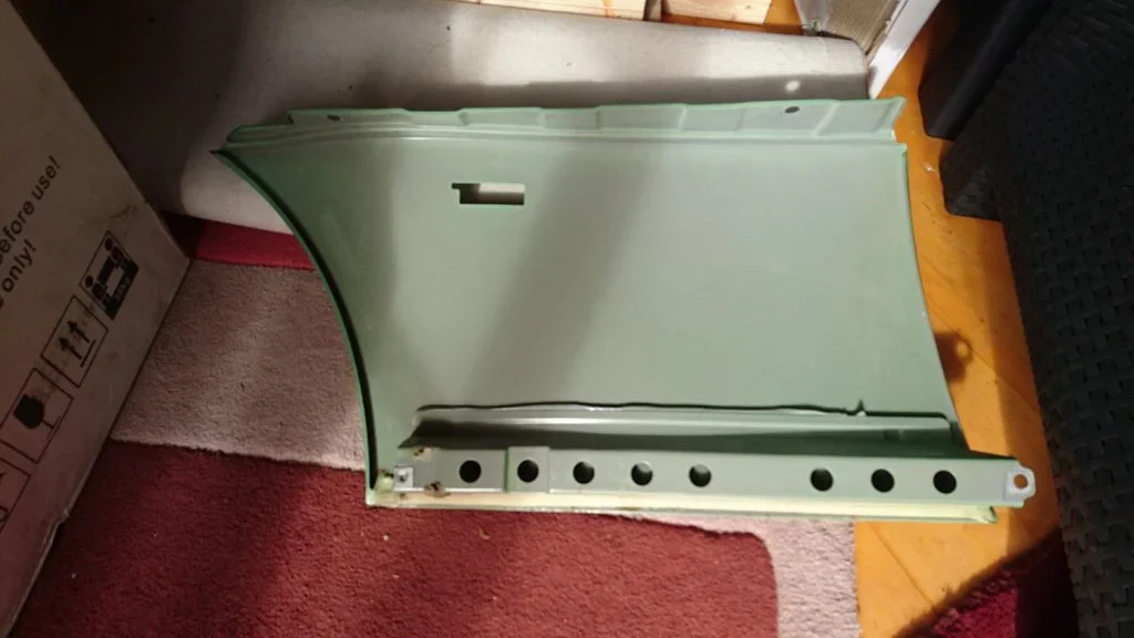

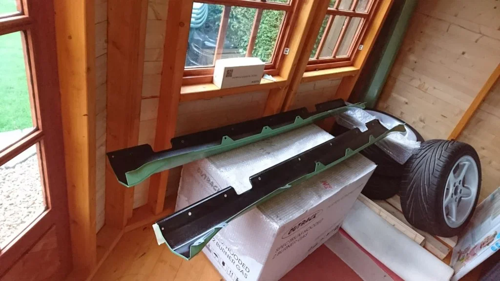

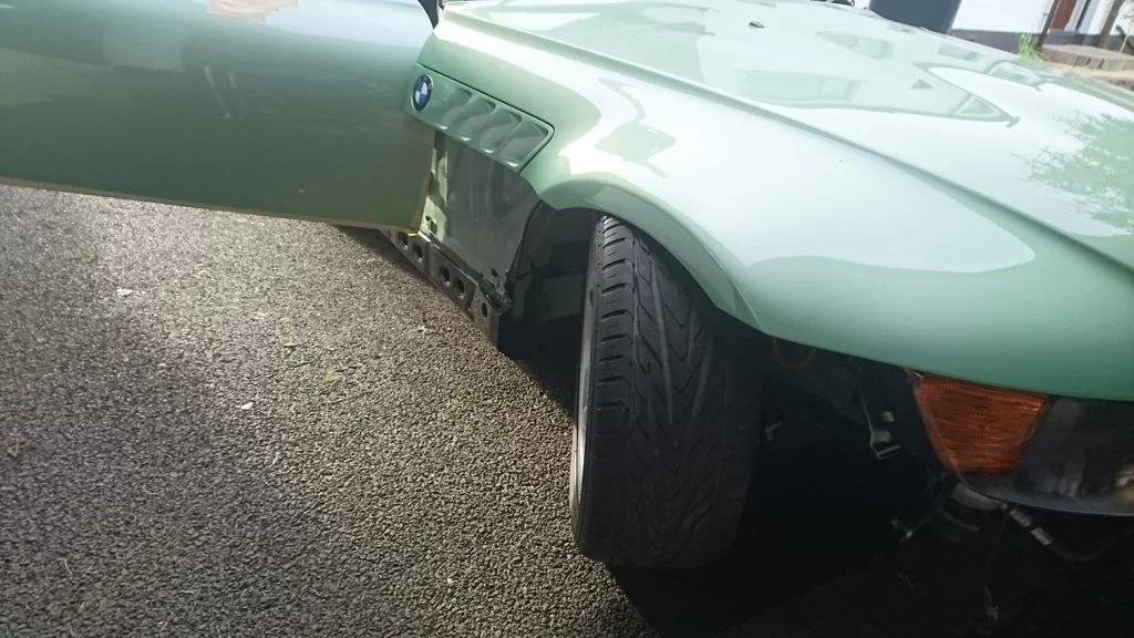

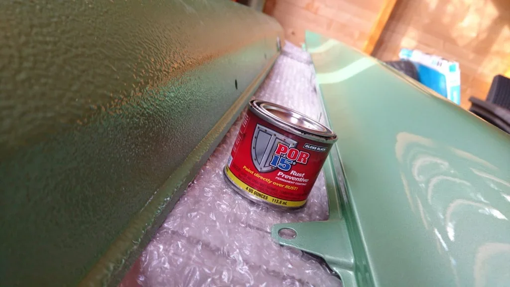

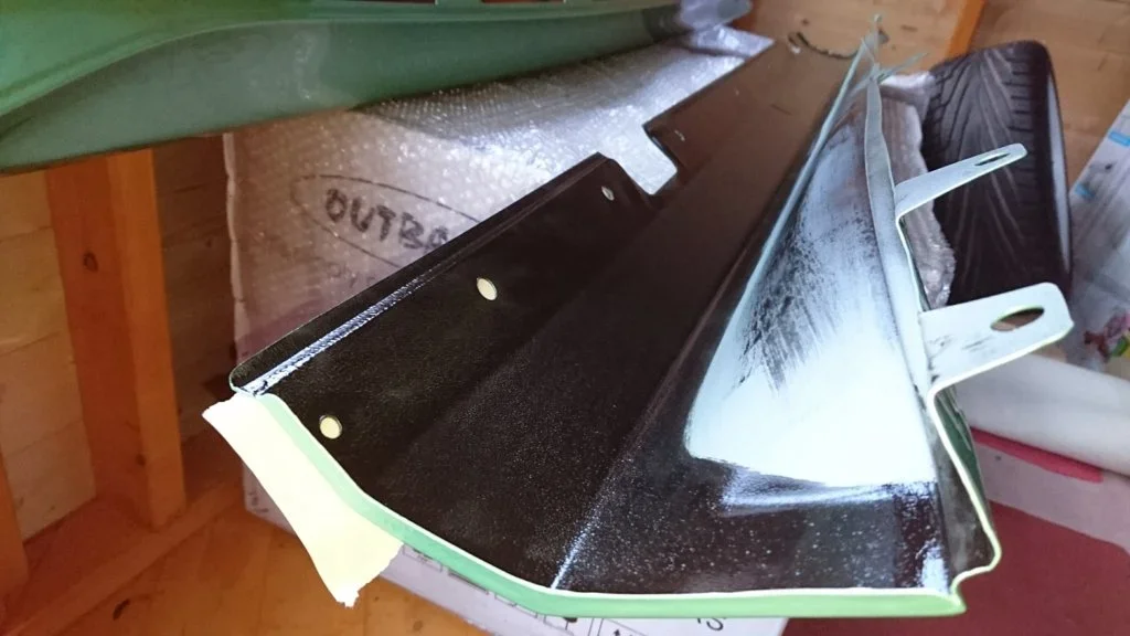

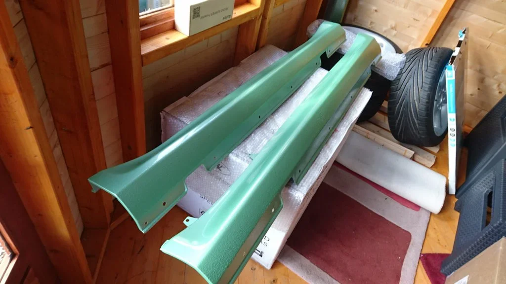

Got the sills back, freshly painted.
Paint looks great and colour fine beside the old sills so confident they'll look great on the car.

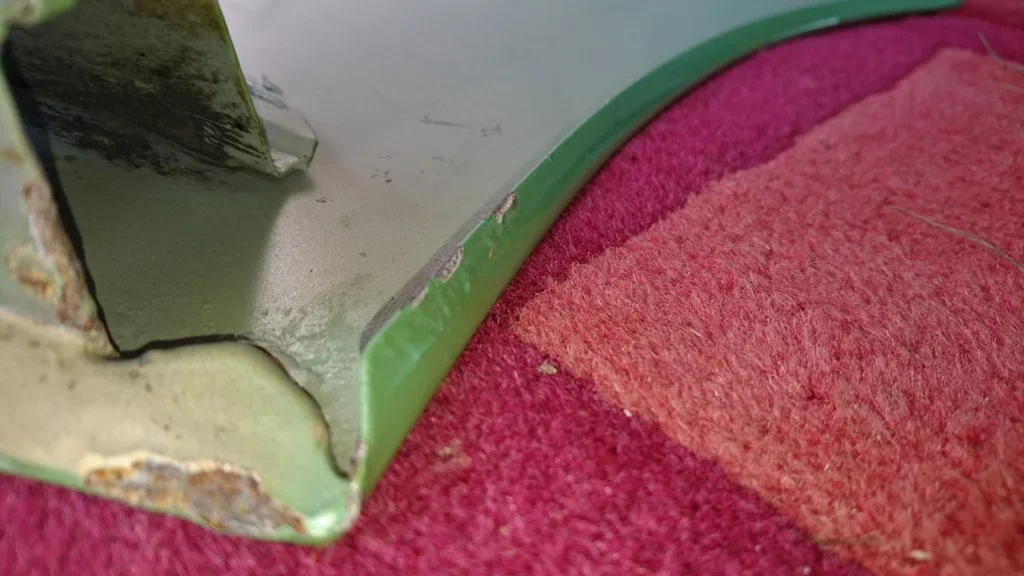

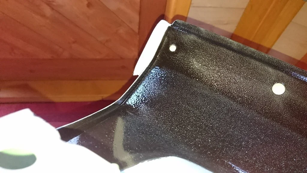

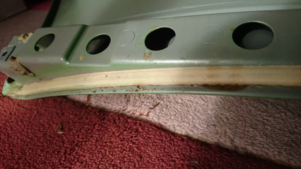

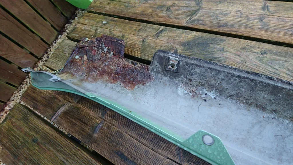

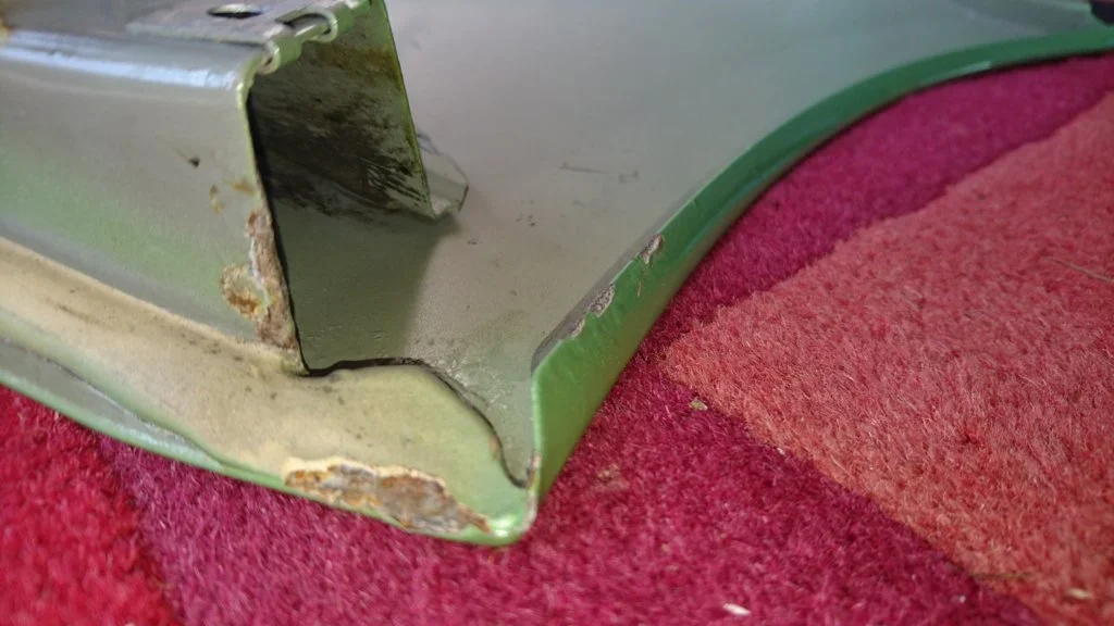

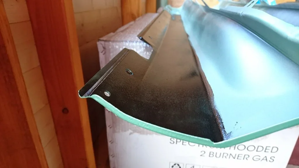

Anyway since the old ones look like something from the bottom of the sea, I decided to treat the back to some por15 just like the inner sills on the car.

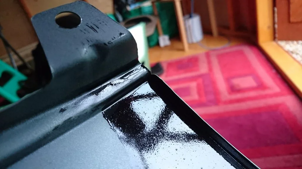

First coat going on..
I took the time to get right into the corners where dirt will likely gather and the rust would set in.
It was dark by the time i did the second coat, so no pics, but at least now i'm confident they'll never look like this in the future...

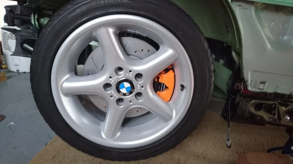

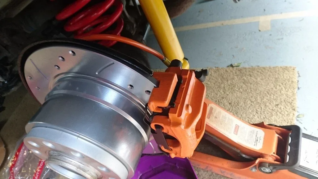

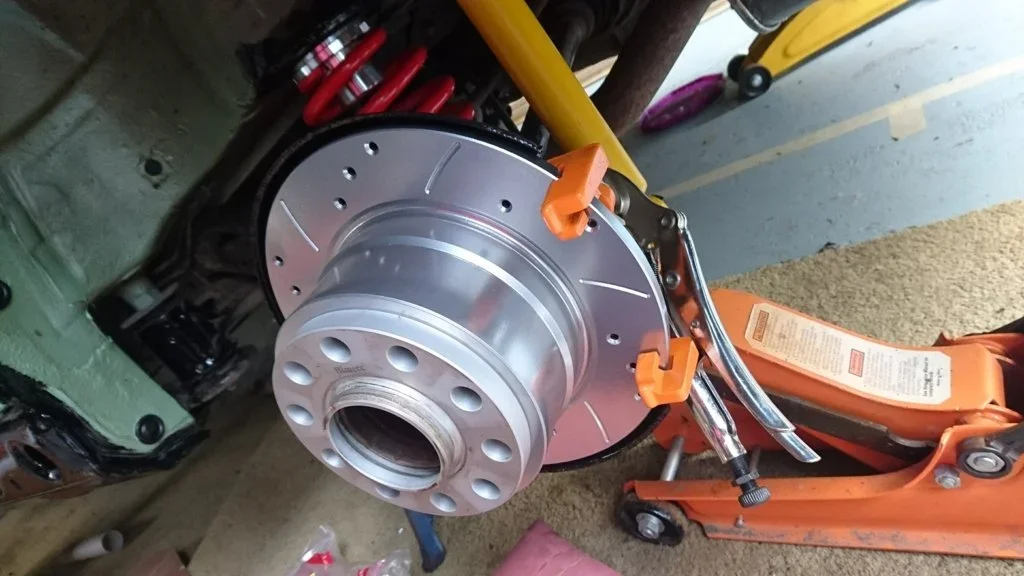

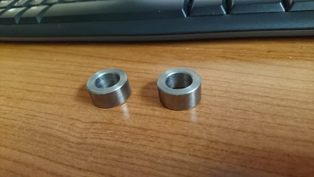

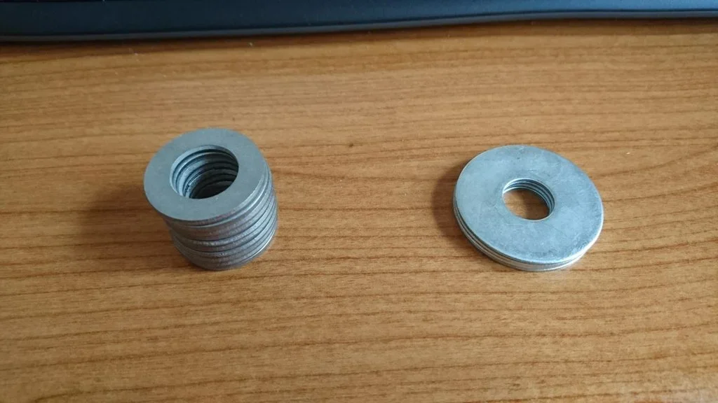

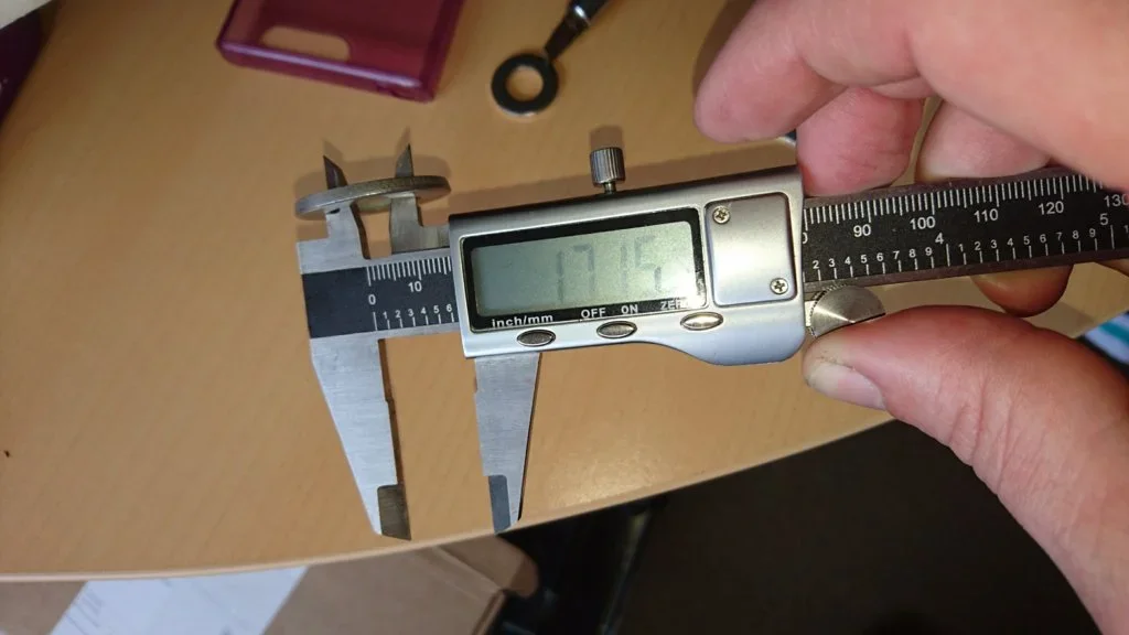

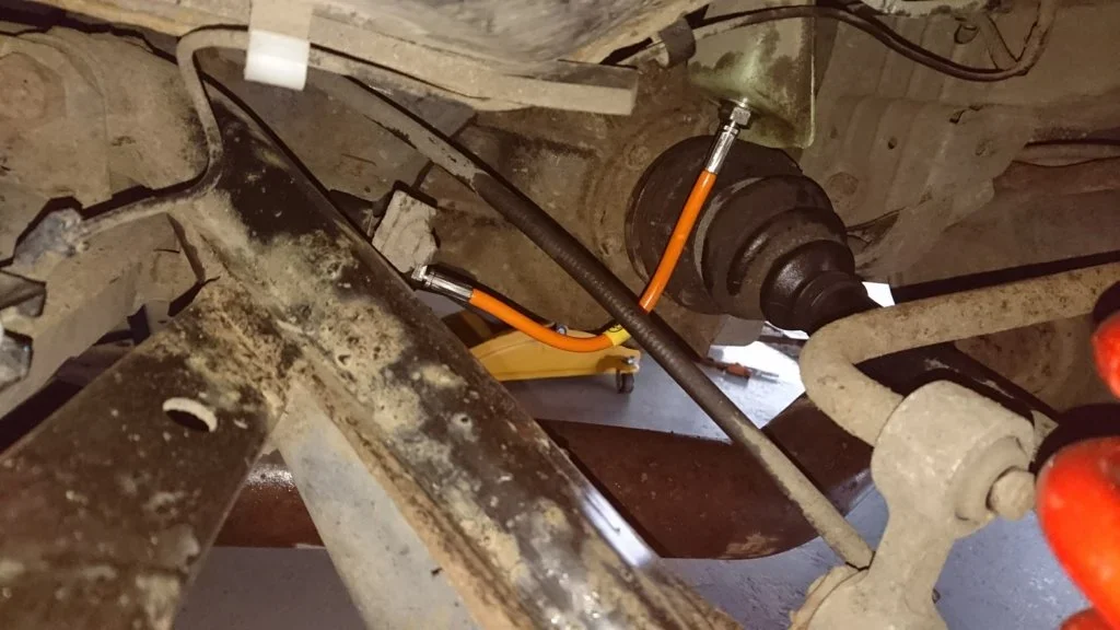

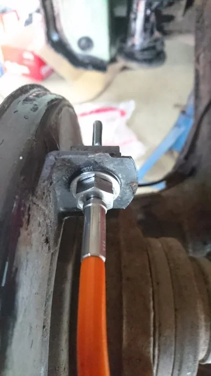

That's all for now. Still haven't got the rear brakes on yet. I've been trying to find a 14mm washer to ensure the HEL brake lines don't pass through the hose mounting brackets, but seemingly a hard thing to get hold of.
Homebase, Screwfix, Halfords.... nope...
Up front, I had reused two big washers that came off the old suspension components, but there's really no need for such large washers and had only 2, so need another 6 i think....
Might have to resort to ebay and another few days of waiting.
