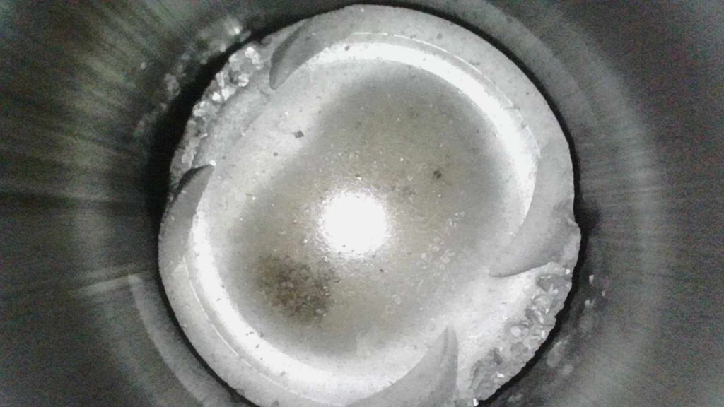

I melted a forged piston.
9.0.1 JEs going in, I have a guy coming Thursday to pull the motor, I have a ton going on, no bandwidth to pull another motor.

I never got over 6lbs, or 5k rpm as it's a new motor.
The tuner thinks it's high intake air temps, he was seeing 160 degrees. Hence lowering the compression.

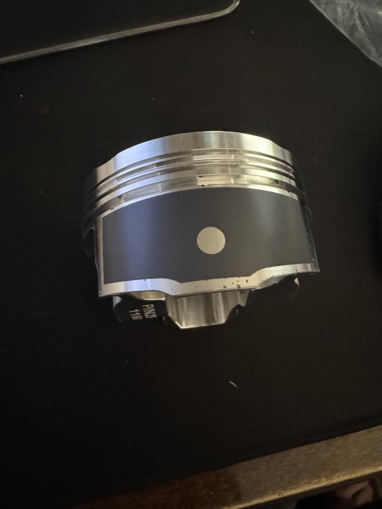

Anyone want a lightly used forged pencil holder?
Here is one of the JE 9.01's in it's burrow.
