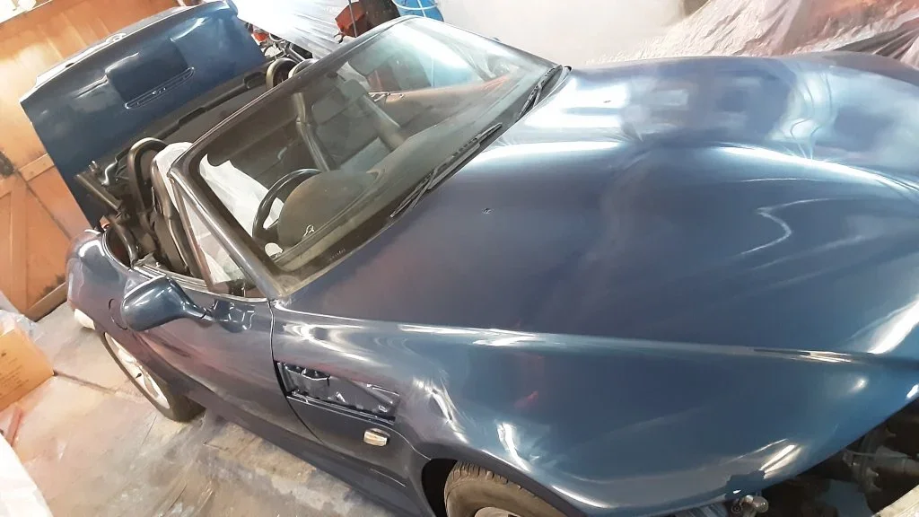

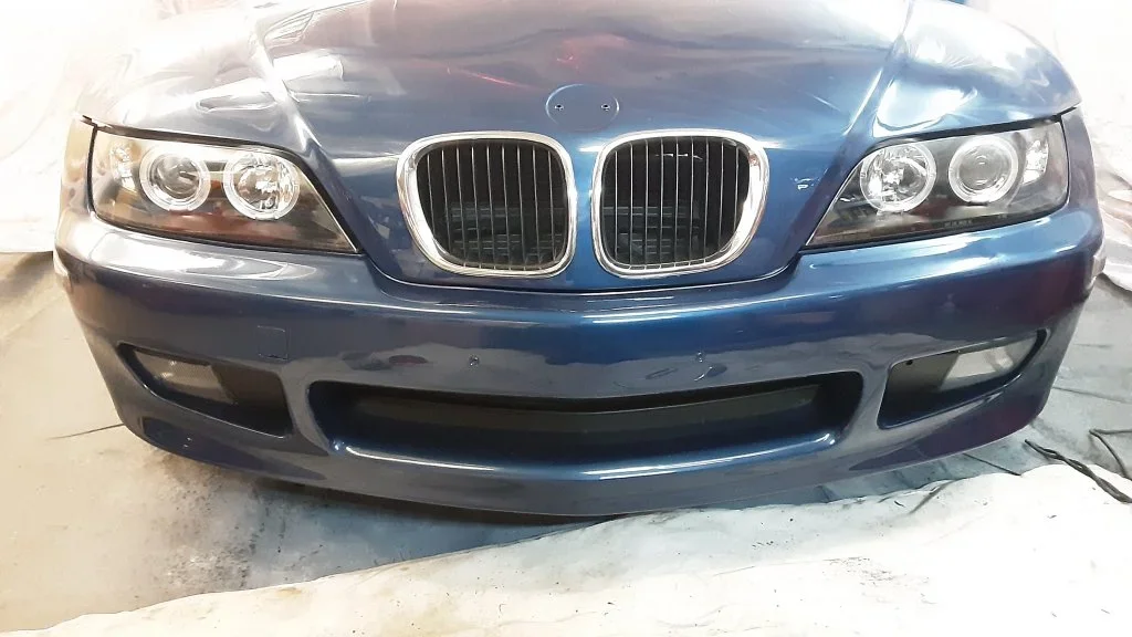

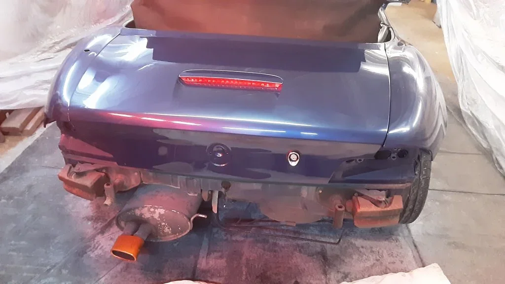

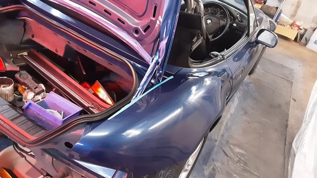

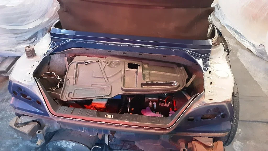

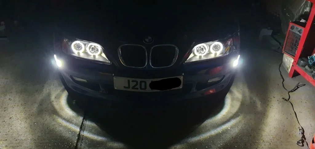

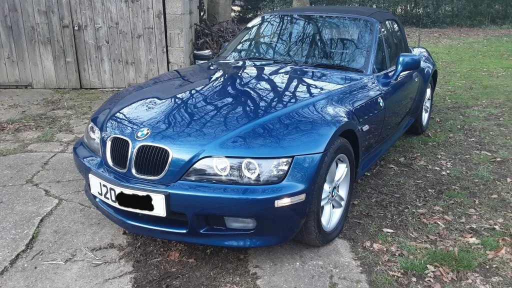

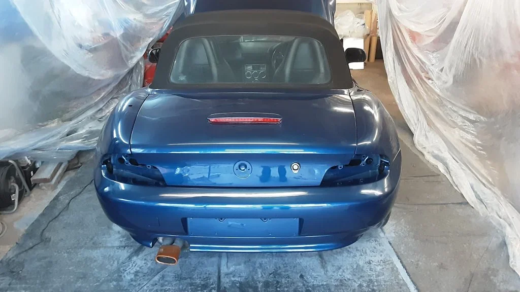

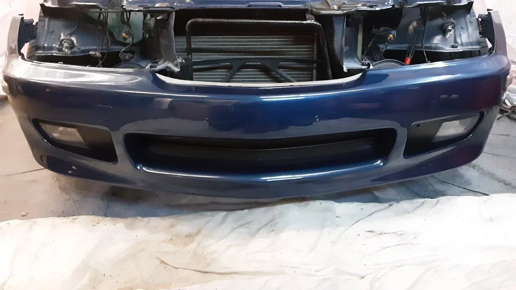

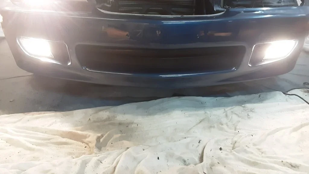

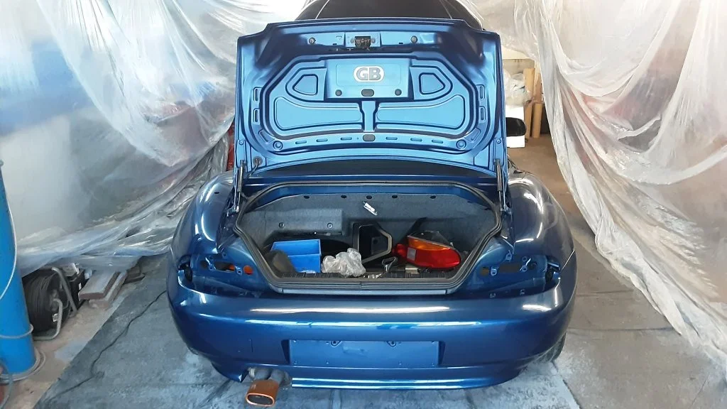

Because these cars are mostly bolt on panels the rebuild was fairly quick although, we had to be careful of the paintwork as it takes a long time to harden fully. Once all panels were back on the car Jason fitted front fog lights & a switch inside the car for these. He also fitted the angel eye headlights that I had purchased, really helpful post found on here to help with that and fitted the clear side repeater lenses & one replacement side light lens as the original had some crazing.
We purchased new BMW badges & replaced all of the ones that were on the car with these (except the 'Z3' which is the original). Jason gave all the wheels a good clean & once back on the car he replaced all the centre BMW badges with shiny new ones. Number plate holder & new number plates were also fitted.
A few pictures below at different stages:
Ready for & during rebuild
Fog lights fitted & lit
Angel Eye Headlights fitted

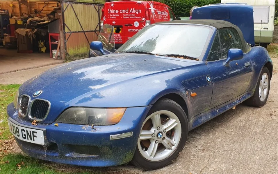

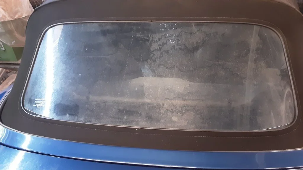

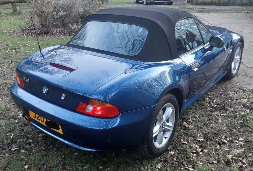

Just a quick post about the hood. The hood had been replaced at some point in the last 10 years so was in good condition but having been stood up for 2.5 years outside uncovered it was rather green & the rear window was milky & had some light scratches. Jason pressure washed & agitated the material with a stiff brush and steam cleaned the hood, this has got rid of the majority of the green but there are still the odd patches which will be dealt with come the warmer weather. The rear window was wet sanded with 3000 grit on a 75mm rotary polisher. A random orbital polisher was then used to compound & polish the window both inside & out.
Before
After

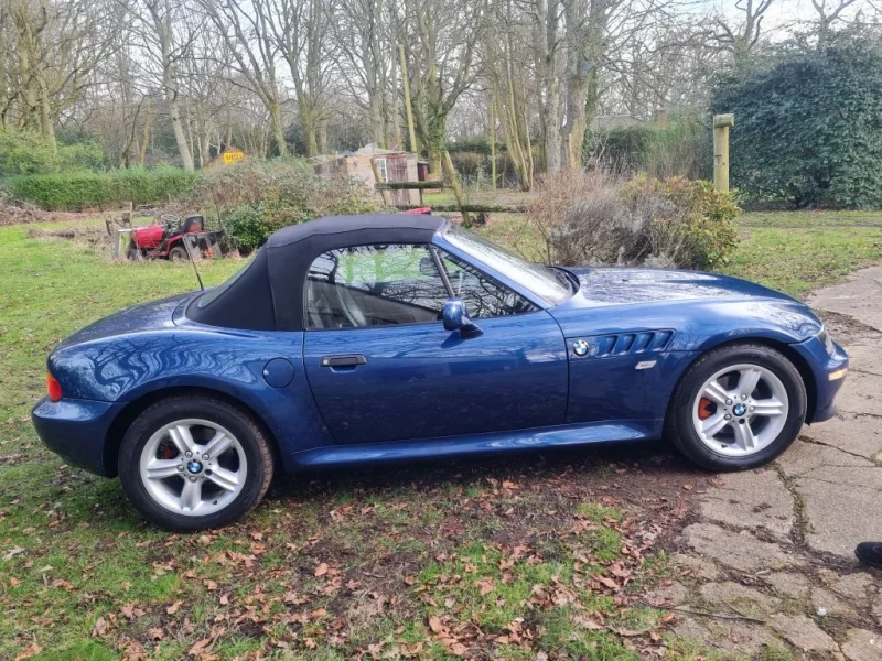

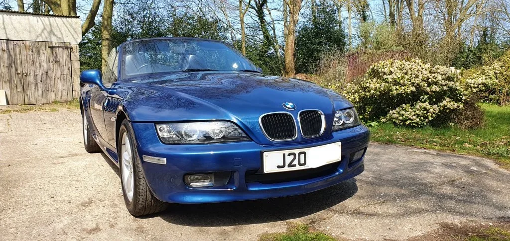

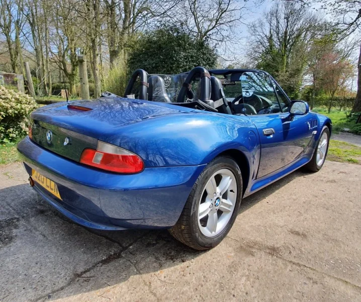

Good evening everyone, I have been looking forward to writing this post since we started the project in September 2020. Last weekend we had a nice day weather wise so gave the zed a clean & had a 'topping out' ceremony by adding the final touch... the new front badge on the bonnet. I am going to have the paintwork protected however, the fresh paint still needs time to vent & harden so this will be done in March. This is also when I will get the car MOT'd (fingers crossed for a straight pass) ready for putting on the road in April. I have a daily runner so the zed will be used mainly for fun spring/summer days :)
Below are some pictures of my finished zed, I am really pleased with the result & hope you all like too:
Before
After

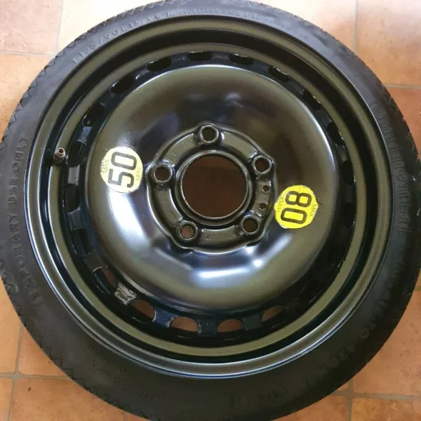

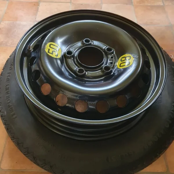

Today I am taking the spare wheel to our local Wilco's in Norwich to have the tyre put back on. The spare wheel was severely rusty so Jason has rubbed it down, rust treated & repainted it in a black base coat & semi gloss lacquer. It looks so much better and is another step forward in getting the Zed on the road :)

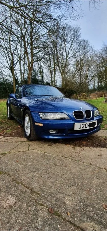

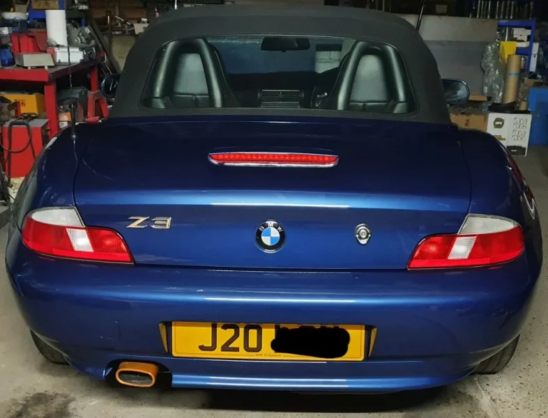

Jason fitted the clear rear lights, it should have been a simple change but for some reason the bulb holder wasn't the same fitment as the old amber set however, these were easily swapped over & chrome bulbs installed. I think that the clear rear lights look great & it has meant that the 'clear' theme now flows from front to back.
Next job was to swap the bulbs in the side lights for led's, the more yellow light wasnt complimenting the halo's of the angel eyes so led's were the answer! These are now much brighter & look great 🤩

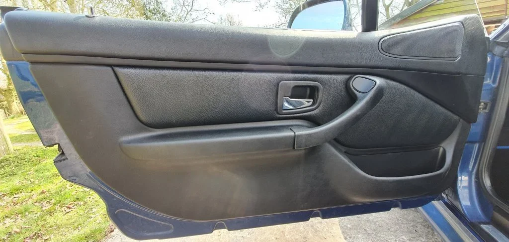

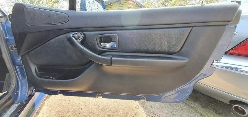

On to the interior & Jason fitted my new to me immaculate door cards, courtesy of & big thanks to @Mario for these :thumbsup: They look fantastic & have really lifted the interior of car 😀

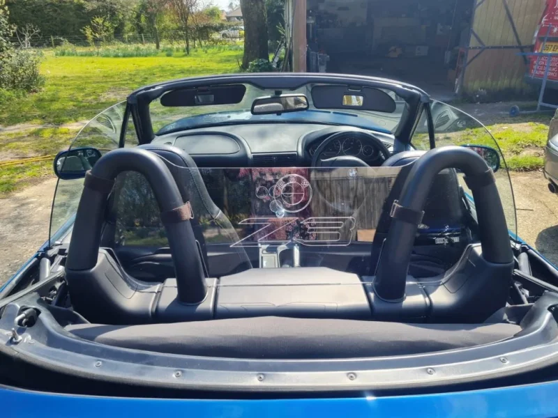

Last but not least yesterday we put the hood down & attached the wind deflector to the roll hoops. I considered an OEM one (but they are hard to find in good condition) & plain/tinted perspex but eventually I found this on ebay & just loved the etched BMW Z3 logo (I think some other zorg owners have this too so I've joined good company 😊)
