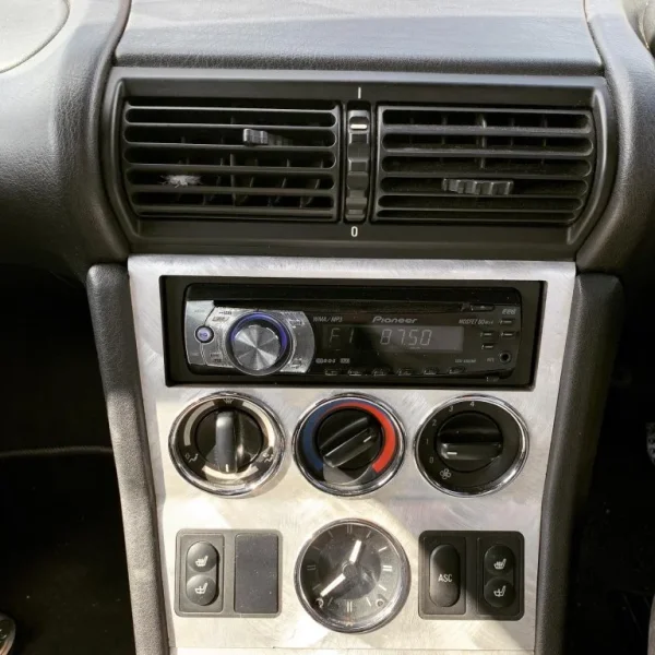

Another surprise was finding out, by applying a microfibre cloth and soapy water, that the steering wheel stitching is in M colours and not black as I initially thought. (That's actually disgusting!). I will need to do something about the brushed aluminium centre console and the tatty Pioneer radio. I'd quite like an OEM radio, but I guess they're not easy to come by. Any suggestions will be much appreciated.

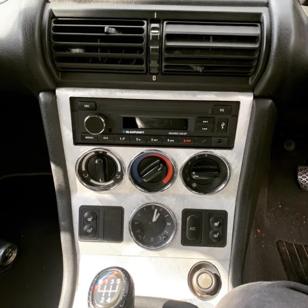

Today I got rid of the horrid aftermarket radio
and replaced it with this Blaupunkt head unit
It's got Bluetooth for streaming music from my phone and it almost looks like it's OEM. Sounds good too...

Nice one mate! That looks great. Was your display VW blue? (It looks like it in the picture) Because mine is black and white, so it’s not too bad as the buttons are all red anyway…
I see you’re listening to SWR3. Excellent!
Wirsing!

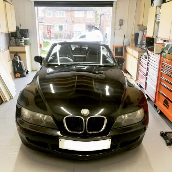

Of course, while the car was up on stands, I was too busy actually doing things to remember to take pictures, but here is one of the car in the garage when we were finished.
Wirsing!
I didn't know that SWR3 was that popular in the UK 😁
My display was black and white too, my smartphone made it appear blue on the picture.

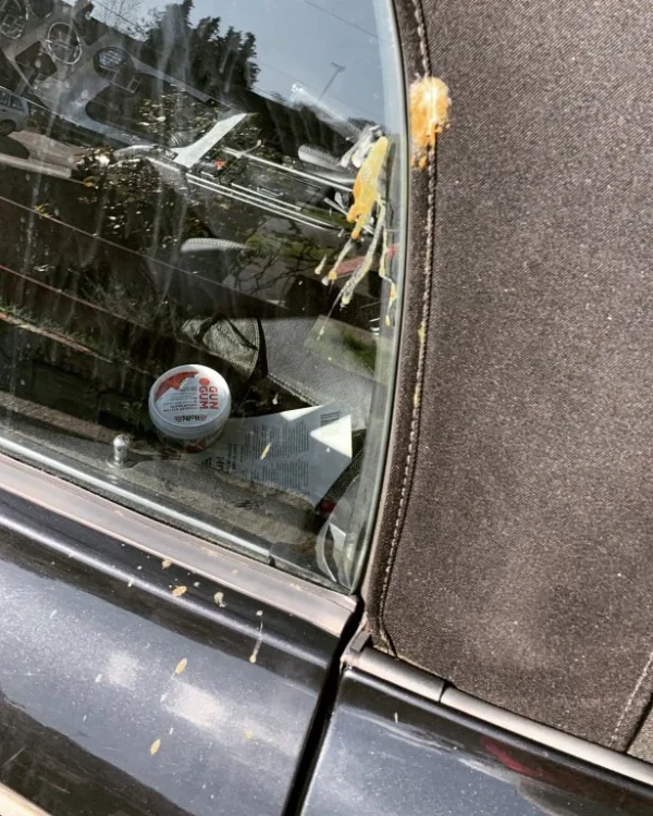

This afternoon, because a 20 year old car inevitably comes with 20 years worth of other people's accumulated dirt, I did a thorough "spring-clean". At the exact moment I thought that the roof had dried out nicely after washing it and picked up the roof protector spray-bottle, this happened:
AAAAARRGGHHH £$&*&^$ BIRD!!!

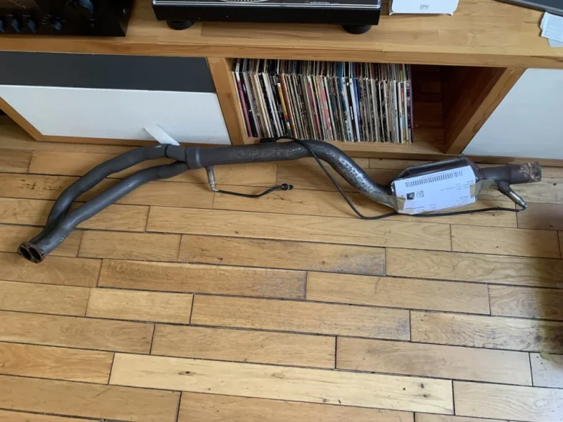

In other news, a bit of a motorway blast, not surprisingly, did it for my exhaust bodge-repair. So I’ve ordered a replacement, used off eBay. See how that goes.

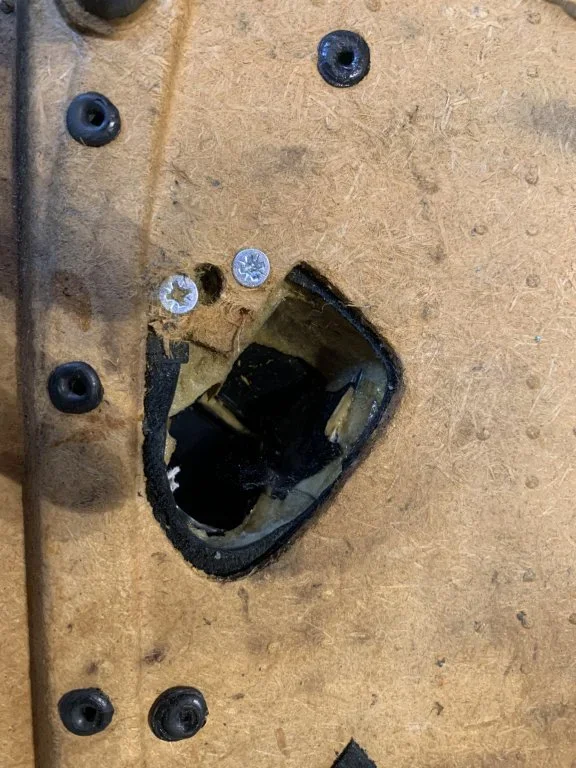

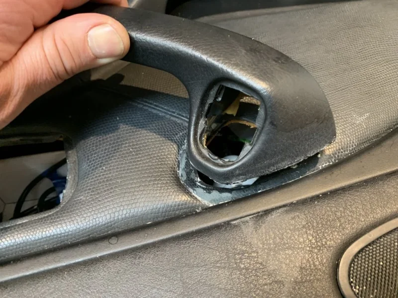

And: Shutting the door earlier today, the door handle came off the door card. Hurrah!
it looks like at some point someone tried to take the door card off and instead of unscrewing it broke the plastic bit instead and just glued it back together.
So I’ve taken the door card off, glued the handle with Mitre Bond onto the door card and then screwed it onto the door card from the back with self tapping screws from the back.
That should hold it in place, hopefully…
During all this, I somehow lost the plastic trim piece around the door handle. So if anybody has got one going spare, I’d be eternally grateful…

The replacement exhaust arrived in the post last week Thursday.

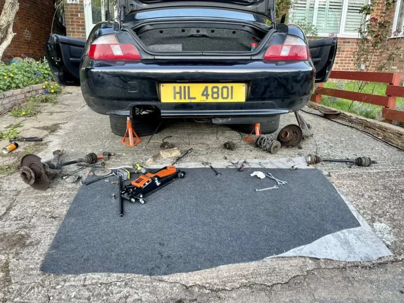

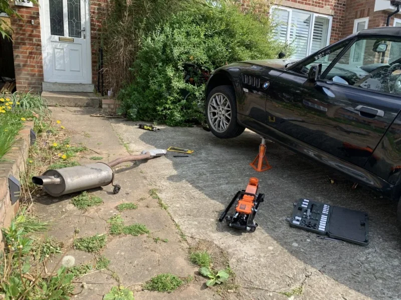

So on Saturday, I had a go at replacing it. Unfortunately I couldn't use the neighbour's garage so had to do it on the drive. Of course I didn't remember to take pictures. Well, I took one:
It was absolutely infuriating. At some point, inevitably, the exhaust bracket that attaches to the back of the gearbox had rusted through and instead of getting a new one, someone had just welded what's left of it on the exhaust. By the time I found that out, the BMW parts department was about to close, so as a temporary fix, I used a generic clamp from Halfords and the remains of the BMW clamp to hold the exhaust in place. I'm planning to swap it for a proper one when I do the front wishbones and tie rod links (that's next on the list).
I also really hurt my back lying on the concrete under the car, wrestling with the exhaust. So it was Heat Rub, Ibuprofen and lots of whingeing for me for the last few days.
As I was tidying up, already guy with a van stopped and asked if I was dumping the exhaust. I had half heartedly tried to remove the lambda sensors from the old exhaust, but they were seized solid and I had the car running already and all appeared to be well with the sensors that came with the exhaust. Therefore matey-boy took the old exhaust with the sensors still attached. I shouldn't have been surprised when next time I started the car, the check engine light came on and:

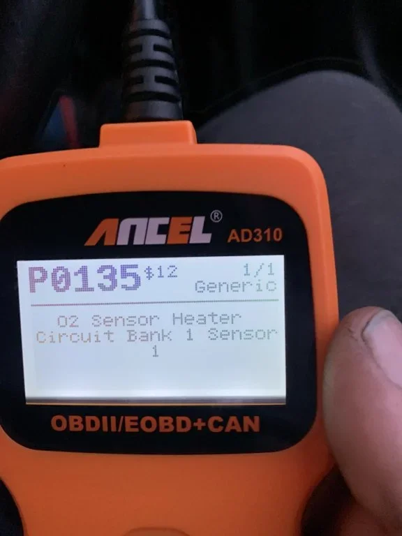

Dodgy Lambda sensor. Hurrah! There goes another £75 to Eurocarparts for a Bosch replacement. I've swapped that today and all is well now. I did a few pre road trip checks today, e.g. figured out how to remove the spare wheel and put some air in the tyre. It's so very rusty though that I will put a can of tyre-weld in the boot too, just in case. I was quite surprised that it appears to have used no oil whatsoever in the 1000 miles or so I have driven during the last month. (Another point scored for the 1.9 engine) And I've ordered a First Aid kit and breathalyser off Amazon. So I'm all set for driving to Germany on Saturday.
