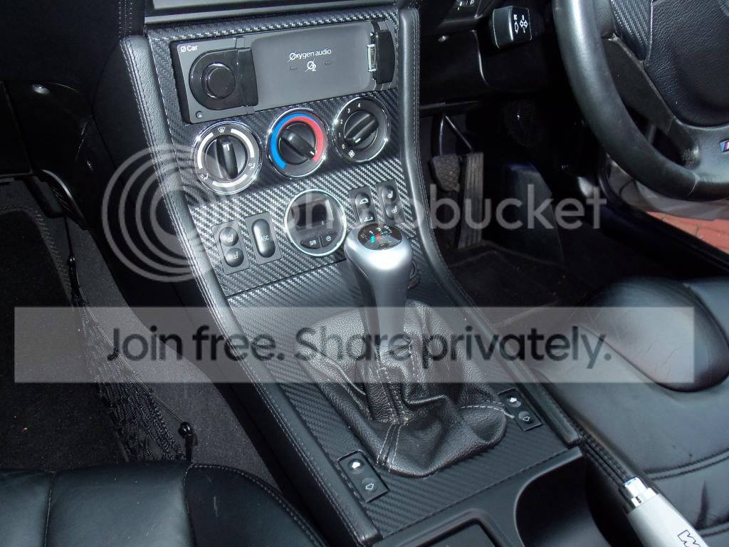

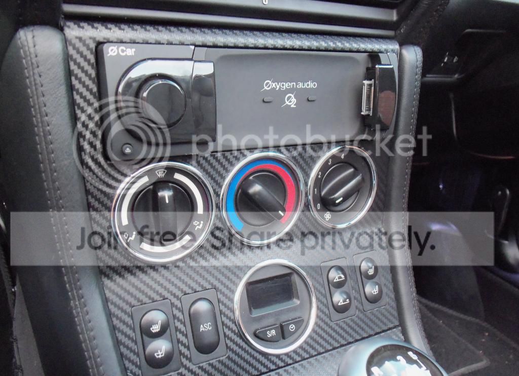

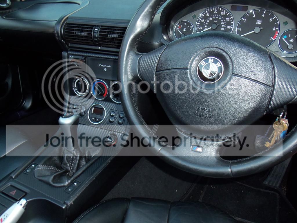

A few changes were made to the interior, I got my new centre console in and went for a change from the aluminium centre section fitted previously by covering the standard black trim in carbon fibre and also did the steering wheel tabs to match.

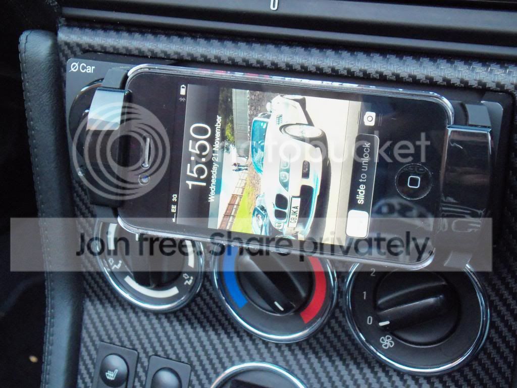

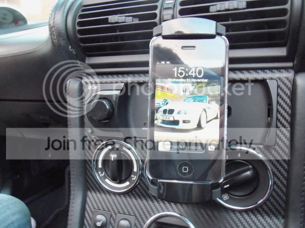

The handbrake and gearstick gaitors were fitted and so was the new headunit, an Oxygen O car with bluetooth and fully integrated iPhone features. This is a great piece of kit which simply uses your iPhone for full control and plays all your music, videos and sat nav through the speakers and has full hands-free bluetooth calling. It rotates also so that the iPhone can be used in portrait or landscape mode. The mic for the calling was neatly routed up into the A pillar trim.

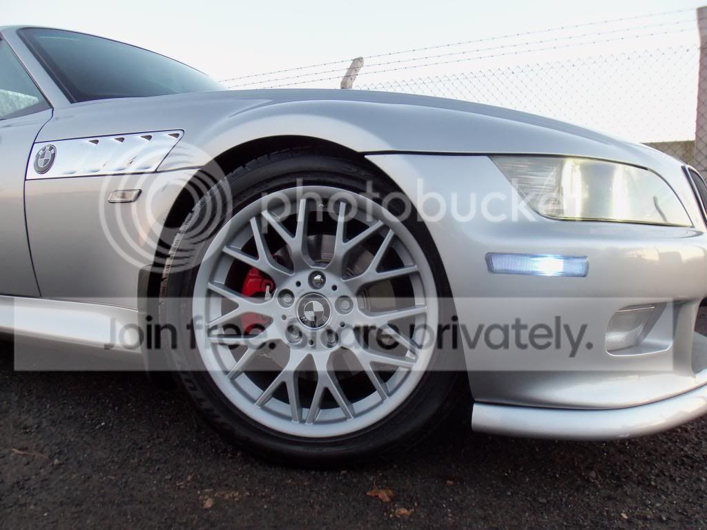

For the exterior I changed the front brake carriers (and one sticking caliper) for some larger ones off a 3.0 Z4 meaning I could fit the bigger 300mm discs and painted the calipers again along with the discs to keep them looking fresh. The brakes seemed a lot better and it was a pretty cheap and simple upgrade. Also some 5mm spacers were fitted to the rear wheels to push them out slightly further.

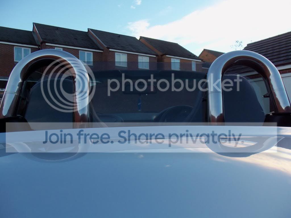

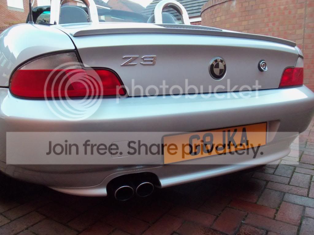

A new tinted wind deflector was made and fitted with some stainless steel cable ties so they camouflage against the chrome, some new pressed metal plates put on and I also tinted the reverse lights so they are red all along.

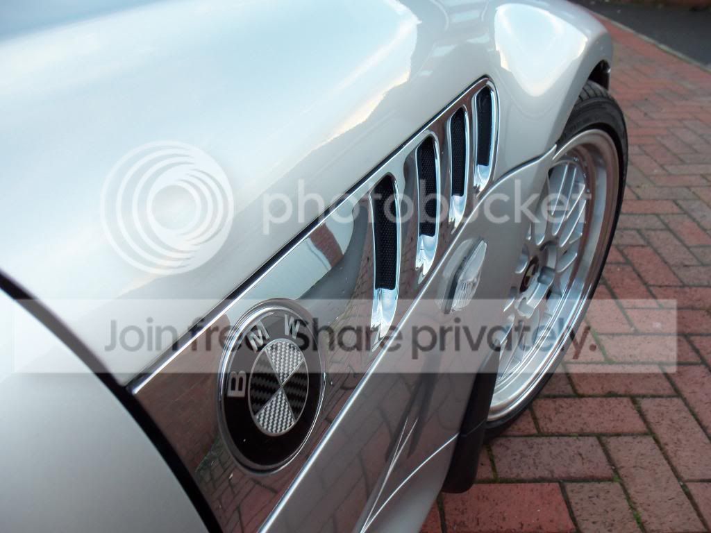

Finally some new mudflaps were fitted to the front arches and I also sprayed the mesh part of the side gills in matte black which made them look a lot better.

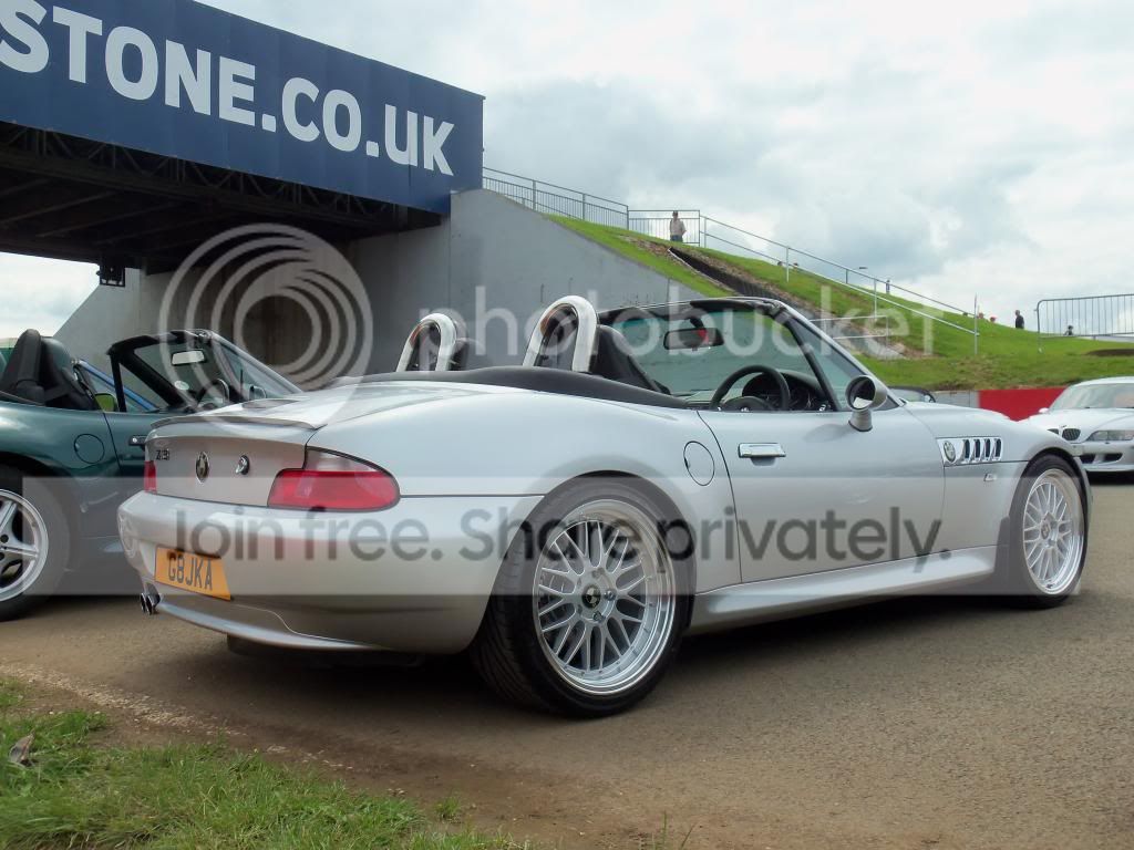

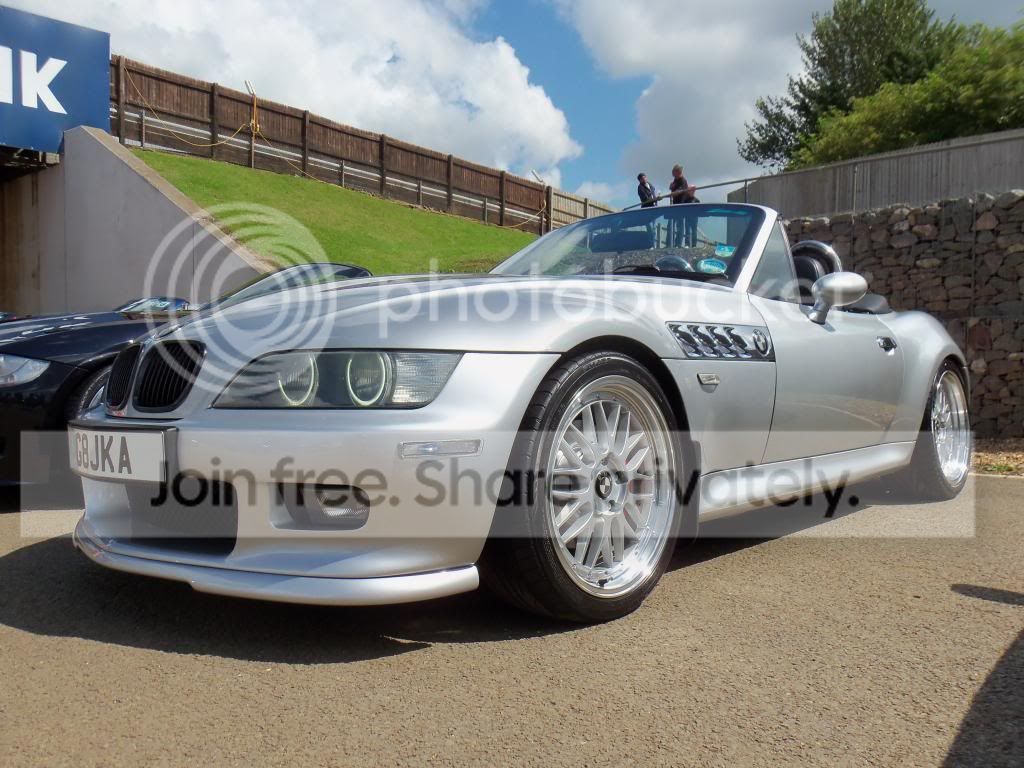

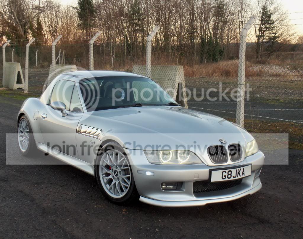

All of this was done prior to zedfest and the zed didn't look to bad in the sunshine

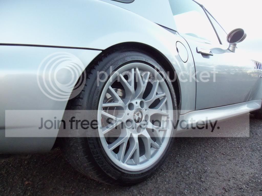

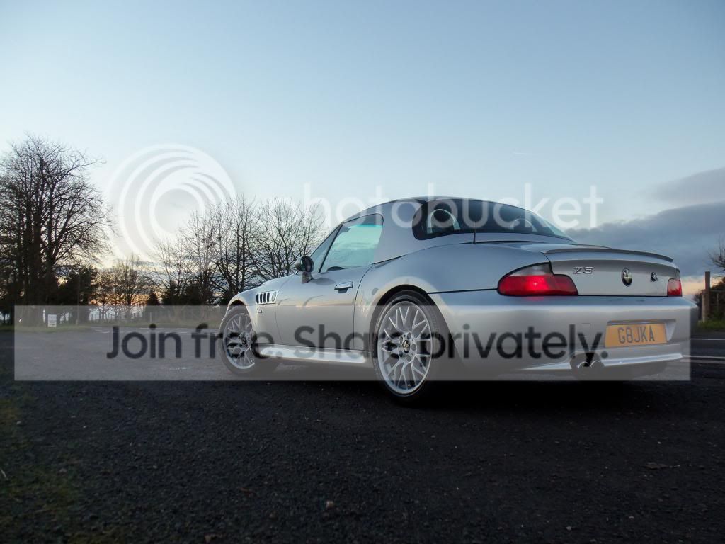

So that's about it for this year, the hardtop went on yesterday and I have almost finished refurbishing my new winter wheels, then over winter I will be fitting an ///M console to the interior which will also be wrapped in carbon fibre. I will post up a few pics over the next week when I have the winter wheels finished and on the car
