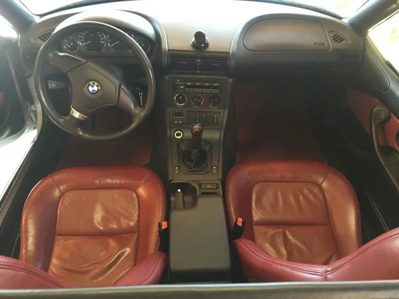

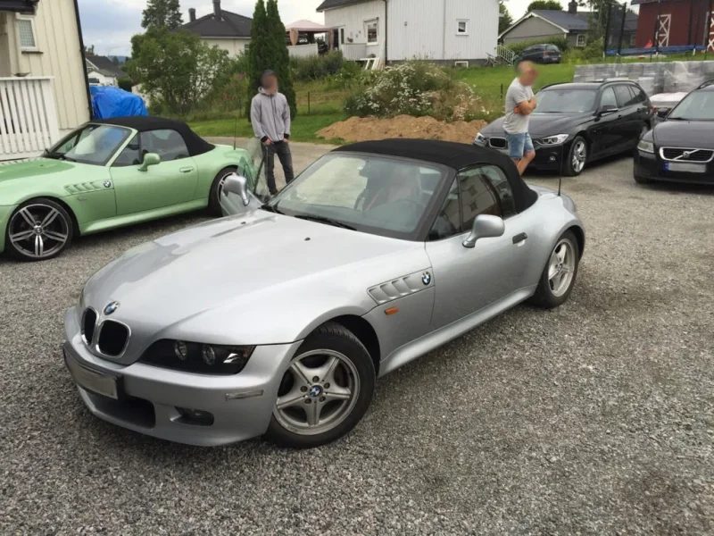

Some pics from the “inspection” day and which ended up in agreement (under condition that all paper work checked out, which it did obviously).

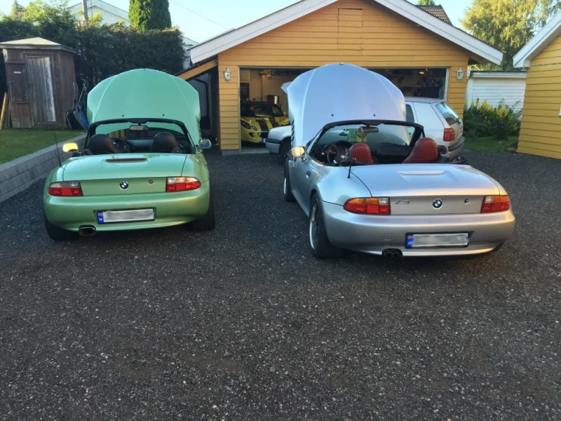

Note the green Z3, that was my friends Z3 (1.9) at the time.
Some pics from the handover day and car is finally home. It was delivered on winter tires (aka storage tires).
The color combo of Arktissilber metallic and Leder Oregon/Taninrot was the winning point for me. Did not really like the wood trim, but I had a plan for that.
Same afternoon I went over to my mates house (after throwing on the summer tires ) and go trough the car more thorough.
Of course we ended up discussing which one had the best rear:)

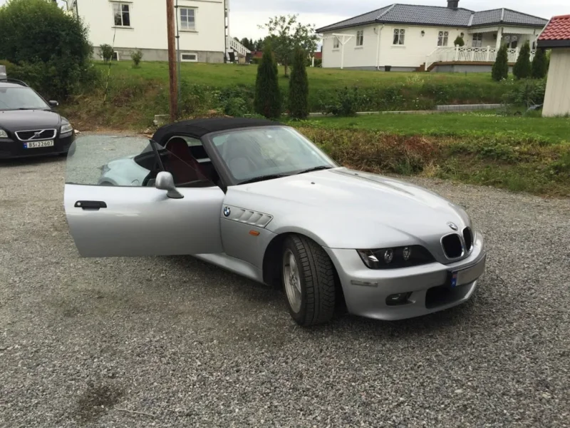

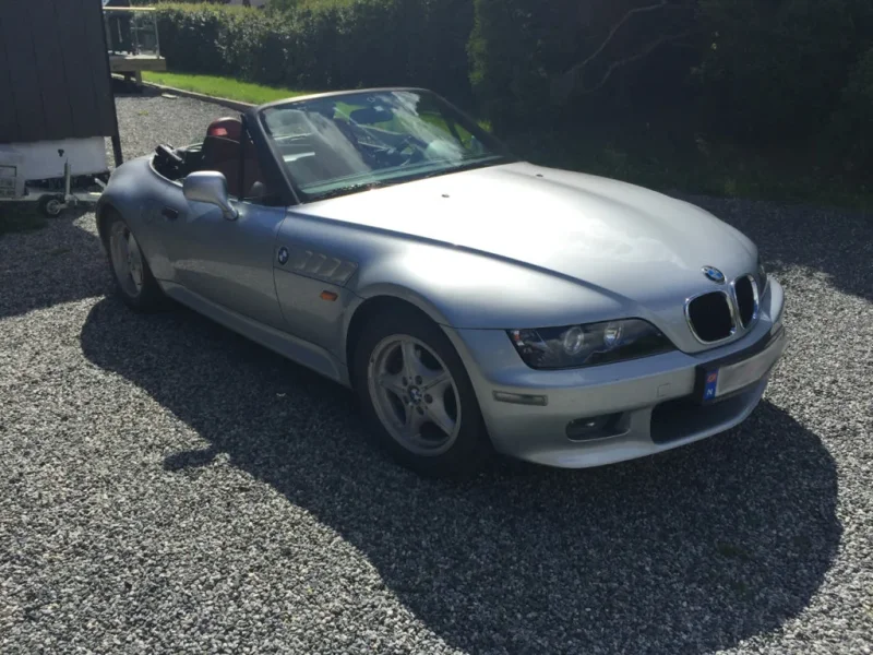

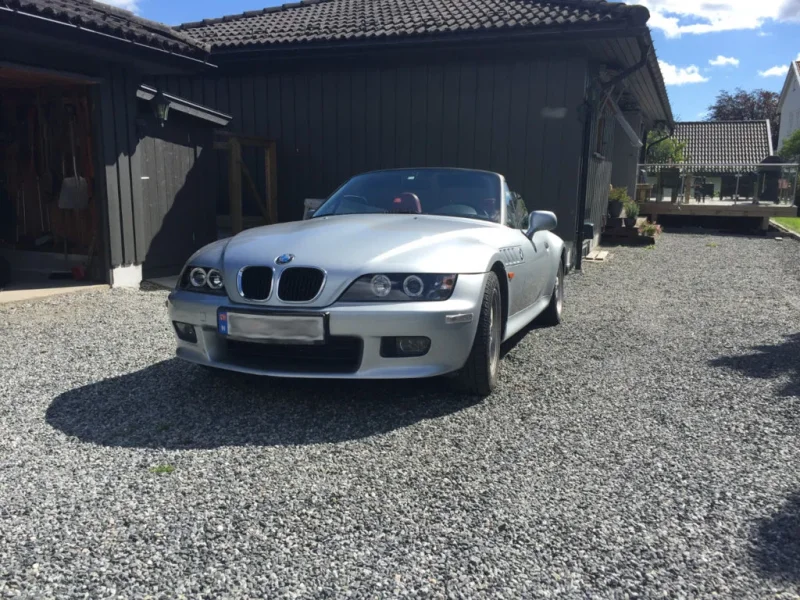

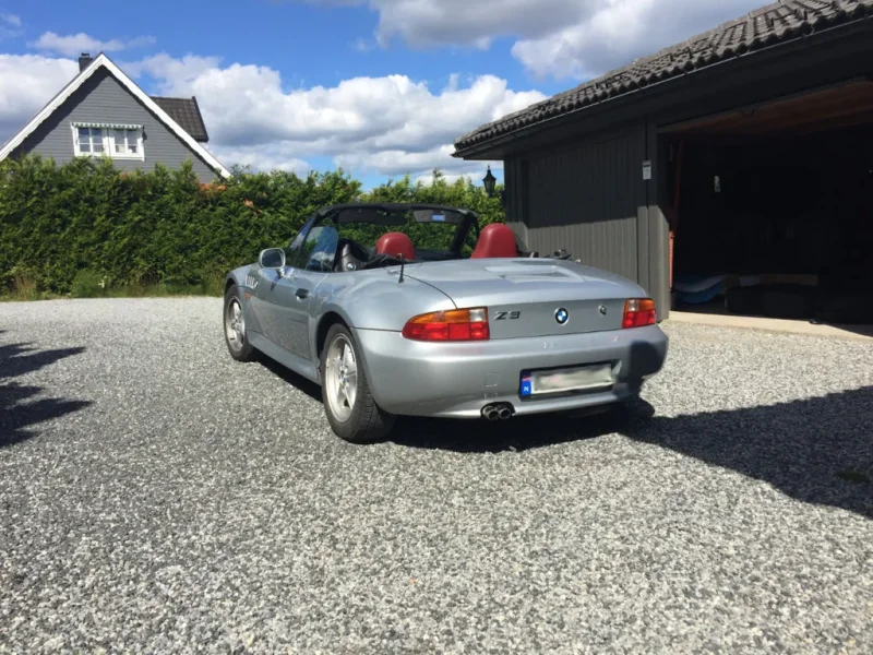

This is how the car looked like in the 2016 summer.

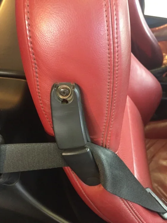

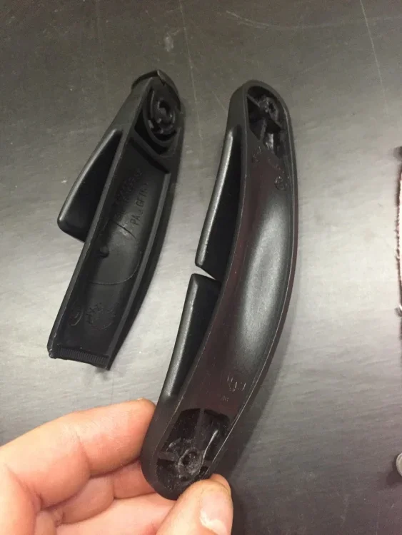

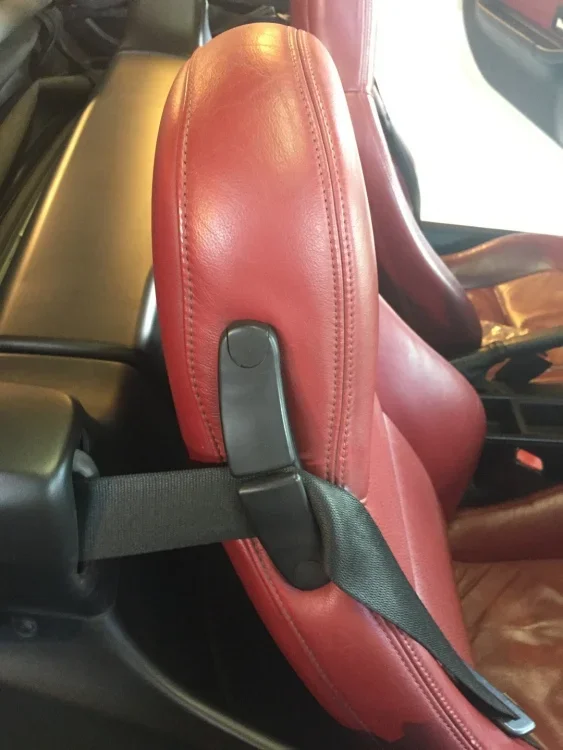

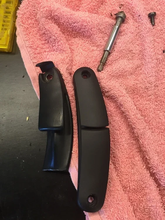

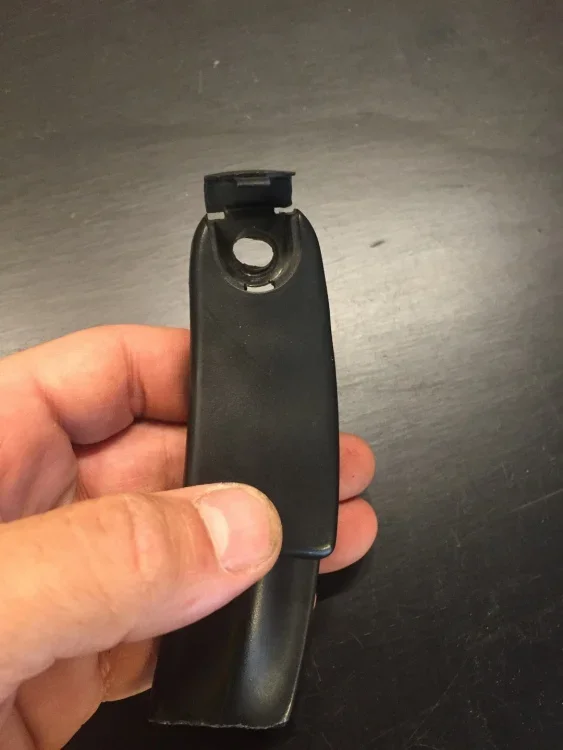

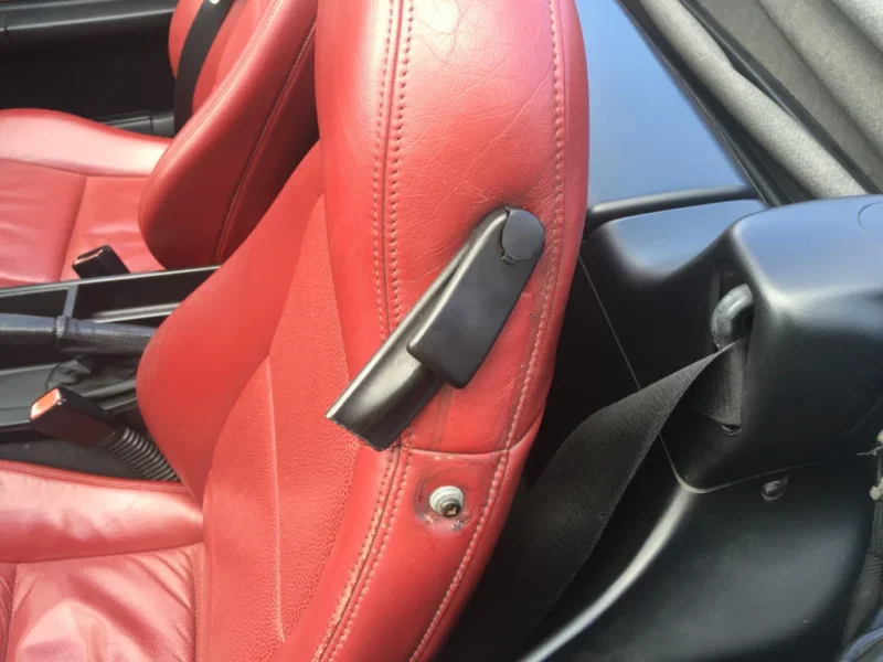

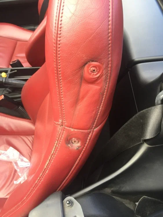

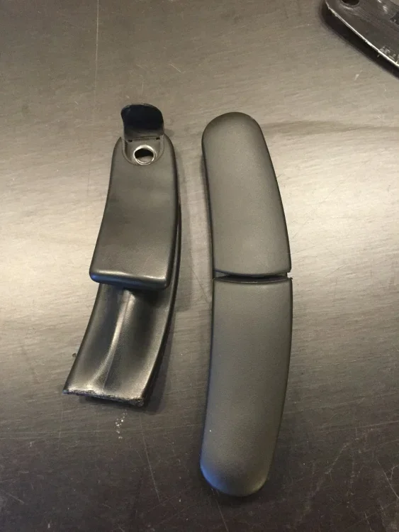

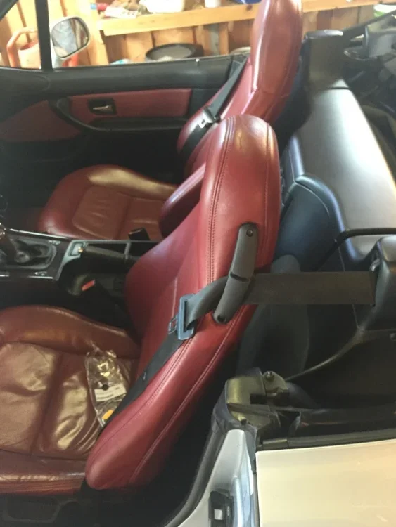

So first part to arrive was the seat belt guide for my drivers seat. After reading about all work that was required to change these, I planned a whole day for this task. But I knew that my car seemed to have slightly different solution than newer cars (changed 98?), so I hoped for a easier approach. But I didn't manage to source a "old" version of the guides, so I had some modding ahead of me.
This is how my starting point was:

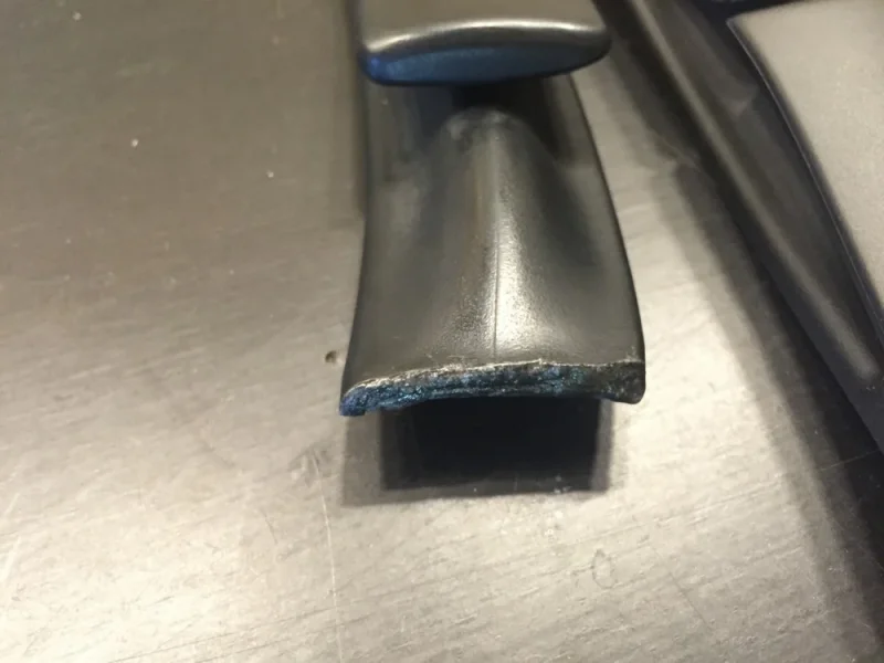

The leather was nicely deformed after the previous guide:

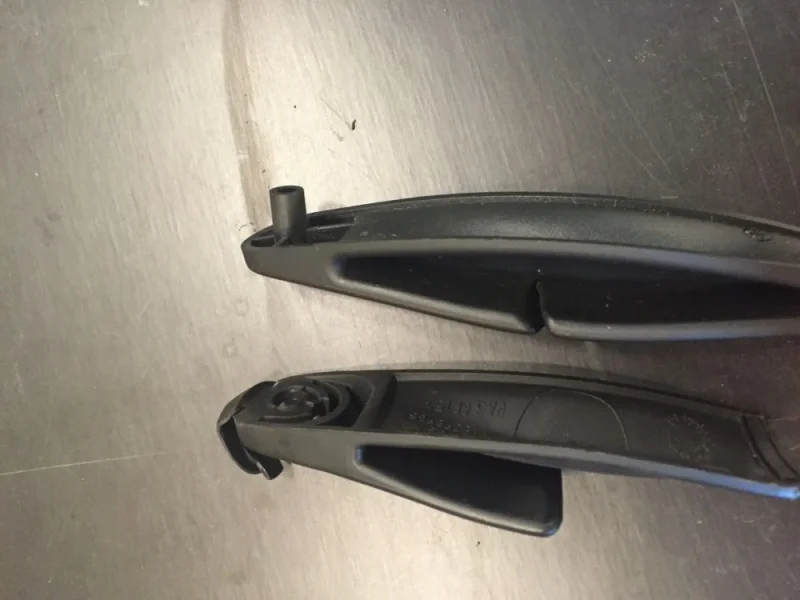

Old versus New part. The old version then you can unscrew the guide directly from the seat. Compared to new version where you have to access from inside of the seat. I find the older solution a bit easier :)
A previous owner had tried to glue the old part, didn't work obviously.
Since I have the 97 solution I had to start mod the newer version, so the extended part for the screws needed to:
After playing a bit with this, it looked like this:
Then I need create new holes and create "widen hole" (not sure what to call this) to fit the screw head. I worked on the finish after this picture. Important that you line up the new holes perfectly at this stage, other is becomes PIA to get it on again.
Since I was of by a a few mm, there was lot swearing and sweating to get the guide on again and align it nicely. But I got in, looking like this.
However the passenger side was missing the cap for the top screw:
So I stole the part from the old broken part:
After some modding I managed to get this one work on the passenger side. It's not perfect but will hold until I get correct date guides.
So now I had working seat belt guides...

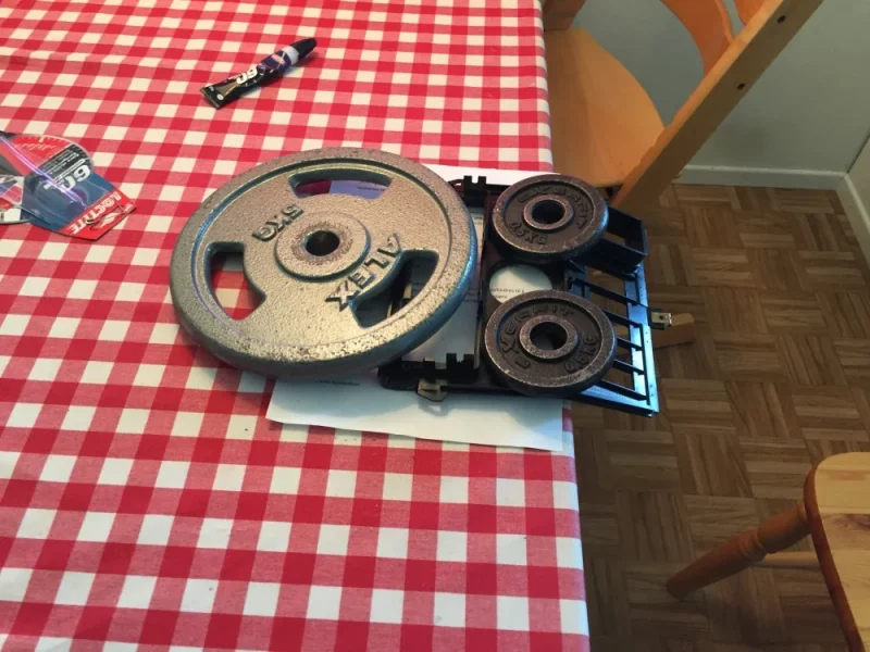

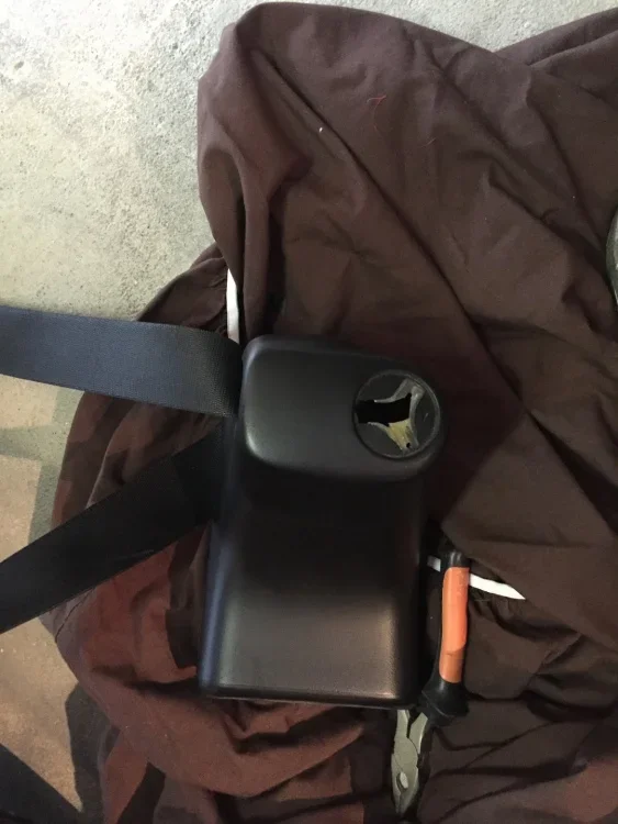

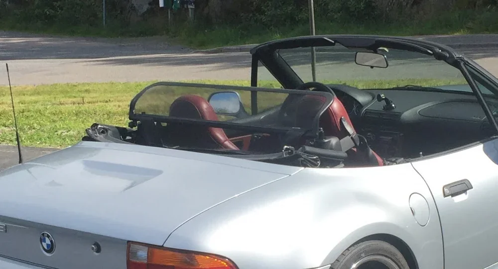

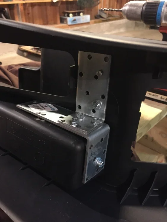

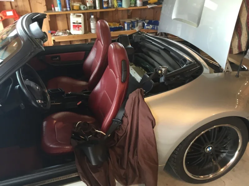

One thing you learn fast with driving a Z3, is that a wind deflector is essential. So I had search on finn.no (a norwegian ebay / craiglist site) for one of those and I got lucky again. A nicely used wind deflector popped up in my neighborhood, so I quickly picked this up.
So I decided to quickly installed this one (However I was really wrong in my assumption of needed time), read a few quides online and started of with good energy.

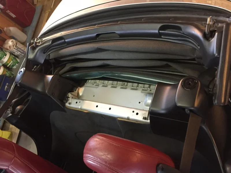

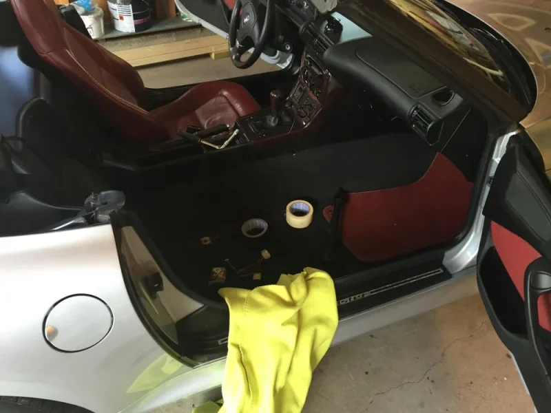

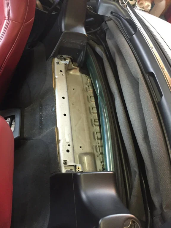

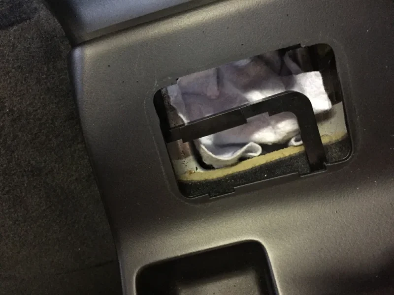

First out was to get the rear storage box out, this went easy. And I was positively surprised that everything was neat, dry and no rust underneath.
A few places where there is "screw traps", so I tucked clothes in these ones:

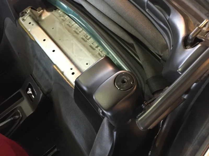

Then the top cover for the drivers turrent was off:

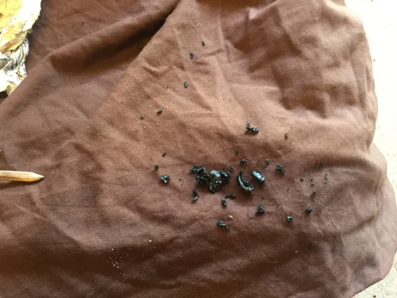

So far everything went good, until I got starting "opening" the whole in the top cover. Underneath the cap I discovered that the whole top was filled with styrofoam and this was sitting like a B.........
However after some time with heatgun, machines, swearing, talking to neighbour and trip to shop to buy some missing screws to attach the wind deflector base it looked like this.
One passenger side it when a lot faster since I now had the "method" sorted out + that the styrofoam part came out easy in one piece.
The rest of install went fine and the end result was good!
I was amazed how good this worked and how much wind and wind noise it actually deflects.

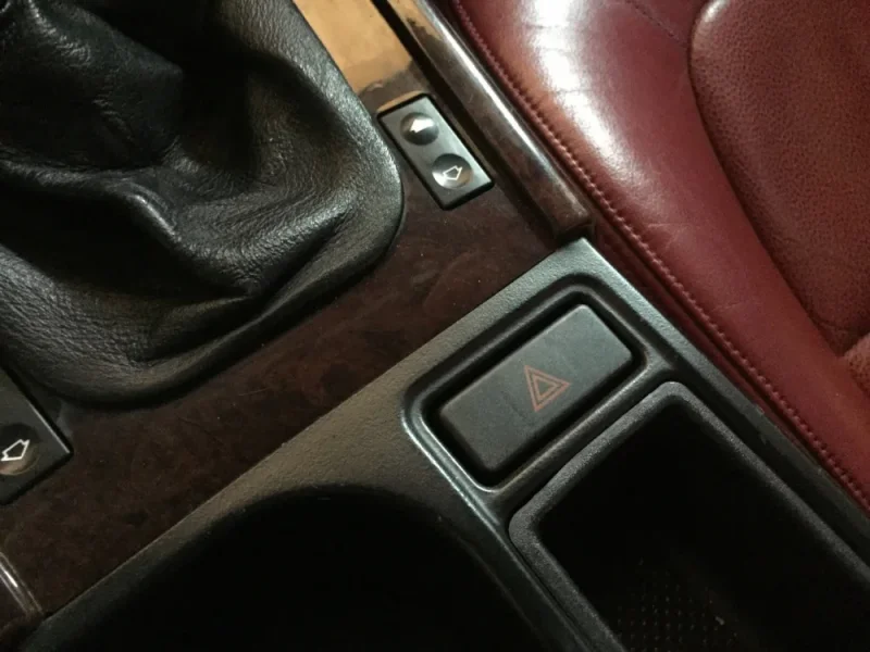

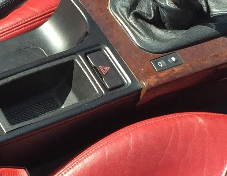

Some days later a few more parts arrived, this time a Hazard button replacement arrived.
This was nice and easy fix, broken and ugly button:
Voilâ, a nice and shiny button:
A small thing, but things like this does bother my alot :-)

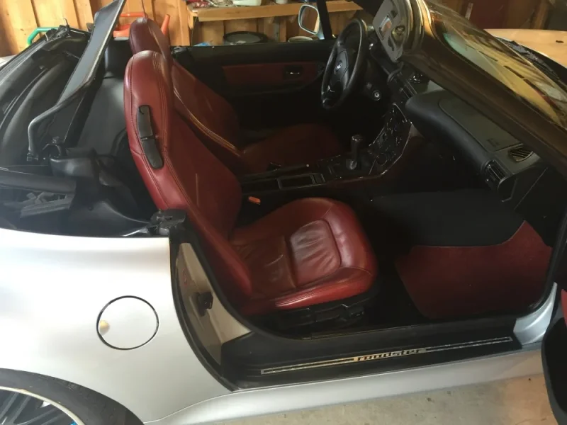

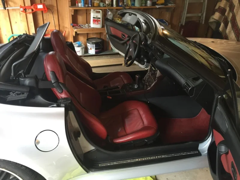

One the parts that also arrived around this time was the seat bushes to fix rocking passenger seat and tackling the none working height regulator on this seat (electrical). Again I read my self up on this task on online guides.
My starting point, these needed
go into this seat:

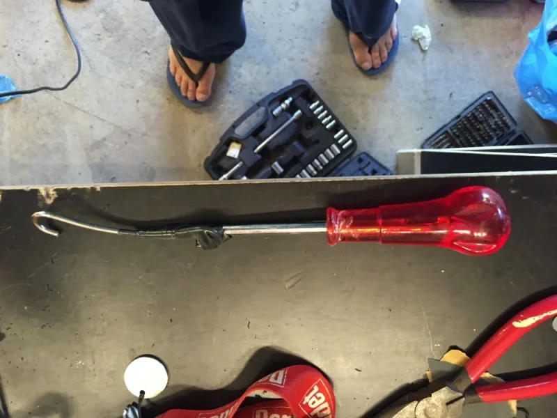

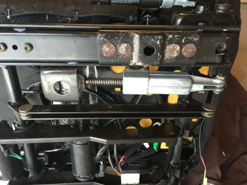

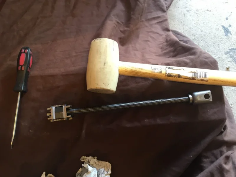

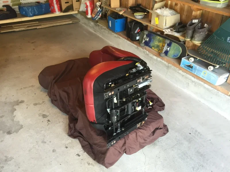

So after a some time understading how to release the seat connectors, I got the seat out.
I didn't find to much underneath, the car was nice and clean. Only found a gold coin, which turned out to plastic. So it ended up in my daughters pile of toys:)

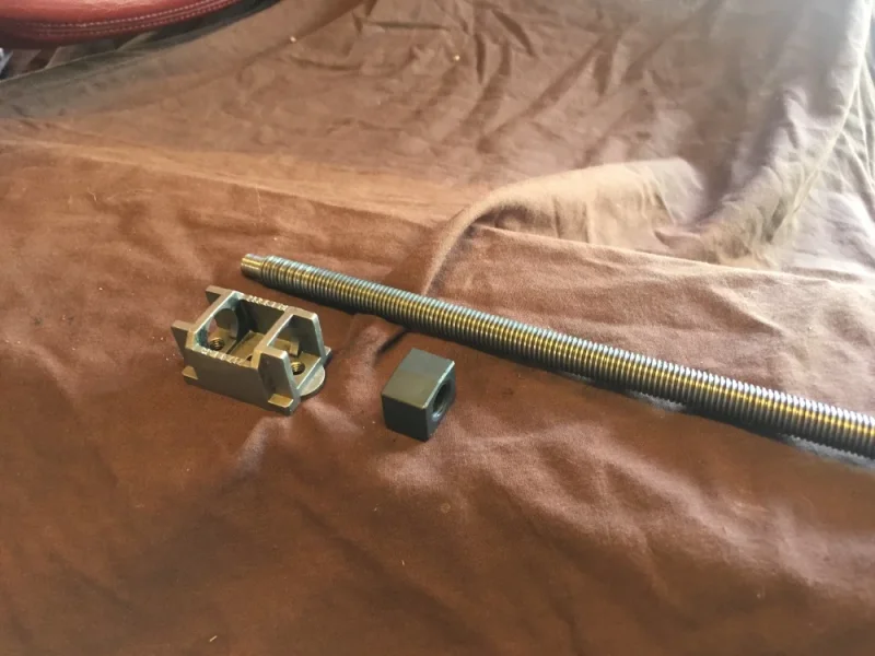

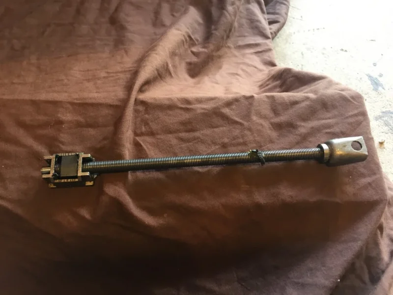

With the seat out, it was time to get the "slides" out of the seat frame.
Thx to the good DIY's online, this task went really easy.
And there it was, the cause of the rocking seat. I was prepared for this, thx to online pictures. But I was actually surprised that bushes had completely deteriorated, was nothing left.
After a good round of cleaning it looked like this:
Left over of the bushes:

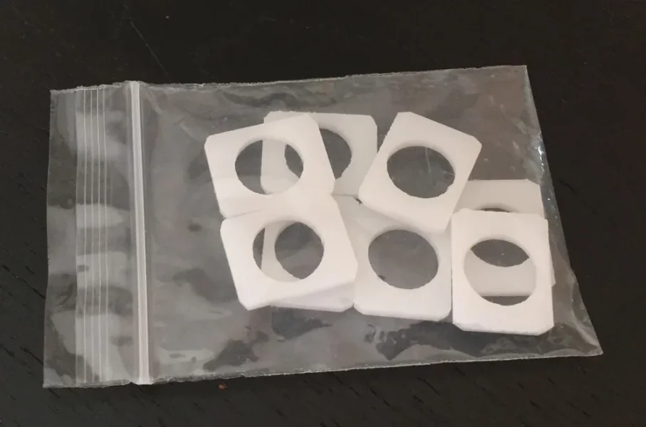

Now new bushes needed to go in. This requires some sanding and exact fitment to get a really snug fit!
After a bit more sanding and some Jeremey Clarkson inspired tools, they where in and had nice and tight fitment.
Then same thing was done on other side and a round of cleaning and greasing, before I assembled the whole lot back to the seat.

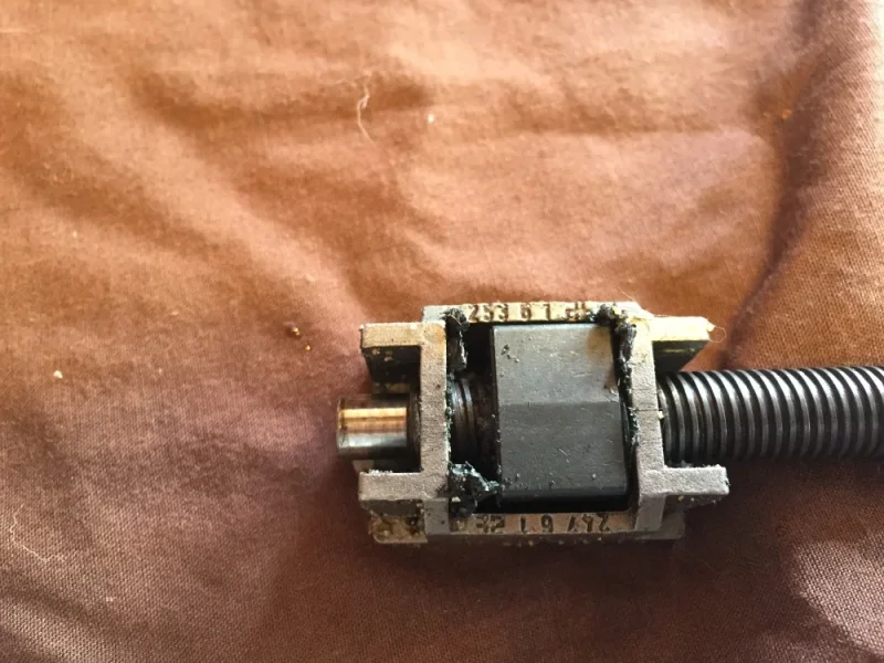

However I also needed tackle the faulty height mechanism, which basically was just to unscrew the mount and screw back in again (all the way). The problem is that when you take the seat all way up the mount can "unscrew" it self of the hinges from the "rasing/loweing" part.
Then it was time get everything back into the car. Was a little excited to see if everything was working as it should and that I did not get the airbag lamp light ( I had disconnected the battery, so I felt safe on this issue).
Everything worked fine, no more rocking and working seat lifter! So all in all, it was good day in my garage.

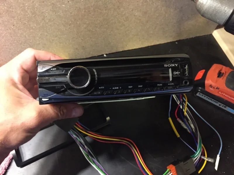

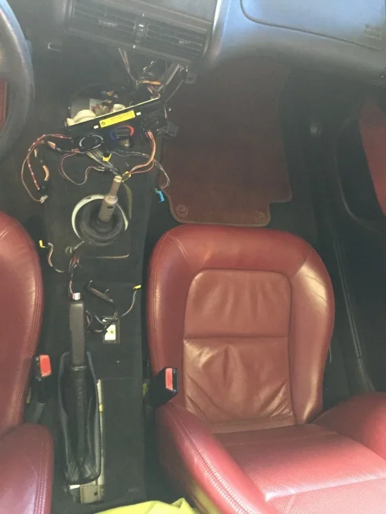

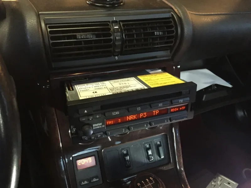

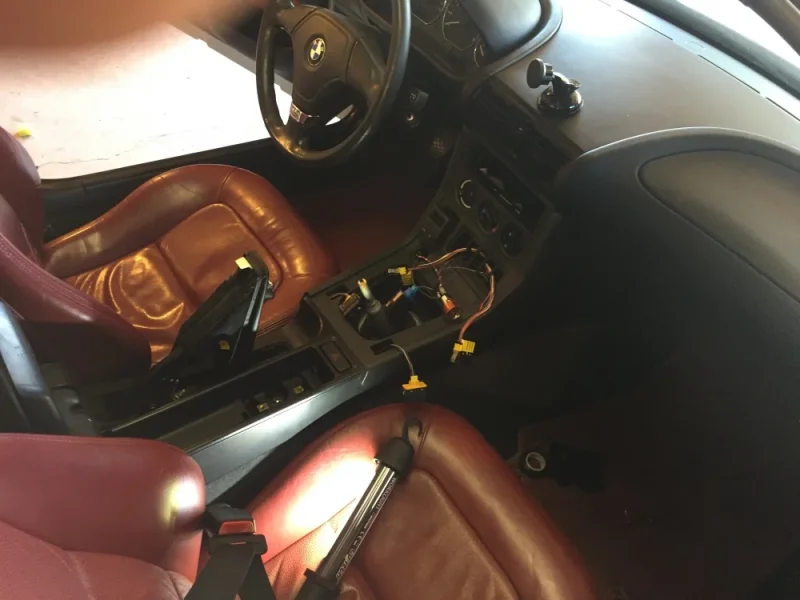

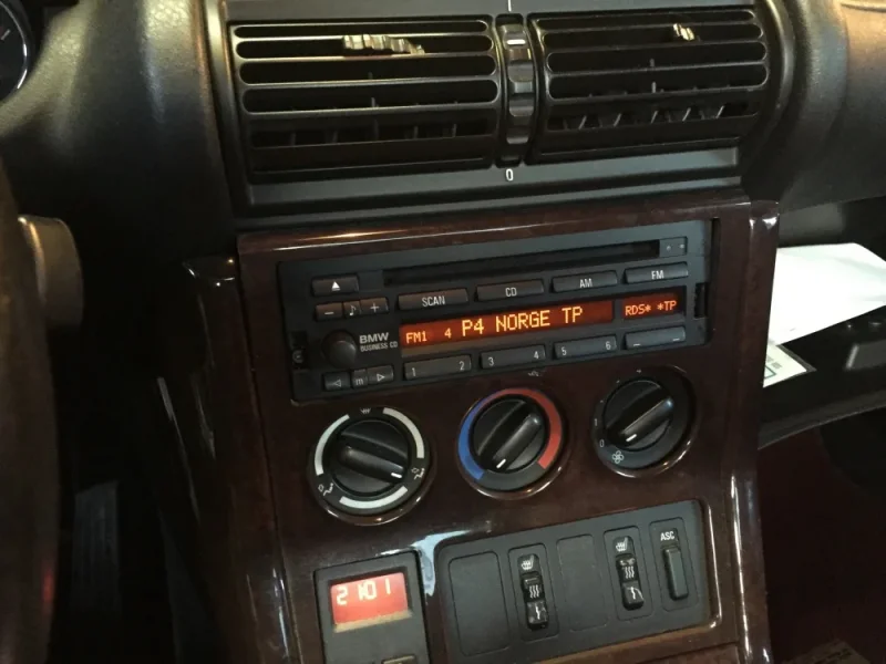

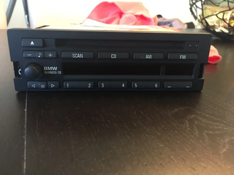

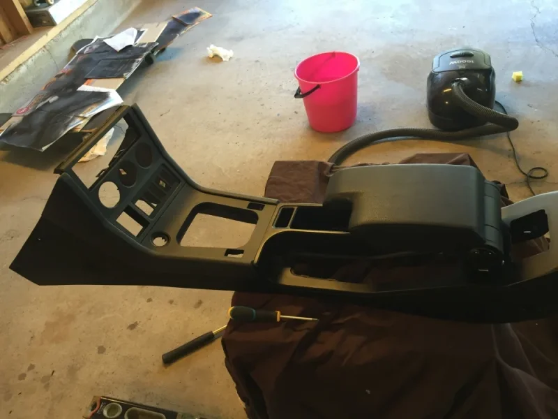

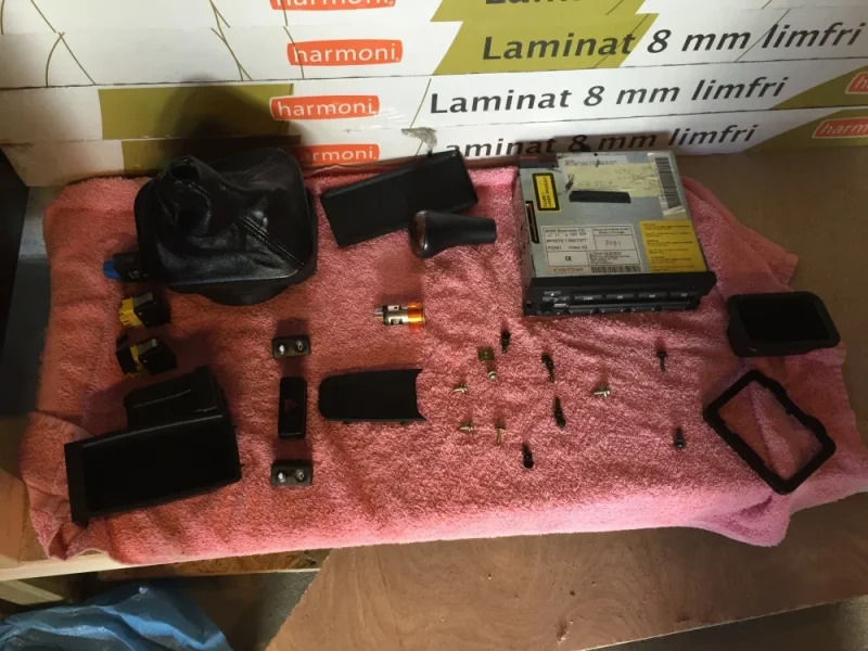

Since I got the CD43 radio the day before, I could not resist installing it.
I was a bit excited to see what mods has been done behind the dash to install the current Sony xploded radio unit. I was bit afraid that a previous owner had done some "hacking" on the original BMW radio plug.
But after getting the old one out:
I could conclude that they had used proper cables and done everything neatly. So it was just matter of unplugging and re-install the CD43 radio. I was also curious if the "new" radio and given code was working at it should (I bought it of forum member of the norwegian BMW forum).
But everything worked fine and the radio reception was better than the Sony one for reason (does the Z3 have an ampered antenna like ie. E53 and E39's?).

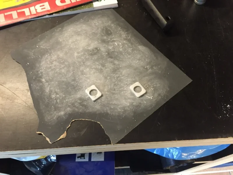

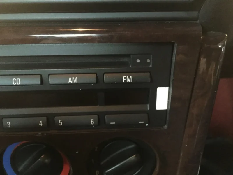

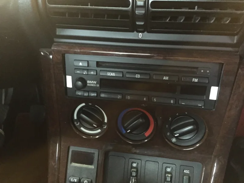

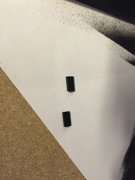

As you can see on the above picture, I was missing the radio caps to cover screws. And the only ones I found on ebay was at NOK 400 ( approx 45 euro at that time).

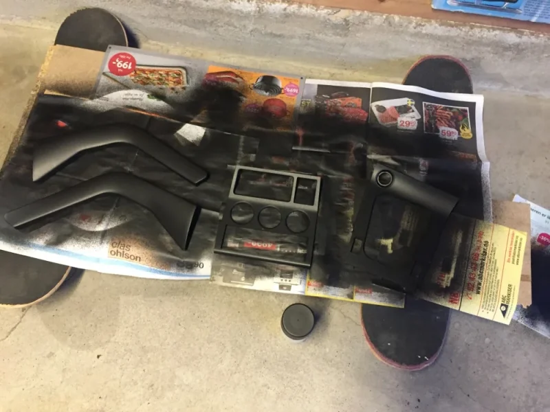

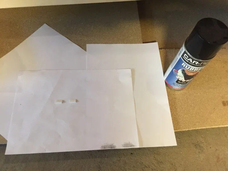

So I decided to make my own ones, so after searching in my "magicbox" with all little things that I think might come handy one day. I found a piece plastic from Ikea furniture that had the same rought surface of the radio.
After a little work on this piece I ended up with a cap like this:
(the center trim was lose a this point, this was fixed in a later task)
However they where still in wrong color, so I checked my "paint" shelf and found that a "plastidip" clone I had almost matched the radio color. So the radio caps was painted in my "professional" paint shop :-)
Not perfect in the color match, but good enough I find some reasonable priced radio caps (which I did find at a later stage).
But getting the OEM look on the radio, was something that really lifted interior (at least in my opinion). Still had issues with the wood trim though at this stage :-)

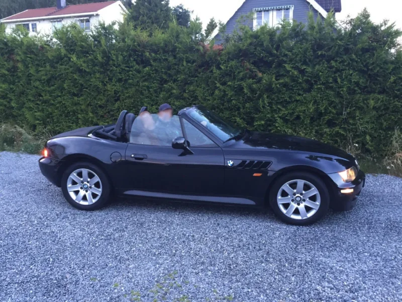

I've spent many hours talking to my neighbor about cars and different models. Since I finally to the step to buy "useless" but awesome car. He started to follow the market as well.

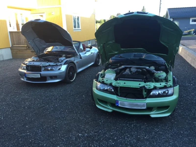

So one day he called me and asked if I could tag along to check out a car. He had found one owner 2002 black 1.8 Z3 that appeared to be in good condition and completely stock. I let him drive my car over there and so he would get a feeling with it.
The car was indeed not in bad condition, maybe 7/10. But he managed to talk price down a lot and got the car. (I have not seen a car on the Norwegian market to that price in same condition and low milage).
Test driving:
From our front yard ( we share part of the road into our houses ).
So that meant suddenly two Z3 to work on and maintain. Double the fun right:)

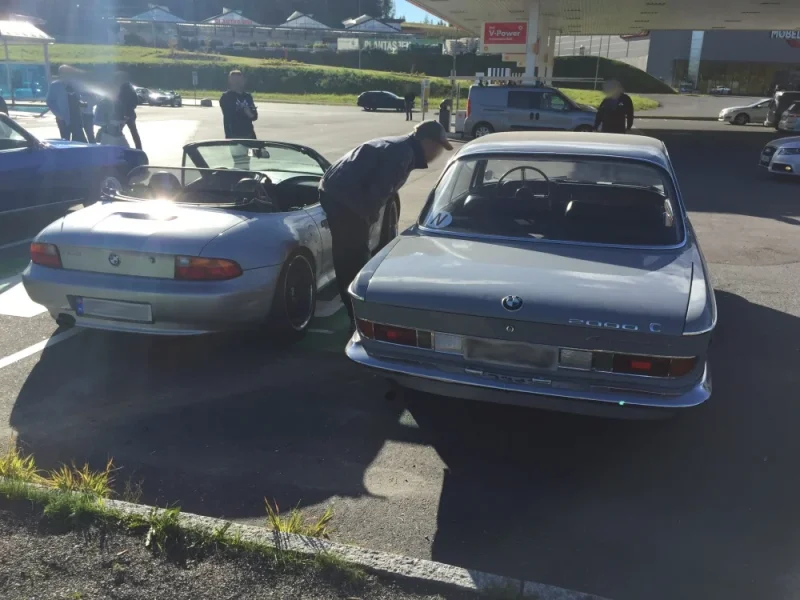

At this time it was still summer and I was just doing minor fixes on the Z3. However at this stage I felt that I could bring the car to its first Cars & Coffee meetup.
Got there and ended up parking next to this nice 1967 BMW 2000 C Automatic, after chatting with the nice couple owning. It was revealed that they had 13 more BMW's stored at home on their farm. One of the cars they has was Red Z3 1.9 (I don't recall which red color or year), but it was clearly one of their jewels. Since they were planning to restore the car completely and keep it.
Some pics:
IMG_8137.thumb.jpg.bd8afcd98d5e9d5379c2bca3256767eb.webp IMG_8144.thumb.jpg.ca7729575e0d43ea3d18b140b8b65543.webp IMG_8145.thumb.JPG.6cecb289406b39518c8c91a2cc167557.webp IMG_8149.thumb.jpg.d6ec3f1551d8d699288b203fe9741c09.webp IMG_8146.thumb.jpg.0589a2a99a0eff4c9bf99f195e992b60.webp IMG_8139.thumb.jpg.f3cf50bd3145a6bb08e4006133ac7265.webp IMG_8142.thumb.jpg.7063c739520a41ee542aa8180158068d.webp IMG_8140.thumb.jpg.b9a2ba32a1fb4b2fcc26296c568c626b.webp

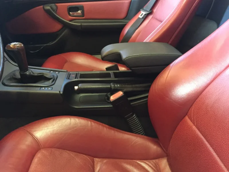

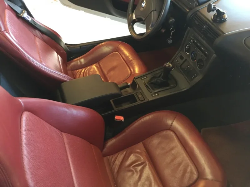

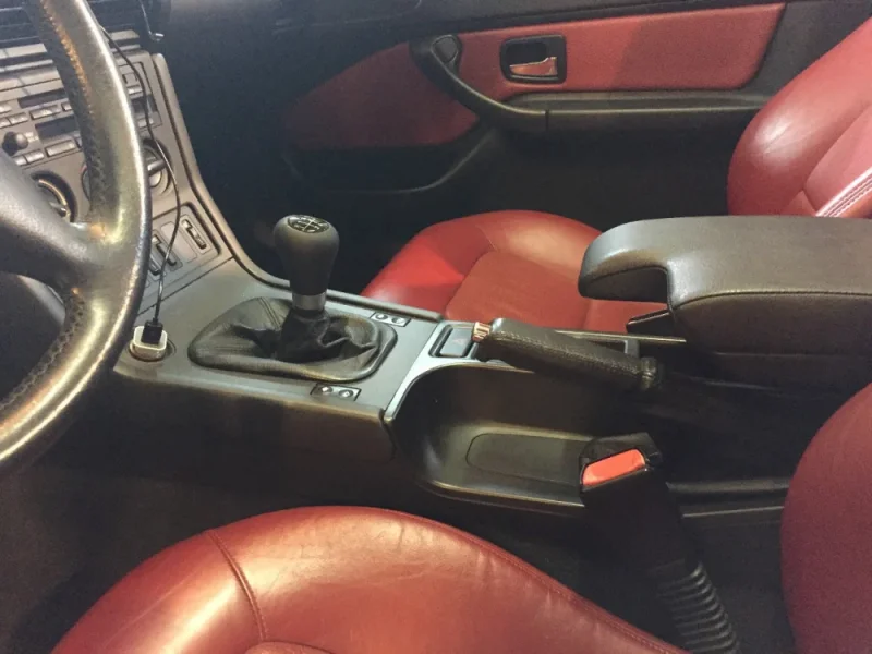

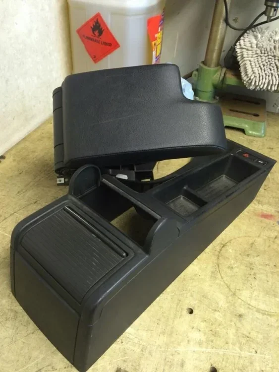

As many of you Z3 drivers has noticed , a decent armrest something that these cars really lack. Especially when one is in cruising mode:)
However I really like to have some arm space, when I go in "active mode" (or sport mode as the wife calls it, coming from when I push the sport button in our DD. Of course also a BMW).
So I wanted a solution where I could flip back the armrest and free up the space when needed. I did find a few really good options online, however some of them introduced a cupholder in front of the armrest or others where to low etc. Was not just perfect in my opinion. Until found a DIY (can't remember where, maybe this forum) with a guy who had adapted a E46 armrest. His solution was a perfect hybrid solution and it still looked somewhat OEM. So I setup search online and thought it would take time to get one in correct color, decent shape and reasonable priced. Again I was lucky and one turned up within a few days and close by. I managed to purchase it to 1/2 price after some rounds in the "ring":)
I was planning to use DIY I found online and again assumed that it would go fast.

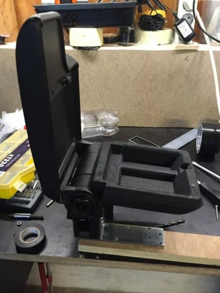

This was the starting point, I only used the armrest + the hinge part. The rest I gave to a friend working on a E46.
But as I started to work with this solution I realized that the DIY solution would not be sturdy enough to my liking. I wanted it feel solid in any direction and withstand the weight from 2 people. So I realized this would take more time and require a bit more thinking for my be happy with the final solution. (A solid OEM feeling)
First I spent some time finding the correct height and modified the armrest bit by bit. (taking to much would render it to low)
I ended up with aligning armrest with the armrest in the doors.
Then I was playing with different mounts ideas and testing their sturdiness. I wanted something really solid but not massive and keep the uplift function of the armrest and lid function to the hidden storage.

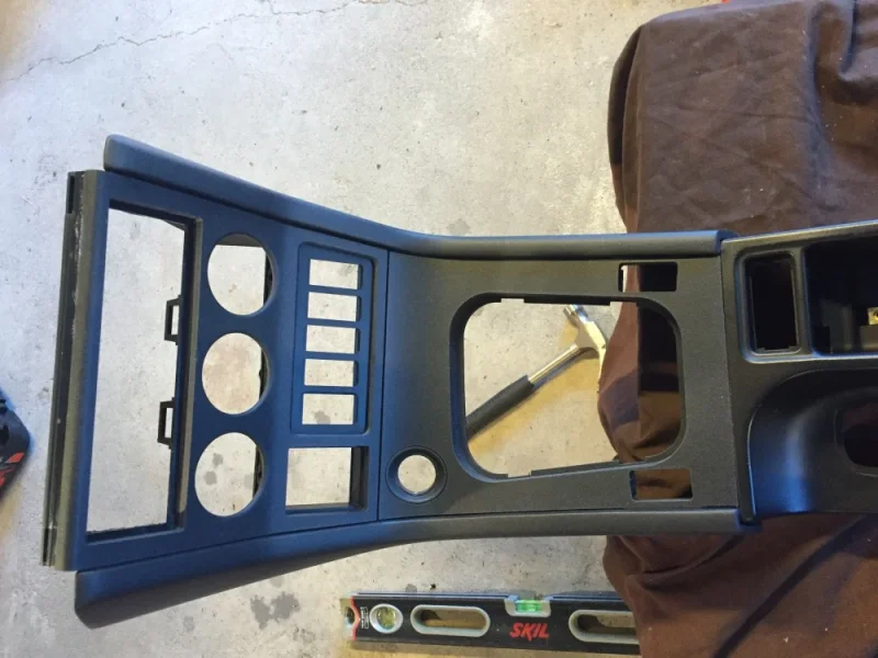

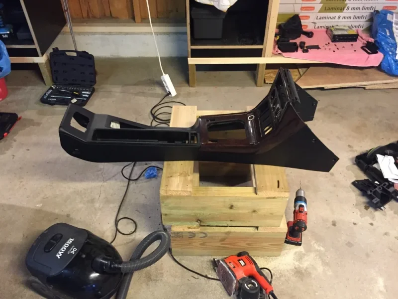

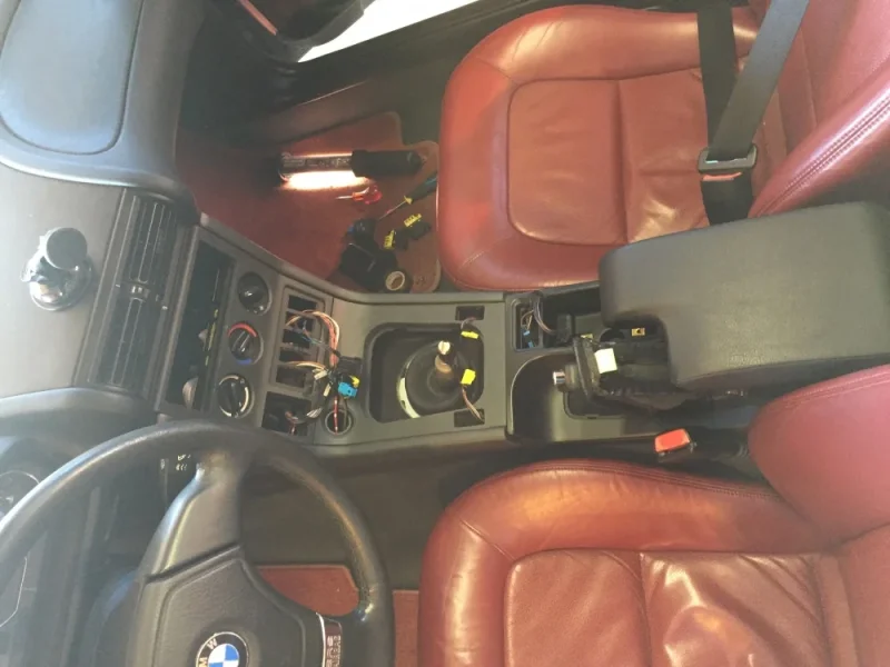

The I started the task with taking out the center console and dismantling it. Taking the console also meant that I the opportunity to fix my dislike with the wood interior and glue some loose parts.
Plastidip'ed my trim panels in my home paint studio, note the skateboard allowing me to move it around when needed (I felt really clever at this point :-) ).
And glued the loose trims, finally my home gym equipment got used!
And checked all wires and cleaning out, while the console was out.
Was quite a few screws and other little things involved in the console dismantling, so I laid out in a reassembly pattern.
After all this was done, I could finally focus on the main task. I spent some time playing and tinkering with different solutions.
This bracket is what I ended up with. The idea was get a solid mounting platform for the armrest and the same time get as much "spread out" of the down-force from the weight of the driver/passenger arm. I also wanted sturdiness any direction, so I wanted many angles to fit the bracket on.
Assembling it all together.
The paint job turned out pretty good (I topped it with 3 layers of plastidip clear coat to create a robust surface).
It was a PIA to get it back in! I ended up get it 1/2 way in and then sorted out all the wires correctly and tape them together on outside of center console. To avoid them go back in again, whilst I was fighting with console to get it in place.
My magical wire picker tool!
Last check that everything was working before screwing all screws back in.

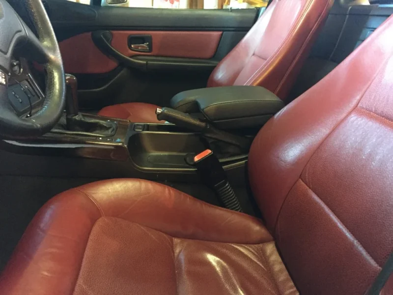

Finally finish after 2 days of work (well two afternoons to be accurate).

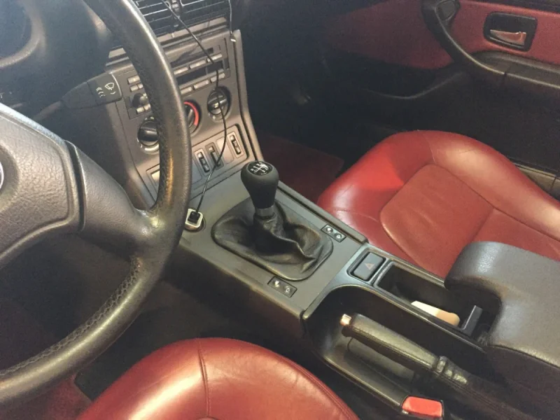

The mandatory before picture:
And of course some after pictures:
IMG_8248.thumb.jpg.5488489e151cf4513d578b97cef43d68.webp IMG_8249.thumb.jpg.10251fbb6bf83fea1dd2300f03743cc6.webp IMG_8251.thumb.jpg.615faa7b803dabc76d8a45a85fbb432c.webp IMG_8253.thumb.jpg.9804f24da7ffc6e8ca69890a836c5e2c.webp
I was really pleased with the end result and my driving comfort increased a lot, when I go in "active driving" mode I just flip the whole armrest up/back and regain space for active shifting :)
I also thinks it looks kinda OEM and the height was perfect for me. (Later on I also got a matching gear knob, will be in future post).

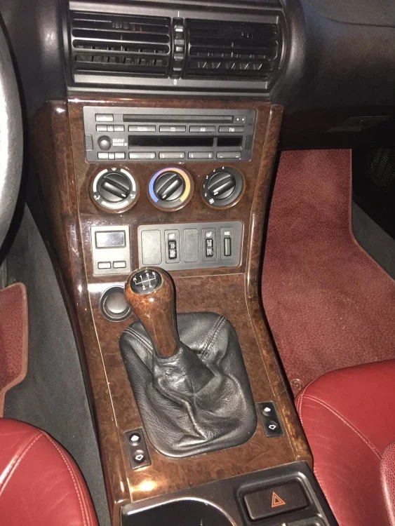

After the armrest mod and painting the trims, I just could not resist investing in a proper gear knob. So I ended up ordering a ZHP knob, it was actually more expensive to get a one for 5 gearbox and no M logo.
This job was a easy fix and this time I assumed my time needs correctly.
So the car went from this:
To this:
pic2.thumb.JPG.ef7a0850da9c5002034fb14e465e5c2c.webp pic1.thumb.JPG.f00a6a31b5599ea6e9dd4d5f33aba860.webp
The ZHP Short Shift Knob really does transform the shifting feeling, the weight balance and length really out performs the OEM knob.
This is mod I really recommend, it really changed my "feeling" with the car.
