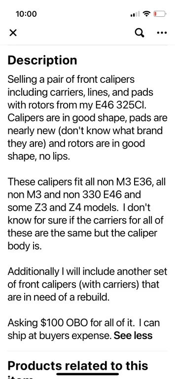

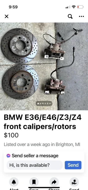

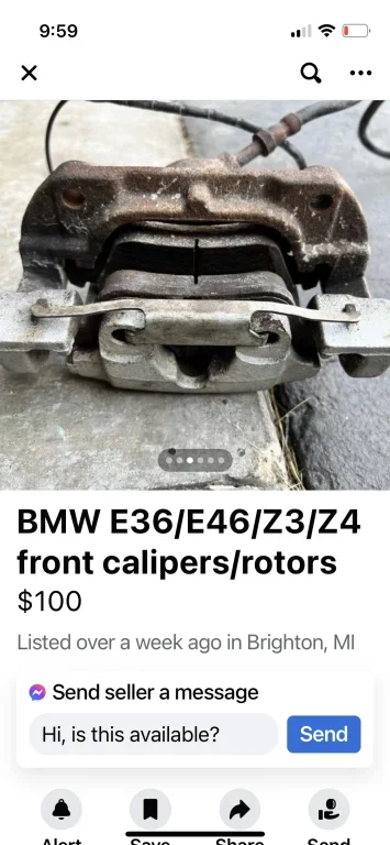

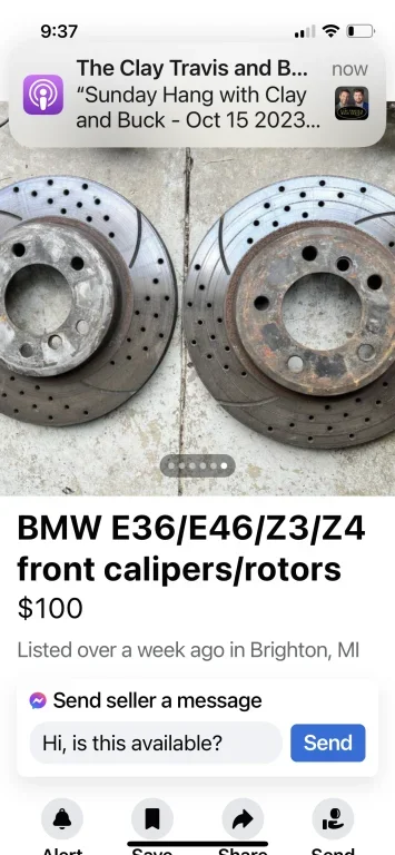

Good morning gents. I have enjoyed this forum! So much information. I know nothing about brakes and wasn’t planning to upgrade. However this popped up on FB marketplace and are very close for easy pick up. This is a front brake set up off a e46 325ci. Is this one a direct fit upgrade to my 1997 2.8? If so $100 seems like a smart buy? Any thoughts?
Cheers.

I would buy those, they‘re well worth $100 and you can sell on what you don’t use and really make it a sweet deal.
Thanks Tony. I was hoping you would chime in. 👍. I’m reached out and hope to pick them up this week. I will do some research. I can tell the discs are larger and different. Are the calipers the same size just modified to fit larger discs?
IIRC the same pads fit, but because the carriers are larger the pads grip further out on the disc giving greater braking force. The actual calipers are the same size, it's the carriers which make the difference. The drilled and grooved discs alone are good. I just ordered some front ones for my car, just searching for rear ones now. Also replacing the rubber flexible hoses with Stainless steel ones is next on the list for a "firmer" pedal.
