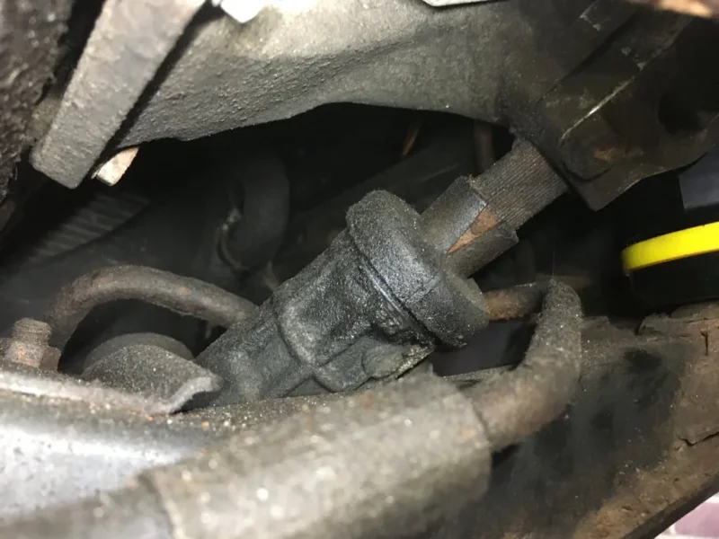

Managed to removed hubs, wishbones, wishbone attach to chassis bits, ARB & removed engine mounts and swapped for Powerflex engine mounts. Hubs need a good polishing and painting so too the ARB and arb mounts . . .tomorrows work! Now that I’ve got access to the steering rack seem it’s only connected by a couple bolts and a couple pipes.

This is definitely a case of ‘ Jack up the Wiper Blades’ and check everything underneath them =))
Hope you have labelled everything !!!:whistle:
Got loads of nuts and bolts in zip lock labelled bags! So far I’m doing the easy stuff like adult mechano. The manifold swap gives me goosebumps though! I’ve got a month and a half to get it all back together before the landlady comes for her property inspection and I don’t want car in bits . . .might be too scary for those without the Zed passion:thumbsup:
