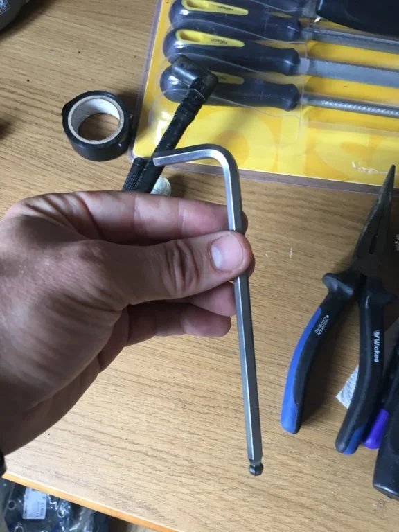

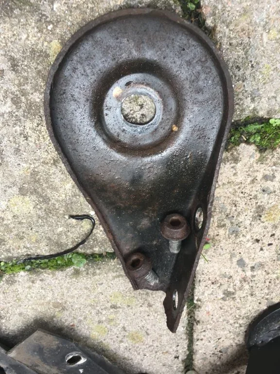

So here is a tip for anyone (like me, new) trying to get into a 6mm Allen bolt, use penetrating spray . . .and a 6mm Allen key with the round end (see pic) slowly work the end into the bolt and keep spraying spray, using this method i managed to get a ratchet 6mm into an otherwise no go bolt x4 (the ones in the pic), also use a small hammer and lightly tap it in and spray each time you get a little further . . .until there is a proper bite for the ratchet . . .!

As for the bolts connecting the exhaust to the manifold outlet . . .good luck, i got 4 out using bolt removers but the last 2, OMG stripped a bolt remover trying a bolt remover head with an impact wrench and just stripped the head, then tried a nut cracker, broke that first go . . .returned as useless, then bought a dremmel with an extension . . . Very frustrating but managed to cut it off. Currently I’ve got a half cut bolt and another sheared bolt end stuck in that area. I’m guessing drilling it out may be the solution but i recon those are the original bolts 20ys in place and near enough welded to the local area. That was 4 days of after work . . . Work. Took a chunk out of my soul.

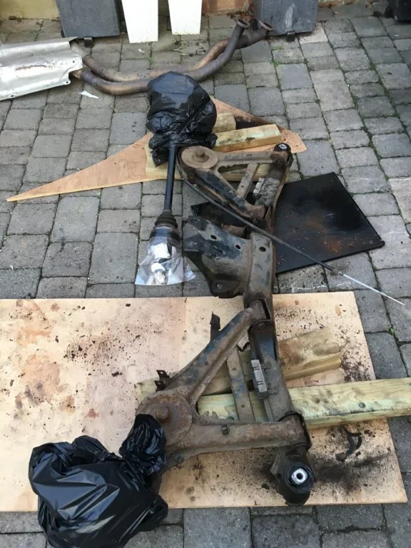

Today i managed to get 1 wheel prop out, disconnect the handbrake cable to on side and remove both shoes. I drained the diff oil and attempted cutting through the beam bushes with a hacksaw . . .a hacksaw ha ha, lots of sweat and not much change, mights try stick drilling or even a hole saw tomorrow. So close to having everything stripped but learnt that getting the wheel bearings out is a mission so as they feel good and i cant feel any movement I’m going to leave them in.

Finally de-rusted and cleaned the cross beam . . . Tomorrow the trailing arms
Blimey, you took the whole car apart in the time I swear at a couple of rusty bolts that won't come out. And yeah, also, lets down the whole friggin' back end while the car is held on 4 chicken drumsticks :-)

I wish the beam bushes were as easy, also used a larger drill to drill out the metal insert then went at it with a hacksaw, that was not fun! One I made a cut I used a lump hammer and chisel...phew

Today was a massive day, derusted swing arm, diff, brake calipers, and wheel prop. Yesterday, swing arm, wheel prop and arb, back stiff now! But all parts are cleaned and ready for paint prep!
