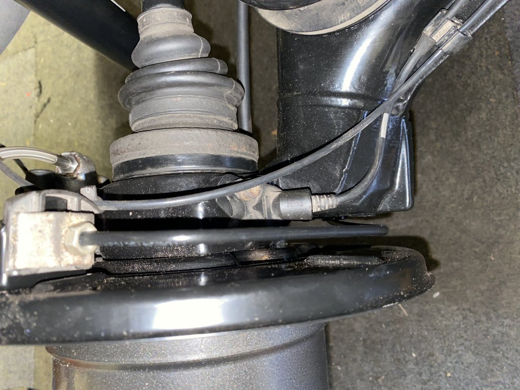

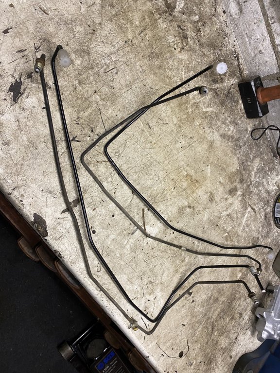

This project is now coming to an end and it’s been so nice to work on. We’ve finished the final tasks first being making new rear brake lines.
Not an exciting photo but I use the old rear lines as templates and copy the shape using a pipe bender. These look like they’ve been made by hand before, the lines weren’t as crisp as normal.

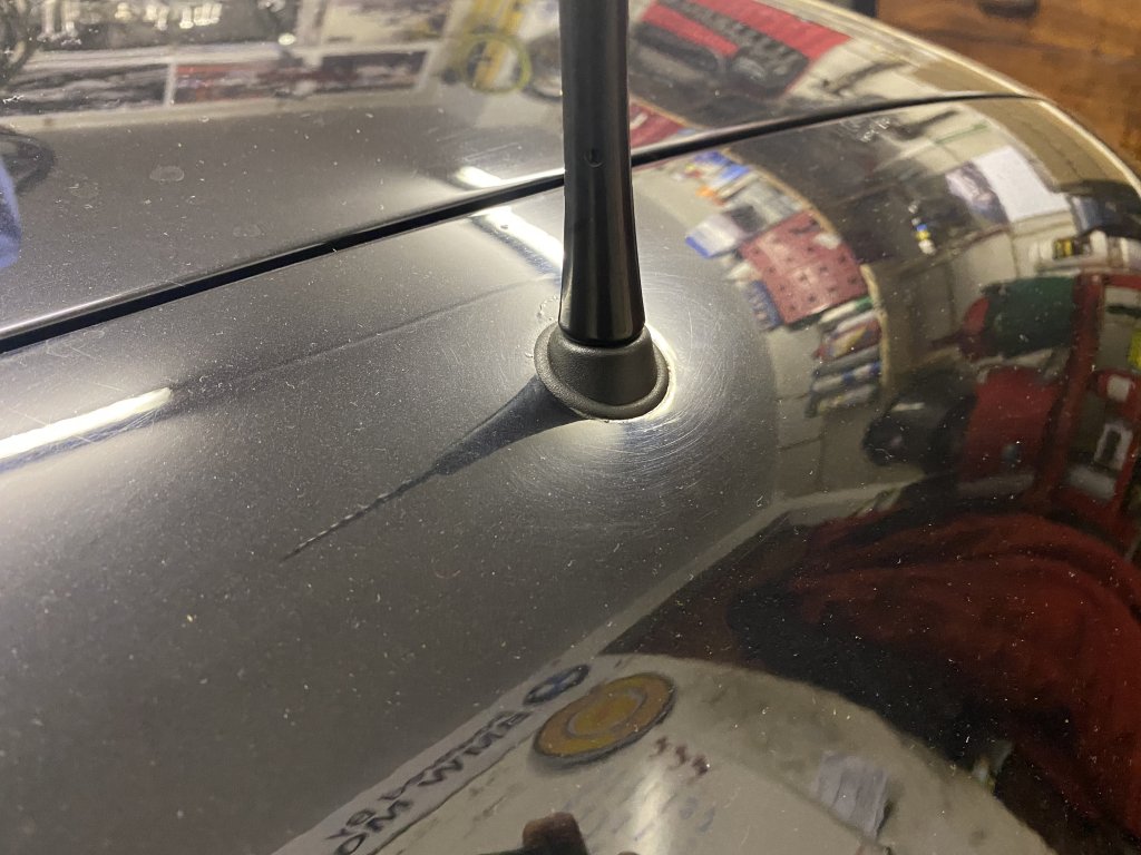

another little job was the aerial grommet now fully working.

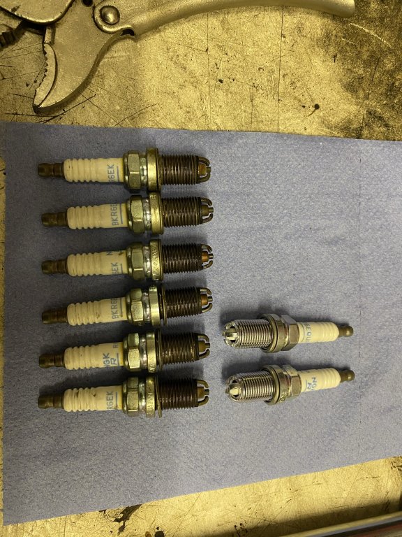

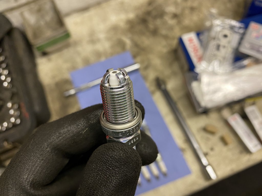

Another request was a full service, James told
me the plugs were 12 years old but had only covered around 10k miles. Old plugs don’t look that bad at all.
Old plug
new plug

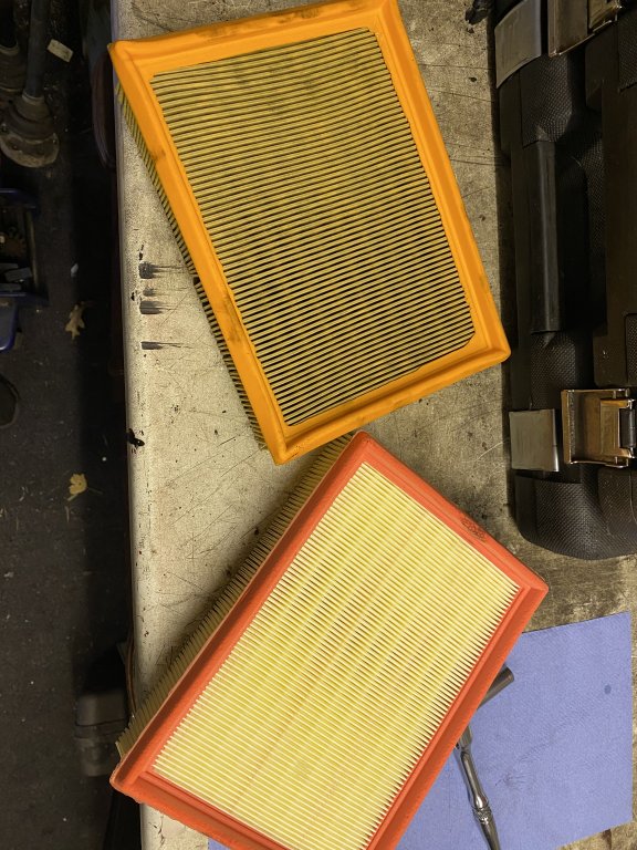

The air filter looked like it’s been in there a fair while

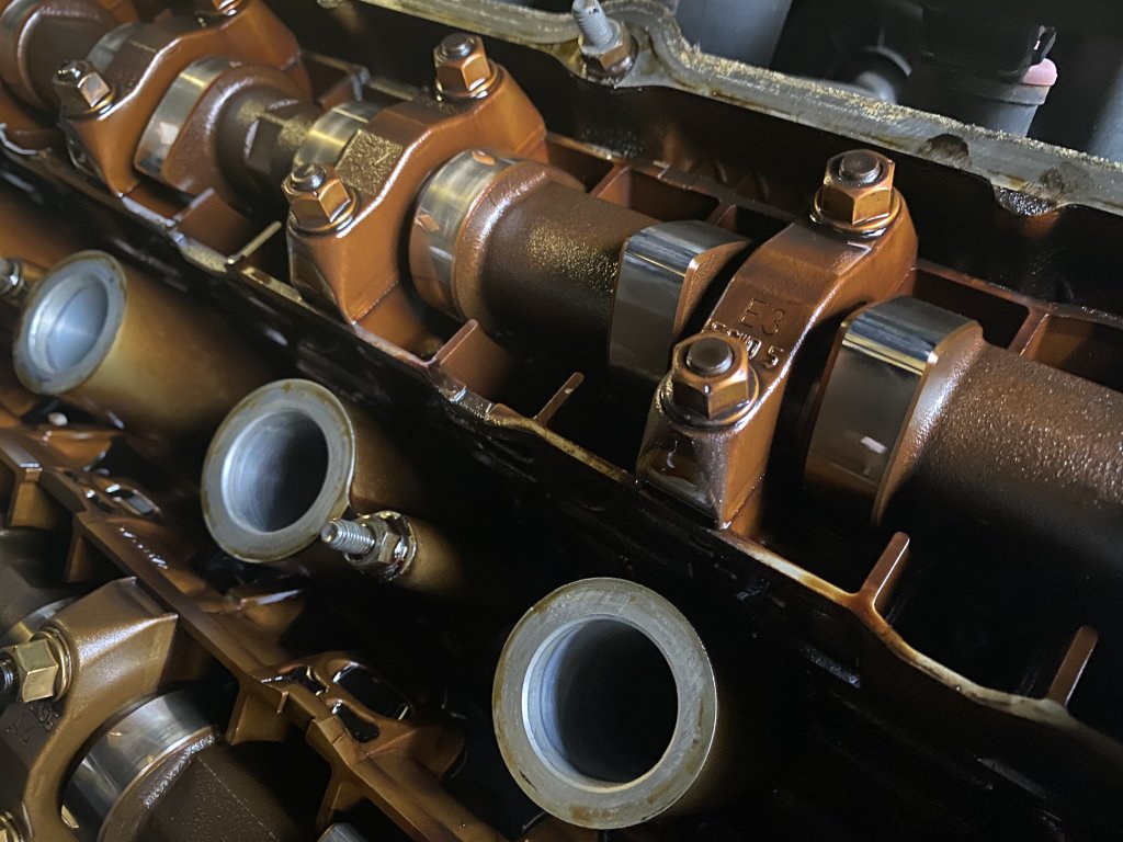

Next was to sort the main oil leak, the rocker cover gasket was starting to weep front and back. Rocker cover off and the old gasket is like a biscuit.
Cams looking all healthy. Everything’s clean.
Inlet lobe

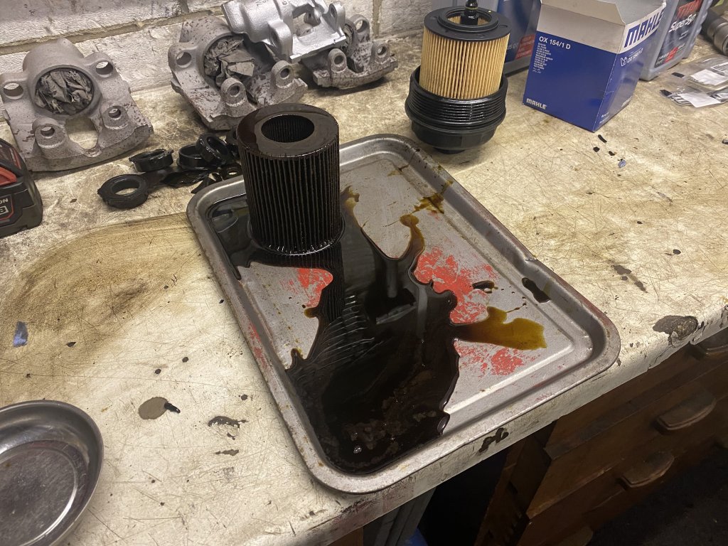

Old oil filter looking healthy.

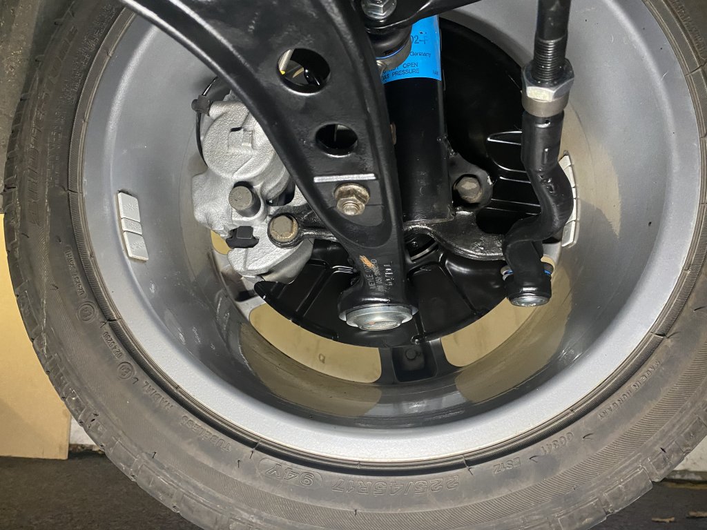

While under the car it looked really cool looking into the wheel from behind.

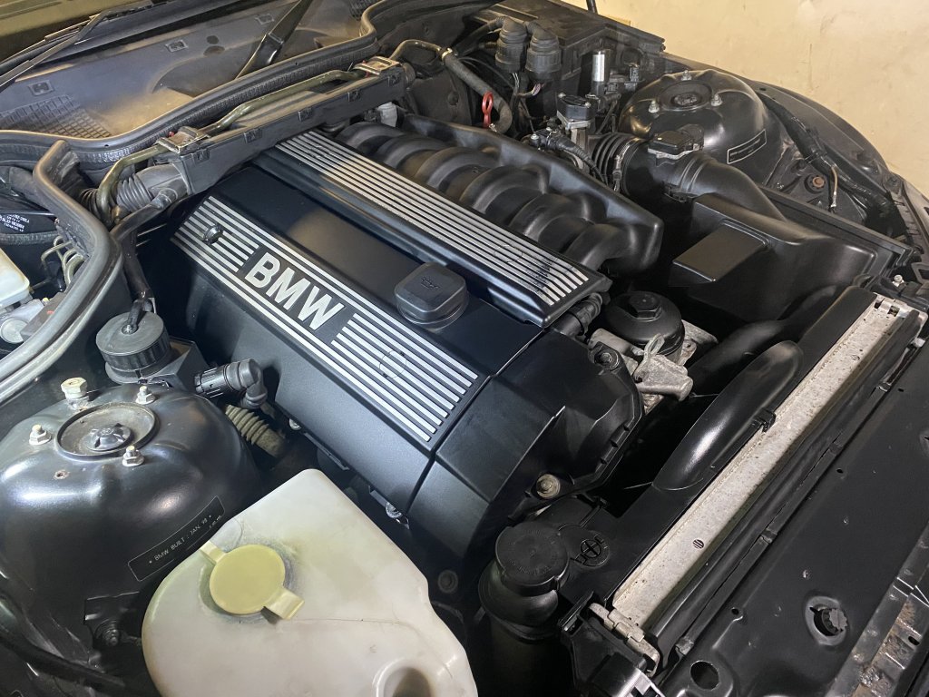

Would be rude not to give the engine bay a little detail.

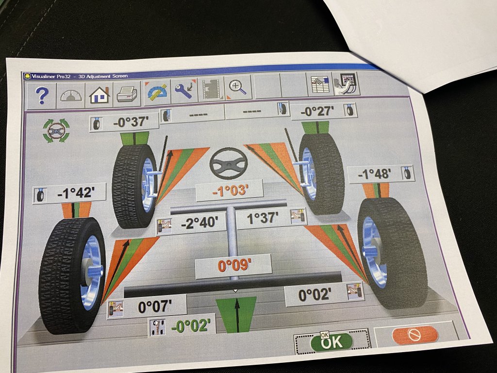

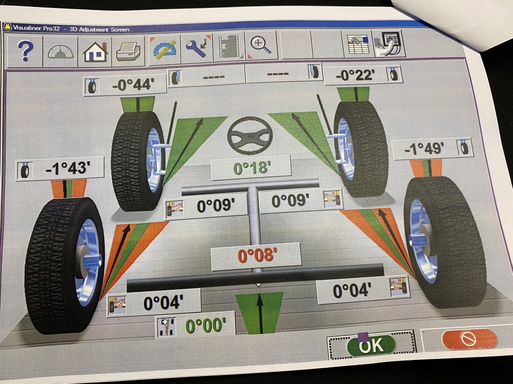

Next I headed down to my local wheel alignment centre.Old alignment will be all over the place due to new bushes and tie rod ends.
Now all in sync. Remember the Z3 rear end is fixed, this shows the rear being identical both sides. That’s a good sign.
