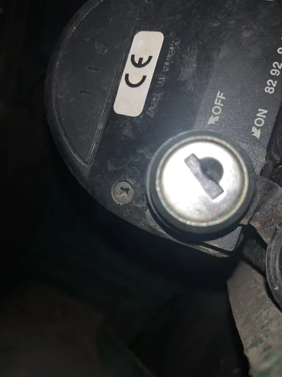

If you look on the lock on the siren it will have a number. I believe that this number should match to that on the key and that would be the key to use.Hi guys

The other reason for this post is regarding the entries above regarding the siren key. I have two and looked at them this evening carefully. They appear to be identical (or perhaps almost identical) and both seem to turn the alarm setting off and on after a little fiddling but, inside one of them is the number 1 and inside the other is the number 2. Can anyone enlighten me on that? Are they keys 1 and 2 for the car and the same or are they slightly different and maybe only both work because one is a little worn? Any thoughts would be appreciated. Have attached 2 photos which may help.
My lock has the number two on it. I couldn't find anyone with a key to be able to test this out.
What I did in the end was found someone on the group that was breaking a Z3 and had the same siren where the lock was in the On position already. When I put that siren in the car then my alarm made noise. I then put the other siren back in as I now know that it all works but I didn't want the siren going off in the middle of the night.
