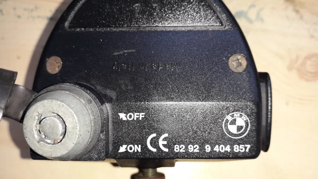

I now have my BMW alarm working, apart from the siren. There is a key on the siren to enable you to turn it off. Mine is in the Off position and I have no key. Does anyone happen to have a key for the siren? The number under the rubber cover is 2 so I presume I need a key with a 2 on it. I know the keys were numbered 1 to 9 (at least).
I would try using a straw from McDonalds but that would mean having to visit a MaccyD (which I try to avoid). Not sure if their straws are now paper as that seems to be the way things are going now. I tried looking at pens but I don't have any that would fit. Any other suggestions?

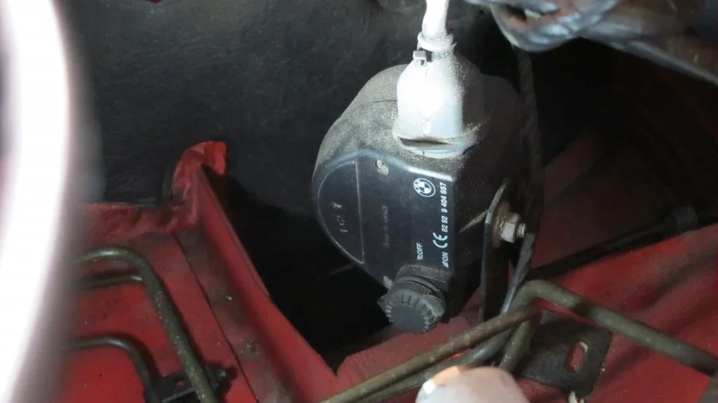

Hmmm.... had a look in the engine bay - cannot locate it...
This is it on pre-facelift - don't know if they moved them later. Right side of engine - under fuse box.2B9E73ED-8E36-4921-9ADE-A85CD60207EB.jpeg

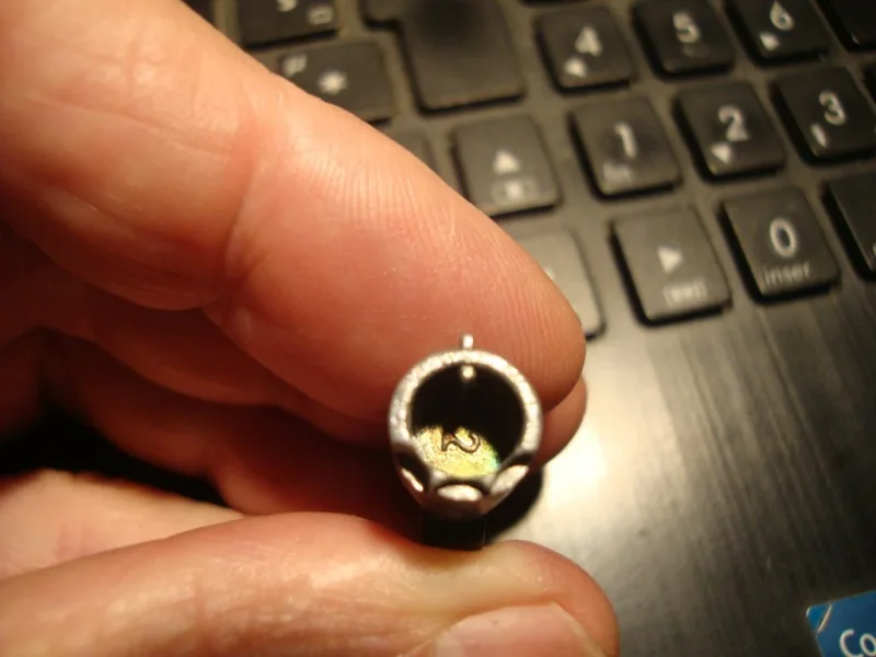

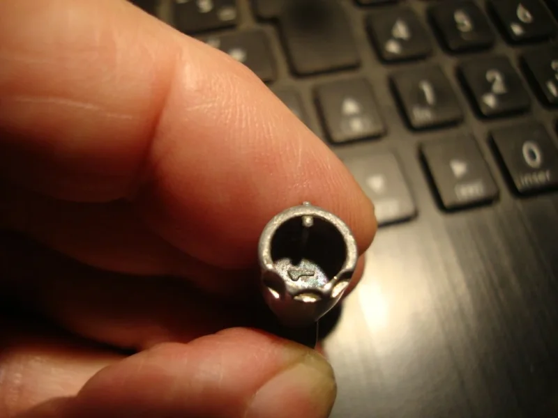

The other reason for this post is regarding the entries above regarding the siren key. I have two and looked at them this evening carefully. They appear to be identical (or perhaps almost identical) and both seem to turn the alarm setting off and on after a little fiddling but, inside one of them is the number 1 and inside the other is the number 2. Can anyone enlighten me on that? Are they keys 1 and 2 for the car and the same or are they slightly different and maybe only both work because one is a little worn? Any thoughts would be appreciated. Have attached 2 photos which may help.
