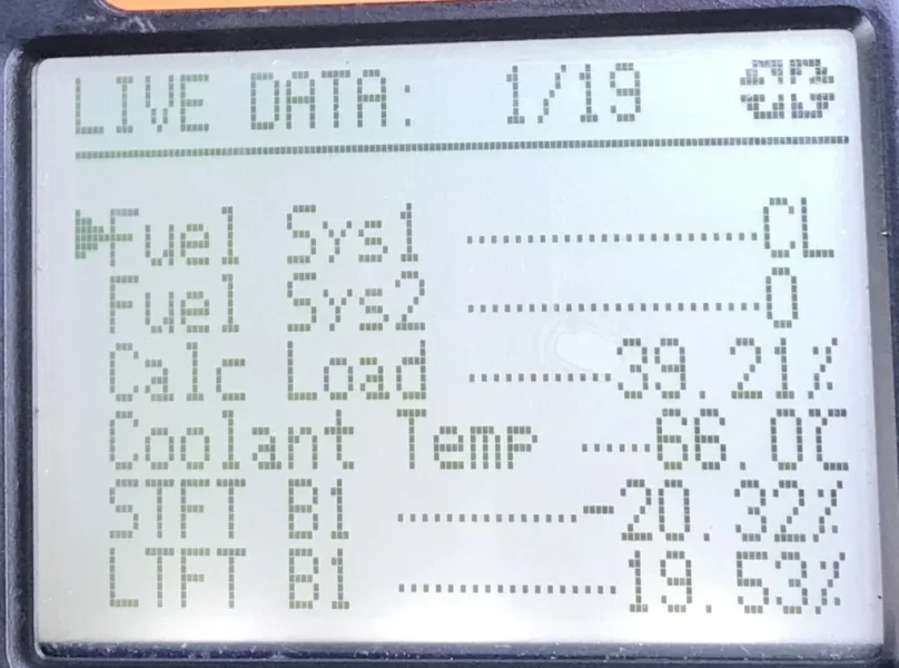

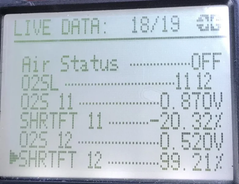

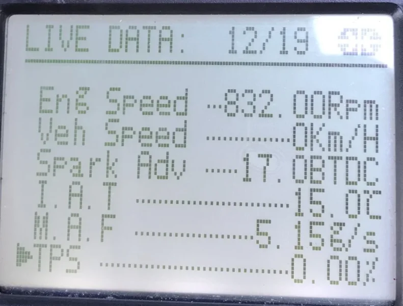

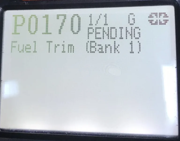

Hi everyone,
I’ve just fitted the Bosch MAF, and my car runs now. But now my car is slightly juddering and it also smelt like rotten eggs for short time.
It’s one thing after the other at the moment.. :(
I’ve attached the live data.

The short term fuel trims are way off.
There's a possibility it needs a run to reset the adaptations (state of tune) but I'd tend to think not.
My money is still on an air leak hiding somewhere. It could be something else of course but that's still my first port of call.
Others may see something else in the diagnostic values I'm missing. Which I have to say is fantastic you are providing these - generally a lot more guessing is involved as it's unusual people have this insight.

Yes I noticed that the fuel trims were way off (I’m learning now haha :D). I’ll take it for a spin later and see if it resets. It’s worth a try I suppose
I’ll have another look for the air leak too.
Regarding the images of the codes that I’m providing, I’m just trying to make it easier for everyone so I can get it sorted!! I’m glad you appreciate it.

Probably an air leak causing the fuel trims to reach their max level to trigger the EML. The -20 on your STFT would indicate its reporting a lean mixture being seen by the O2 sensor, since you put a new Maf in I would suggest you clear the code and reset the adaptions so you start with a level playing field to investigate further if that dosn't clear it. If you can't visually find any leaks best bet will be smoke testing it or trying to spray brake cleaner around the rubber componants on the engine, if the engine picks up when sprayed it will pinpoint the area where it entered the system. Try this from the engine side of the Maf qall the way to the exhaust, include the cam cover joints around the head.
